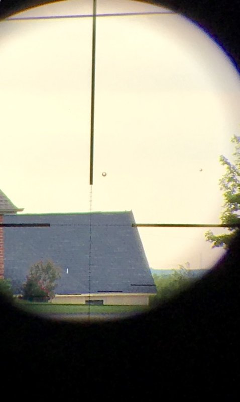

I had one of scopes that had the spatter
on the inside if the lens . Contacted S&B in Virginia and told them my problem. They were very nice and promptly emailed me a shipping label and told me they would get on it once it arrived.
This is what the spatter on my scope looks like.

Mine's at S+B right now getting fixed for the same issue. They were great to deal with on the phone, had a return shipping label immediately. Mine was purchased in May of this year, shot a couple matches with it in warm weather - don't know if there's a correlation there or not. I didn't notice it early on since the spots were at the outer edge of the image and you couldn't see them unless you zoomed out below 10 power.
As I said in the original thread, I have two PMII 5x25s I purchased recently, both identical - DT turrets, H2CMR reticles, milrad, CCW. Scope #1 was purchased last June or July and it immediately replaced a Leupold on a 338 Norma Magnum. It has several hundred rounds on it since then. Scope #2 was purchased just before Christmas, but I had to wait for the smith to finish the rifle and it was finally mounted in March. It has over 500 rounds (maybe closer to 1000) on it since then.
Scope #1 is NOT affected with this issue, but Scope #2 definitely IS. As Sheldon said, it is not apparent until you get down near 10x and below, which is a range I rarely use, so I had no idea the problem was there until I turned the mag down and looked for it.

Talked to both Mark @ S&B USA and Jason @ EuroOptics both gave me the S&B service number. Talked to Brenda and basically told me SB Germany had changed the internal lubrication for the assembly which started causing this to happen internally on their scopes. Since then they switch to another lubricant that doesn't do this. She told me she would remove all of the lubricant and re lubricate with a different type that doesn't do this. S&B should have recalled the scopes assembled with this lubricant so it doesn't even get to the consumers.

Couple hundred rounds in since they first serviced it and the spatter is back. Talked to Jerry at the service center and the first few scopes they fixed they were just cleaning the grease out of the turrets and they had a few come back. They've since switched to a more thorough procedure where they clean everything inside the scope. Apparently that will do the trick and none of those have needed to be serviced again. Fingers crossed.
