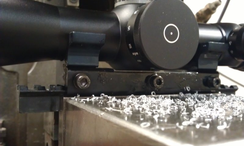

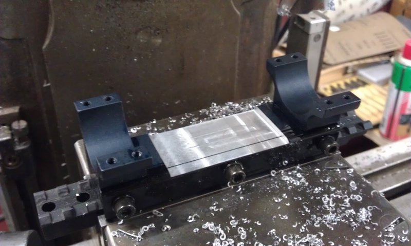

I have taken all the mounts off the gun. There would only be about an 1/8 or inch between the barrel and the bell. The scope is hitting the mount. There is a buldge on the bottom side of the turrets that is hitting the mount it self. The barrel and the bell are fine. I had enough room. It is this Bulge ( no other word for it, if you know of one please let me know.) that is Contacting the mounts.
Doesn't make sense. There is a "flat" on the bottom side of the turrets, not a bulge. Pics are needed.
Seems like the turret housing protrudes a bit on the bottom? Is that what you're talking about?

that is one thing about the one piece mounts. you may have to go higher than what you would with rings cause of the "connector plate" between the two. it is what it is if you want to stay with a one piece mount
