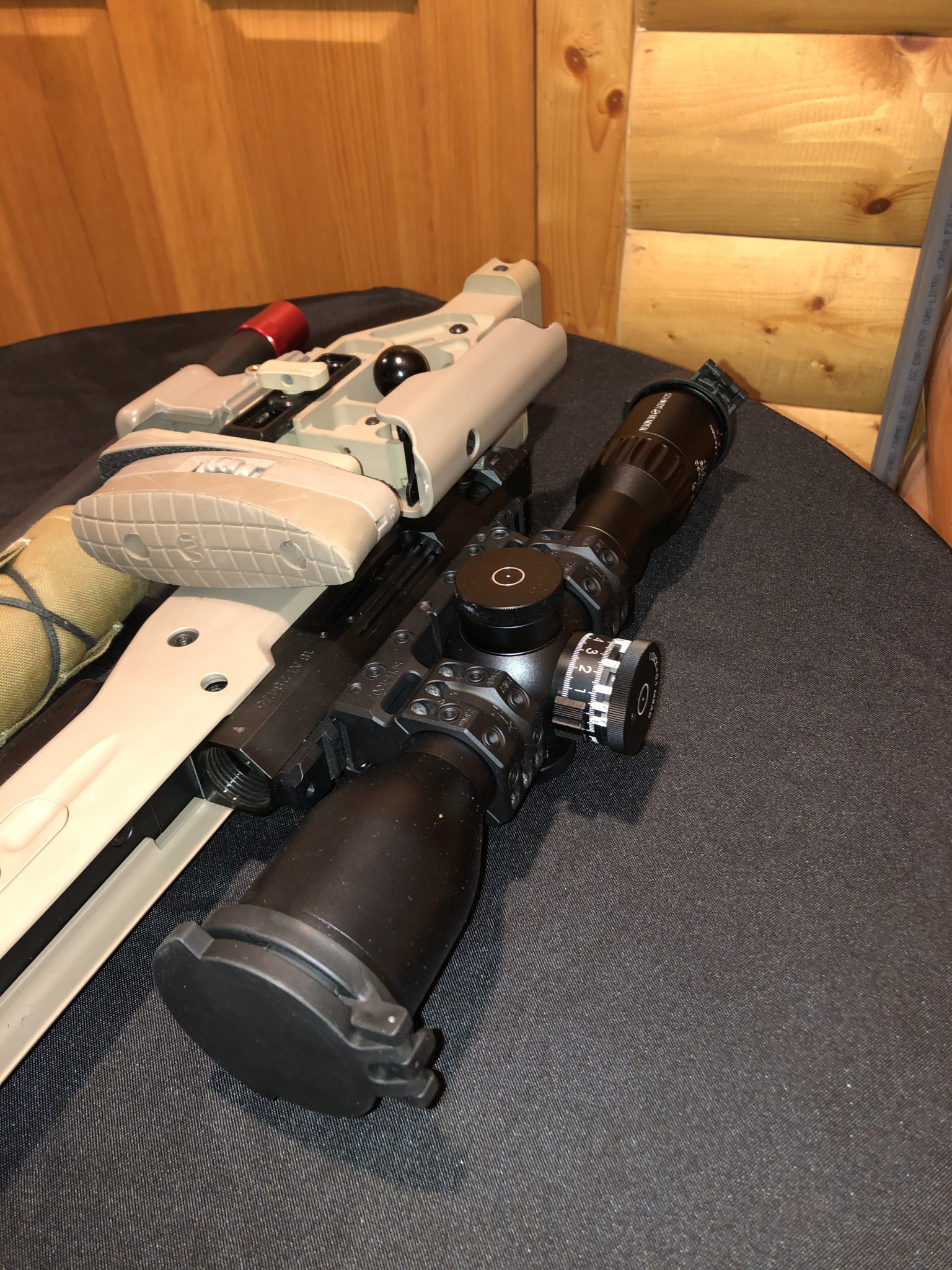

Pretty sweet, I had the Spuhr hunting mount Cerakoted so I know it's mine. :)
Never mind the order of the 1...2...3...indicators, I was just fooling around.

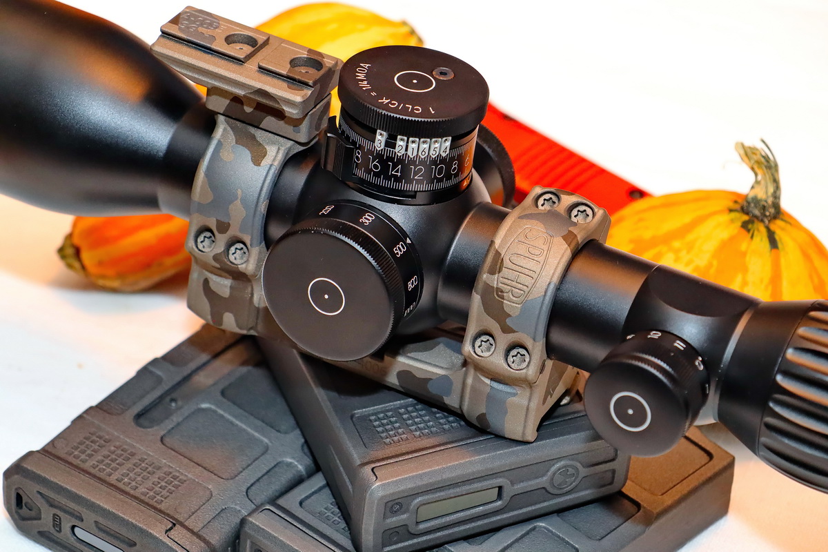

I’ve had mine for about a week, it is the mil version without the indicator. I’ve been thinking about going back to second focal point for awhile now, and this scope hasn’t left me any regrets. I have owned quite a few high end scopes over the years and I’m not afraid to try anything. The problem is once I try a new scope and a find what I perceive as a flaw I have to sell it and essentially move on to the next. After playing with it a week and doing some comps, I literally can’t nick pick one negative thing with the scope. Great magnification range, good eye box ( boarder line great), phenomenal fit and finish, and good but not great Fov. The turrets are the best I’ve ever owned. I’m going shooting this weekend, and I’m curious how I like the reticle. I also own a 3-12 polar, to me the polar has better glass, but this is right behind the polar.
