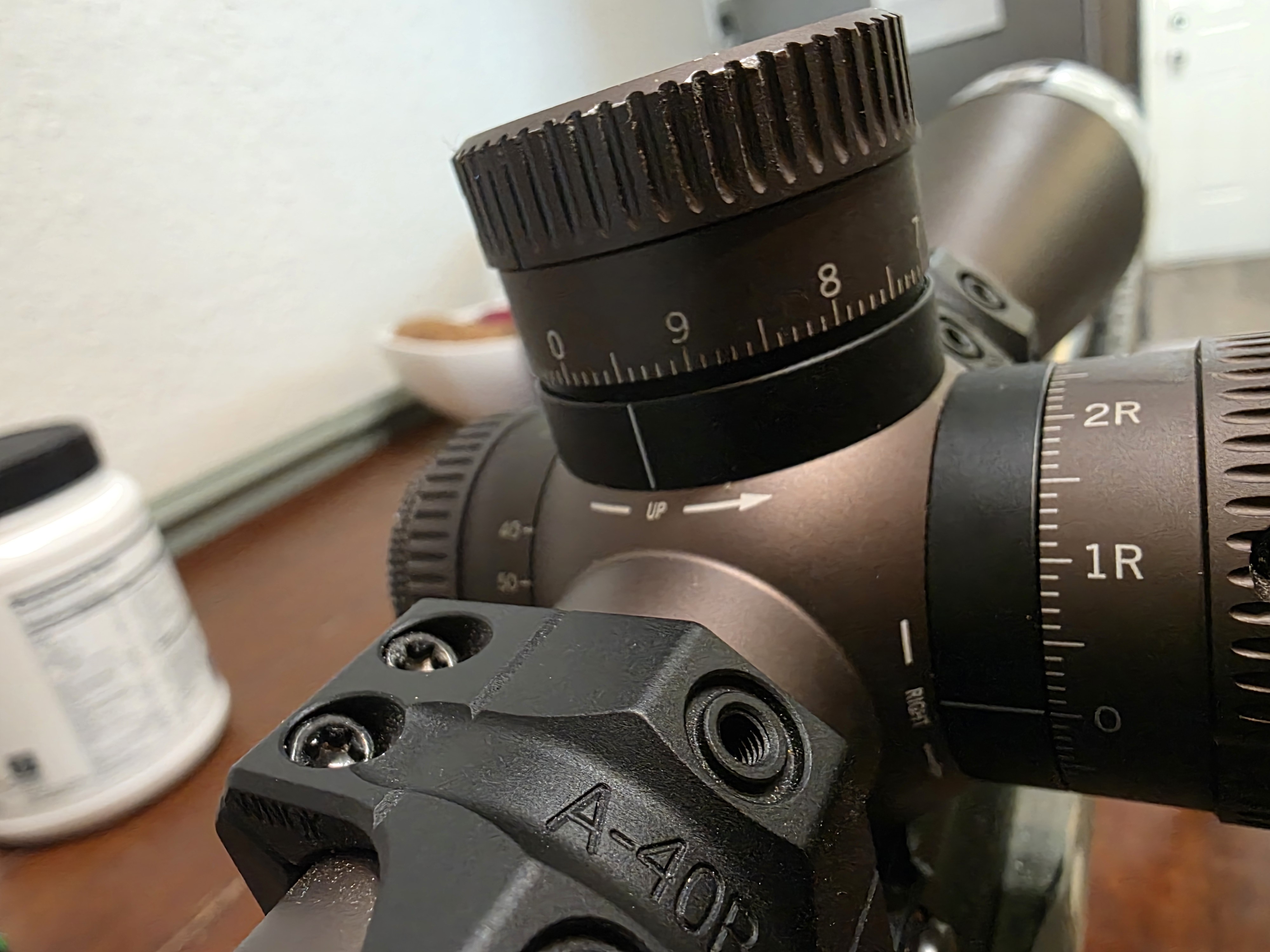

This is the scope 'bottomed out' - I can't tell visually if this is a zero stop in action or not, maybe someone here can.
You are not zeroing correctly. Put the elevation knob at 0 and lock it. Then loosen that little screw sticking out at you on the elevation knob. Then use the tool that came with the scope or a coin to turn the knob on the top to zero and then snug up the screw and zeroed.

It’s not a scope or can issue. It’s a shooter not zeroing correctly issue. He has been instructed on how to zero his scope and it will work fine now.
