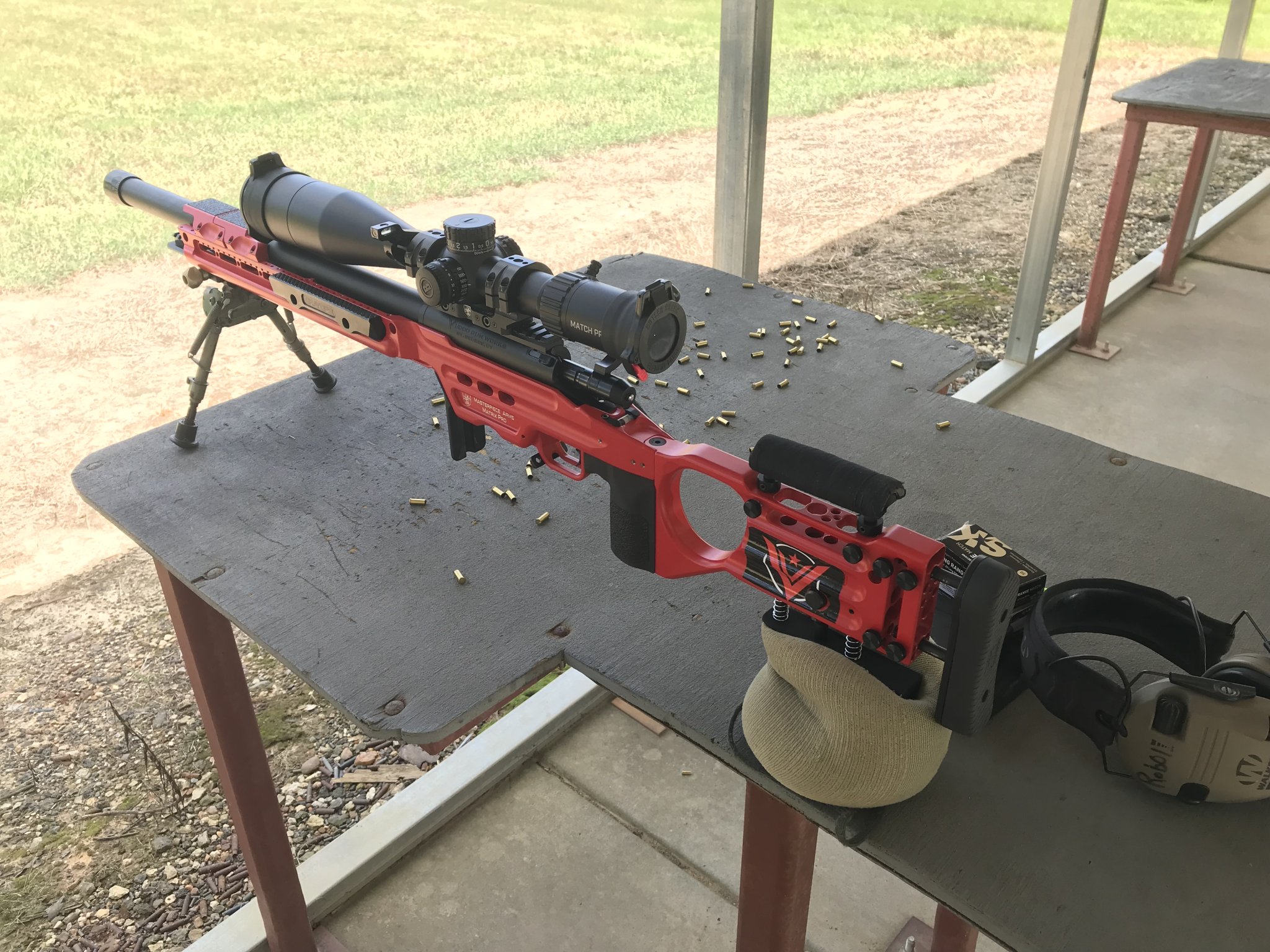

I have a 1 in 13" twist Mullerworks 25" barreled DI Precision Vudoo and I am very happy with it.

I shoot NRL .22. I bought my complete gun pre-built and in stock from ALTUS. I think it's an ACE barrel? I assume they just threw on a complete barreled action on an MPA chassis. It shoots totally lights out with SK Match (which it said in the box it was designed for). Never even tried anything else, and despite what you read online it doesn't seem to matter what lot the ammo is either. A couple of shots to get warmed up and then one hole @ 50yds. It's been running this way for two years now, and I shoot at least one match a month.
I shot my first .22 BR match (not my thing, but I wanted to see how the Vudoo would stack up) with it. There were 17 benches and 18 shooters. I drew 4th, but gave my bench to the old guy who drew 18 and I shot prone. I got 5th place. I would have gotten second by number of Xs, but I dropped one shot out of the 10 ring @ 100yds. This gun is set up for field matches and shot as well or better than most of the fancy BR rigs. I have the ZCO 420 on it, so total cost might be the same as what these guys have in their BR rigs, but there you go.
I will also add that I custom built three .22s before I was frustrated to the FkIt point and bought the Vudoo. I was shooting middle of the pack, and my first match with the gun I got 4th, which is kind of where I'm stuck, because there are some really, really good marksmen who shoot my monthly match. The important thing is that I am confident that when I miss it was me and not the gun. I have never had that with a .22 before and it's completely worth the price of admission.

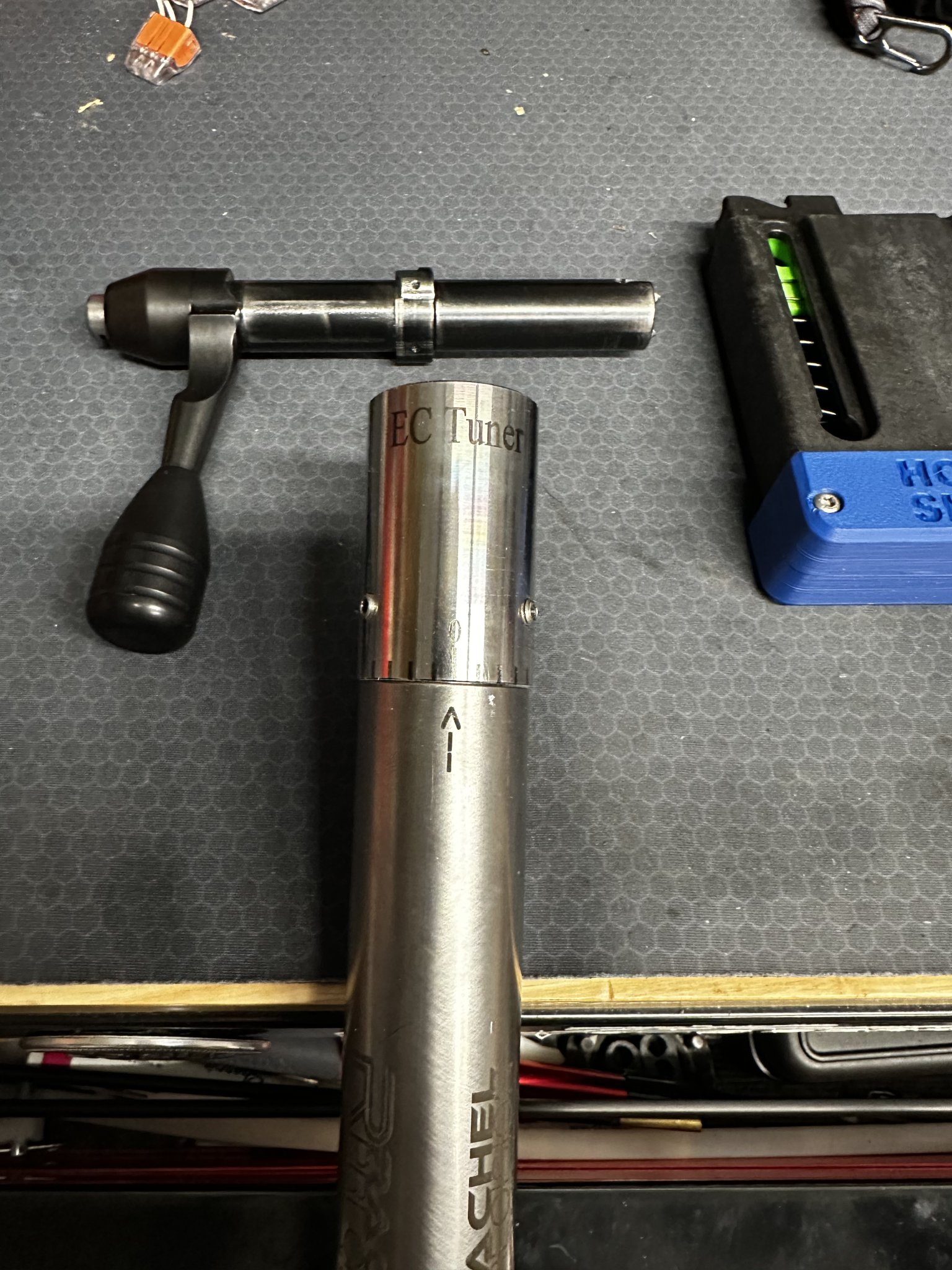

I have an ECtuner, and did the testing, set it, and haven’t touched it either. It probably works, but I’m not going to take it off to find out and change anything. I there’s one thing I’ve learned from my life of shooting it not to meddle with success. If it shots straight do that and don’t change anything.

I recently did my own tuner test. I think it was a total of 78 five shot groups. Average 5rd group size was .31. I don’t remember what the average 30rd group size was. With a random lot of center x. I was happy with that. As for the test, I picked the best and worst settings and re-shot them. They flipped…. Also ran a p test on the data and no difference was found.
