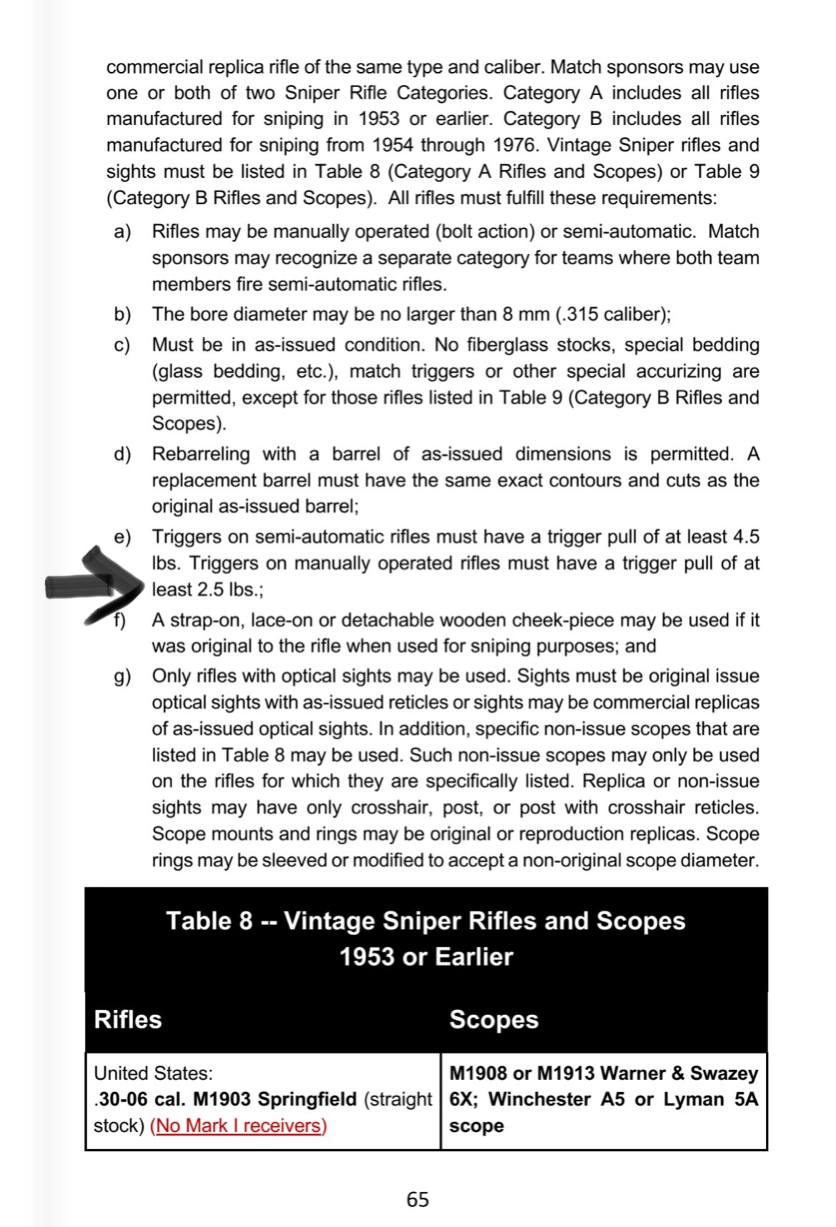

CMP vintage sniper rules re bolt-action rifles. You can use whatever m700 trigger you want, as long as at least 2.5 lbs.

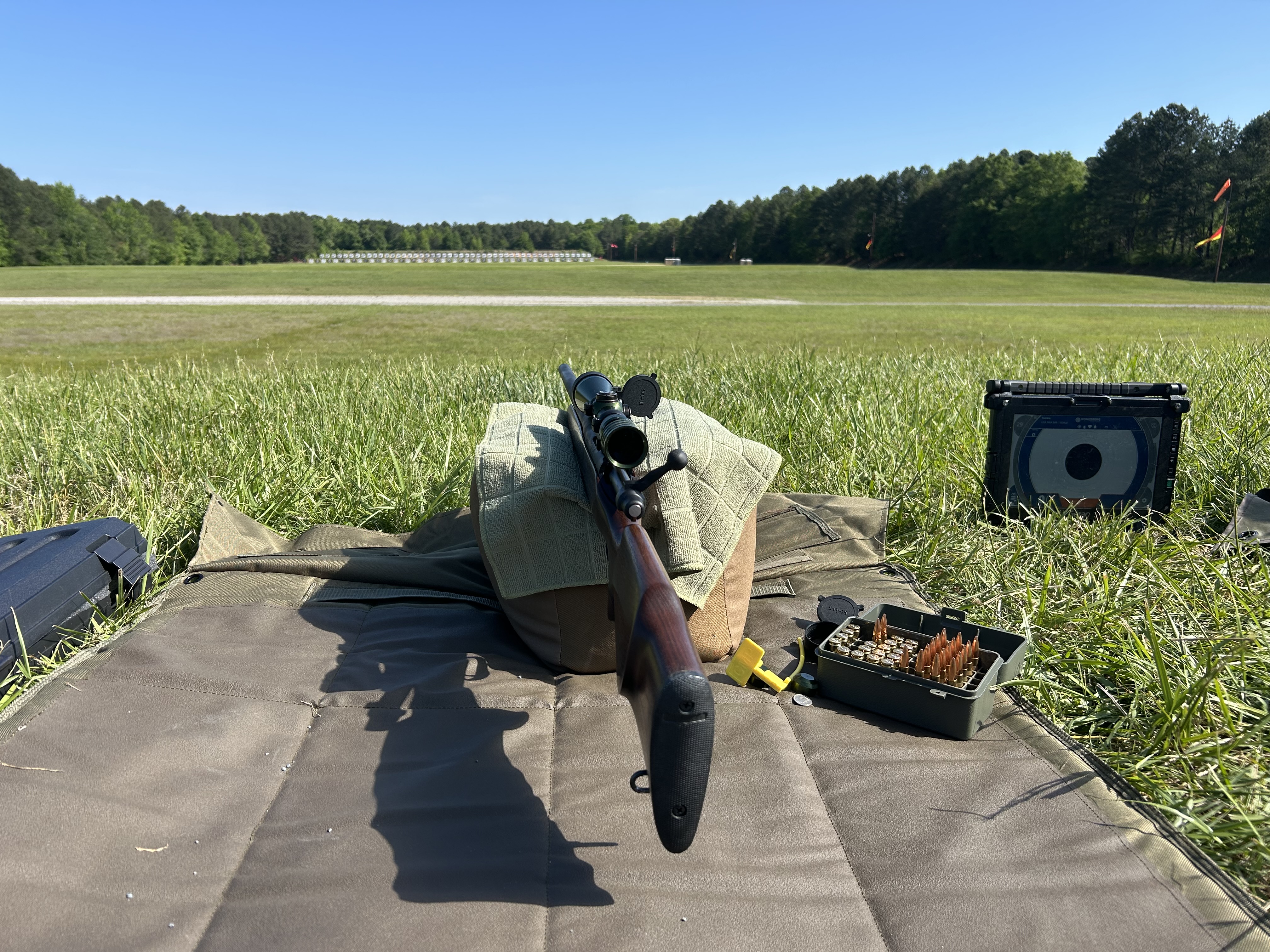

Mine is a little over 3.5 lbs, so it’s something I need to work on before the next event:
