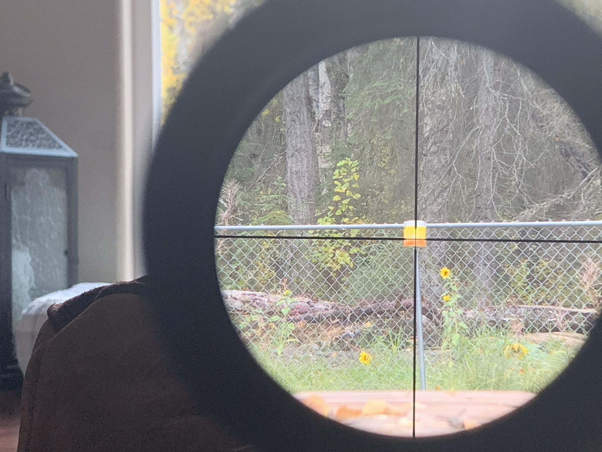

Get something the size of a gallon paint can, preferably bright color, hang it at about 30yds, through a window and you can stay inside.
Pull the upper, remove the bcg. Brace the upper well and visually look down the bore and line up the the bore as perfectly as you can looking at the object at 30yds.
Dont move the upper.
Look through the scope and then dial the reticle to the center of the object you hung. I like to favor just below center of the object with the crosshairs.
Revisual check down the bore and the crosshairs as needed.
Take to the range.
Do it well enough and you’ll be on paper at 100.

Shootnwrench,
Your idea worked just fine from 50 yards. First shot at 100 yards required both windage and elevation change, but zero’d just fine. I was way too close in a 20’ room. This is my first Mil-Dot scope, so after the zero, I dropped down one mil and aiming at the X, fired one round. Then dropped one more mil and fired one shot. First shot was approximately 3.5” from the X, and second shot was approximately 7” from the X. I assume that this result is desired and normal. I took shots at the 200 yard plates using the first Mil-Dot below the crosshairs, scored a hit. Took a shot at the 325 yard plate using the second Mil-Dot and scored a hit. No such luck with the 400 yard plate:unsure:
This former service rifle shooter has a lot to learn about mils and ranging, but it is a fun endeavor. I am thinking that I may find a Labradar useful for determining the trajectory of my load. I found out that my old Compass Lake 7-twist barrel would put 4 rounds into a ragged 1/2” hole, with my yanked 5th shot keeping the group at 3/4”. My misses are my fault only.
