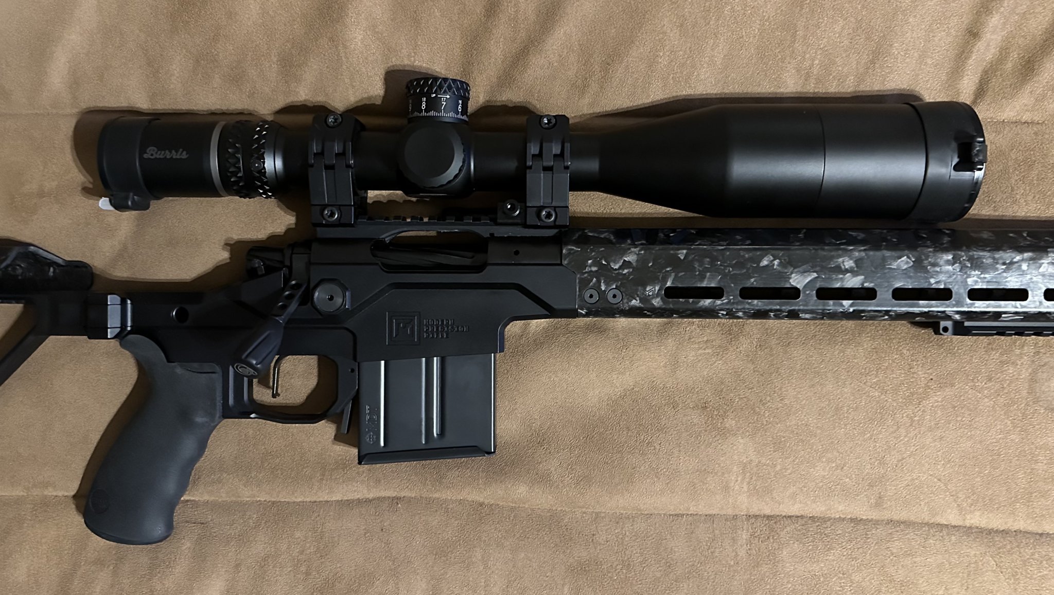

But if you decide you don't want to spend that much, I will also give a vote for the Burris XTR-III 3.3-18x50 with the SCR 2 MIL reticle. I have one of the 5.5-30x56 models with the SCR 2 reticle. Solid optic for the price.

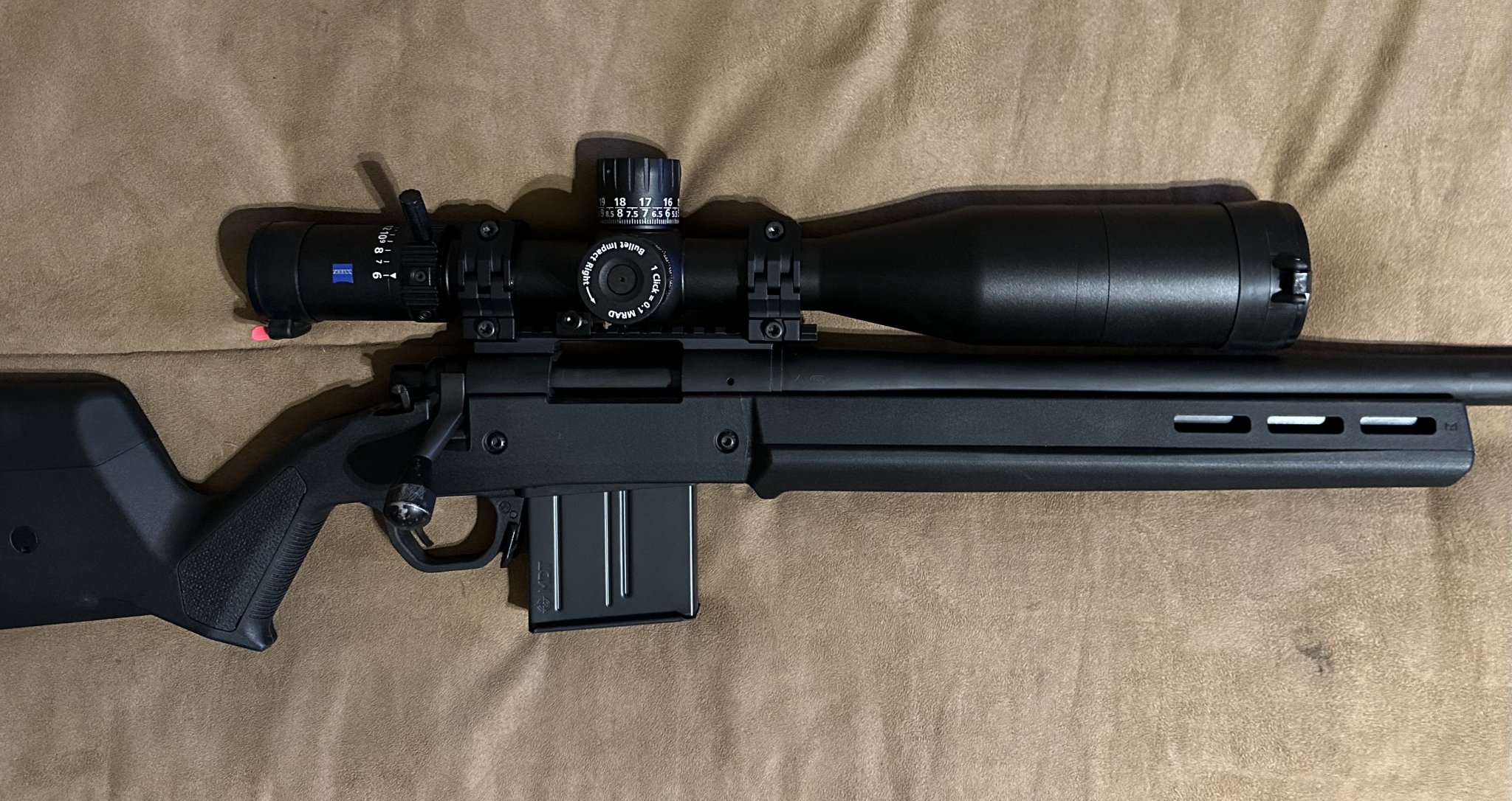

For something in-between those 2 (price wise) the Zeiss LRP S3 4-25x50 Z-MRi is a REALLY nice scope. I have one in the 6-36x56 flavor. Another excellent option. 👍🏼

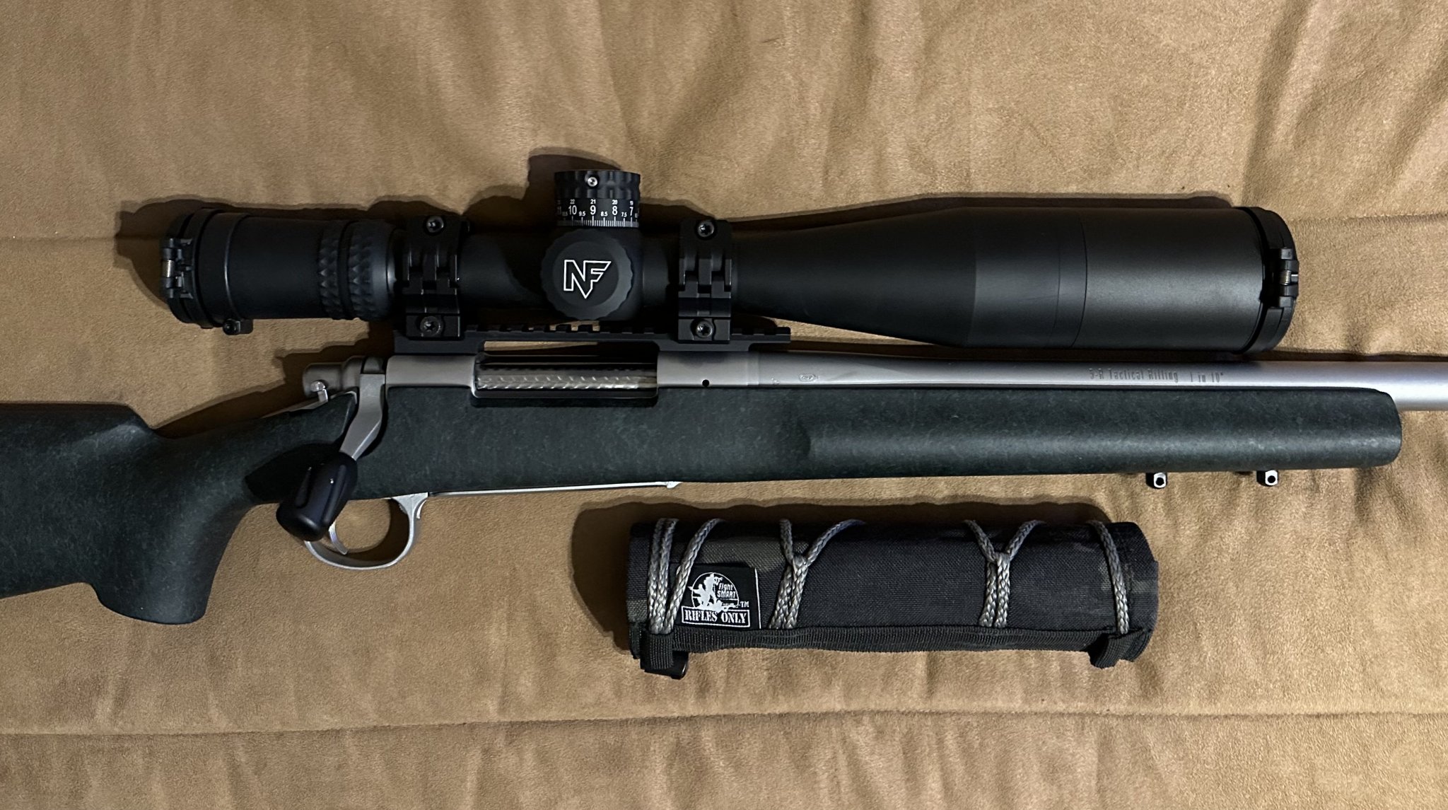

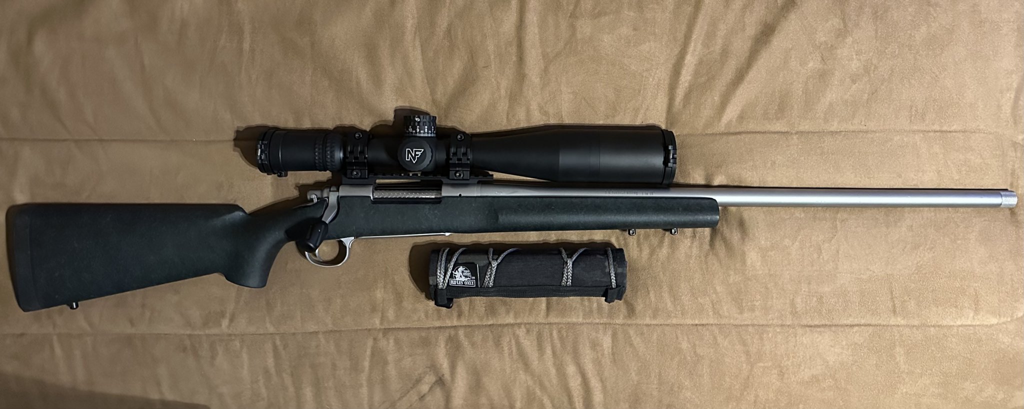

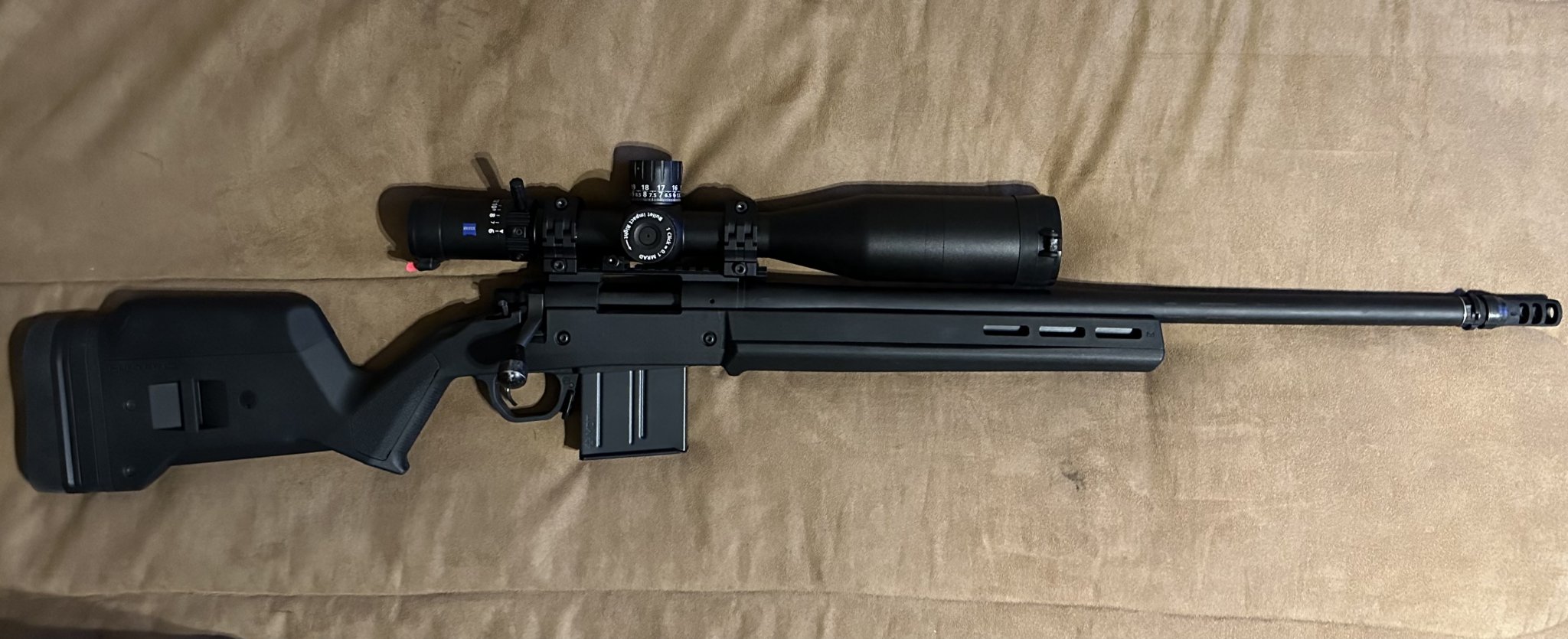

Also, as to why I don’t recommend the NF for hunting…I might have some experience with them, as well…
Recent production ATACR F1 5-25x56 MIL-XT. The glass is surprisingly unimpressive. Everything else is amazing about the scope, but the glass is sub-optimal for the price.
