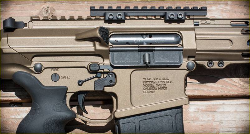

Let's use the flat top upper receiver as our point of reference here. The axis of the iron sights on an M-4 have a height above the flat top upper receiver of 1.4". It's not surprising, therefore, that most scope mounts have an axial height in the 1.4" - 1.5" range. The good news here is a 1.5" high mount will allow for a 56mm objective scope - plus lens cover.

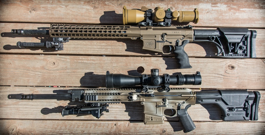

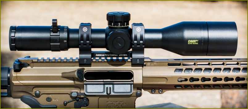

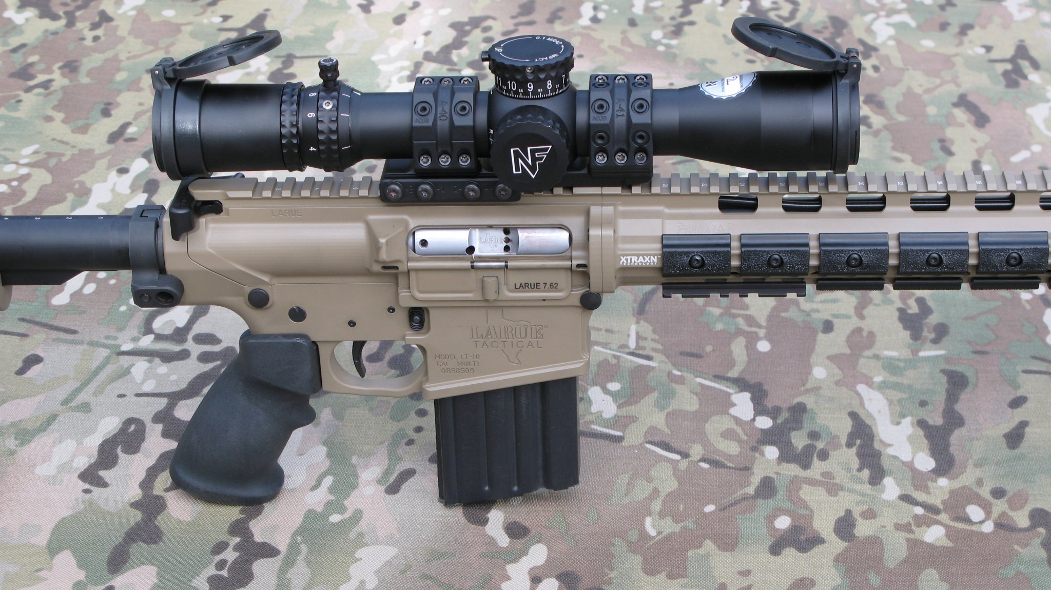

Here's a shot of a small block gasser in 5.56, with a LaRue mount 1.5" high:
Here's a big block gas gun in 6.5 CM with a Spuhr SP-4016 mount, 1.5" high:

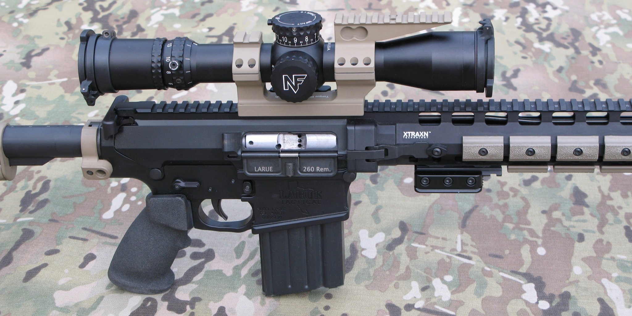

Another SR-25 pattern rifle in .260 Rem, with a LaRue LT845 mount, 1.535" high:
