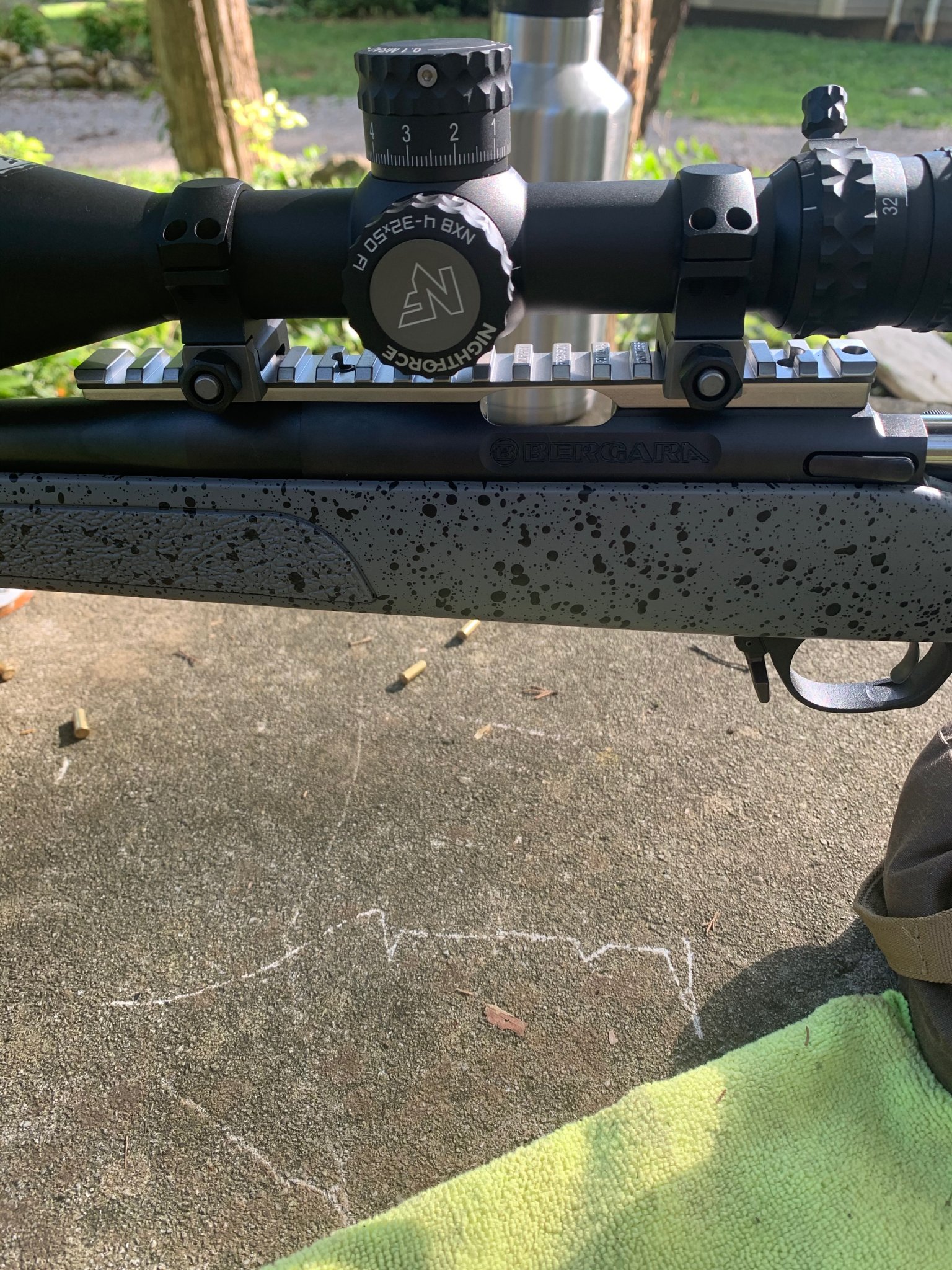

Get in touch with Cameron Murphy, Murphy Precision, this is a 8" long 30MOA stainless steel work of art expressly for a Bergera B14r.
Can't say what it will take with your scope.
I've shot two B14r's set up exactly like this one, zeroed at 50 yards out to 400 yards, Nightforce NX8 4X32 MilC

@Criver600 was the 30MOA from him a custom job? I only see 0, 10, and 20 MOA on his website for the B14-R
Also what height NF rings are those?
Looking to replicate this setup with a 50MOA rail and NXS 3.5-15x50 scope
