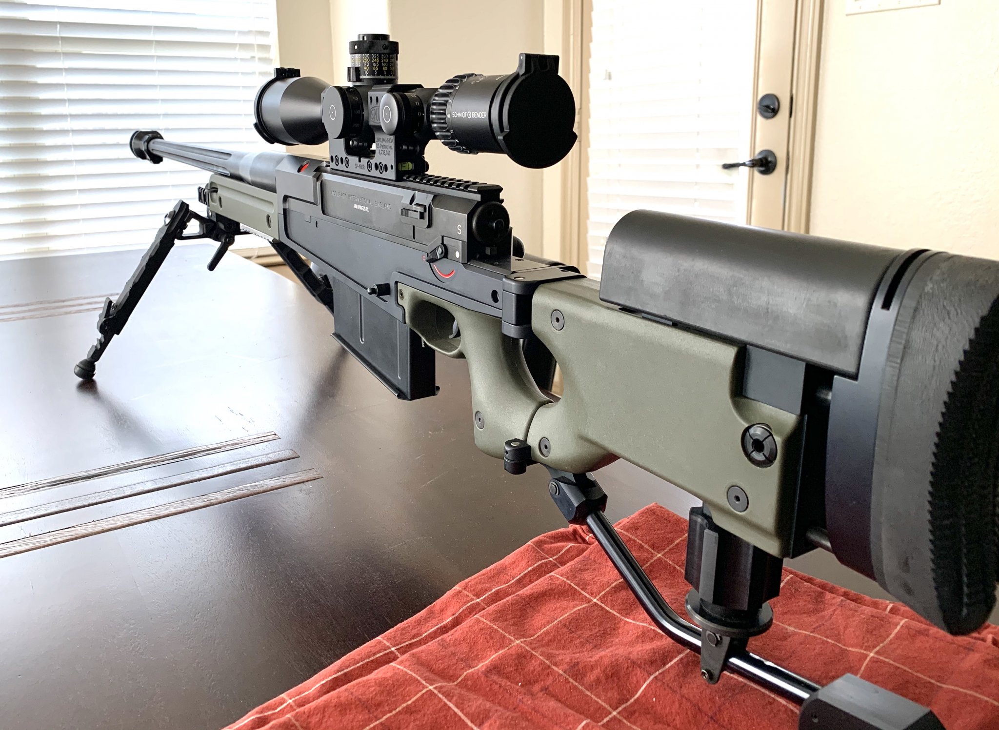

With a Steyr HS 50-M1 scope options.
I am interested in a scope that can take the recoil from the fifty.
I am not looking for a scope, to squeeze precision out of the fifty round.
What about this unusual scope - the Trijicon ACOG fixed 6x with the .50BMG reticle. On the top rail mount a Aimpoint T1 with a 4moa dot.
Other considerations:
Schmidt Bender 3-12x54 PM II P4F
Kahles K318i
Please let me know your thoughts. Thanks for looking.

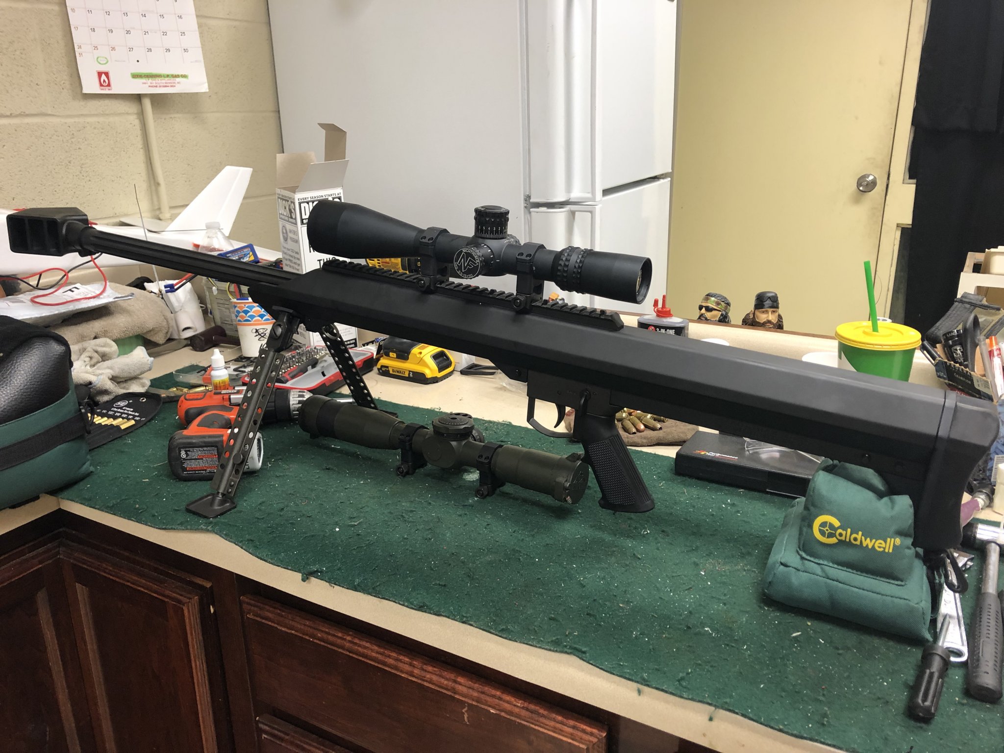

Just slap some MagPul BUIS on there....according to some Internet posters....you just need to get close with the 50 and the shockwave will rip their head off....so I don't see the point in putting expensive optics on it... /sarcasm

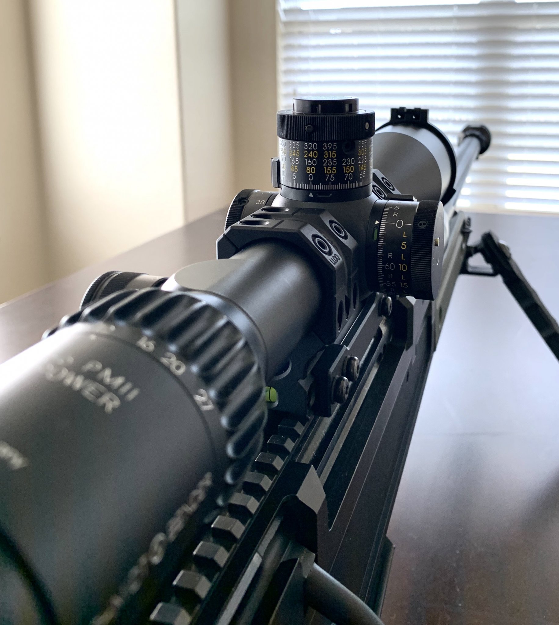

I can borrow a S&B 5-25 PM II MSR from another rig and determine if I like it. Another possibility to 'consider' is the Trijicon MGRS. The Steyr has an adjustable cheek rest that has a lot of range. That red-dot is probably the Cat's meow for mid range. It comes with an optional 3x magnifier. With the average Joe the fifty is not a precision rig. At least when comparing it to the other smaller modern options.

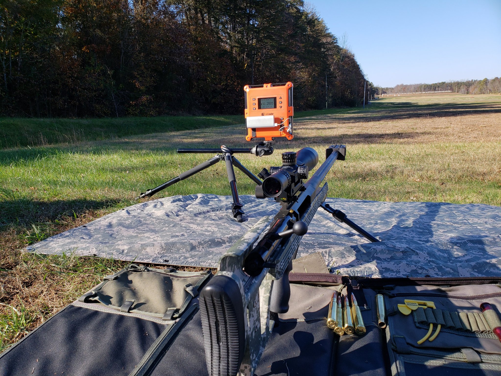

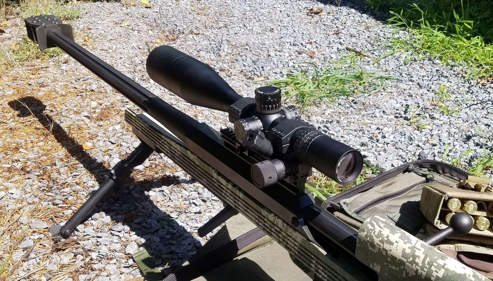

You are correct if the average Joe is shooting surplus ball ammo but careful reloading will increase precision. I have been running a NF NXS 8-32x56 with an Ivey adjustable base for three years and over 1000 rounds of high pressure loads with great results and no equipment failures.
