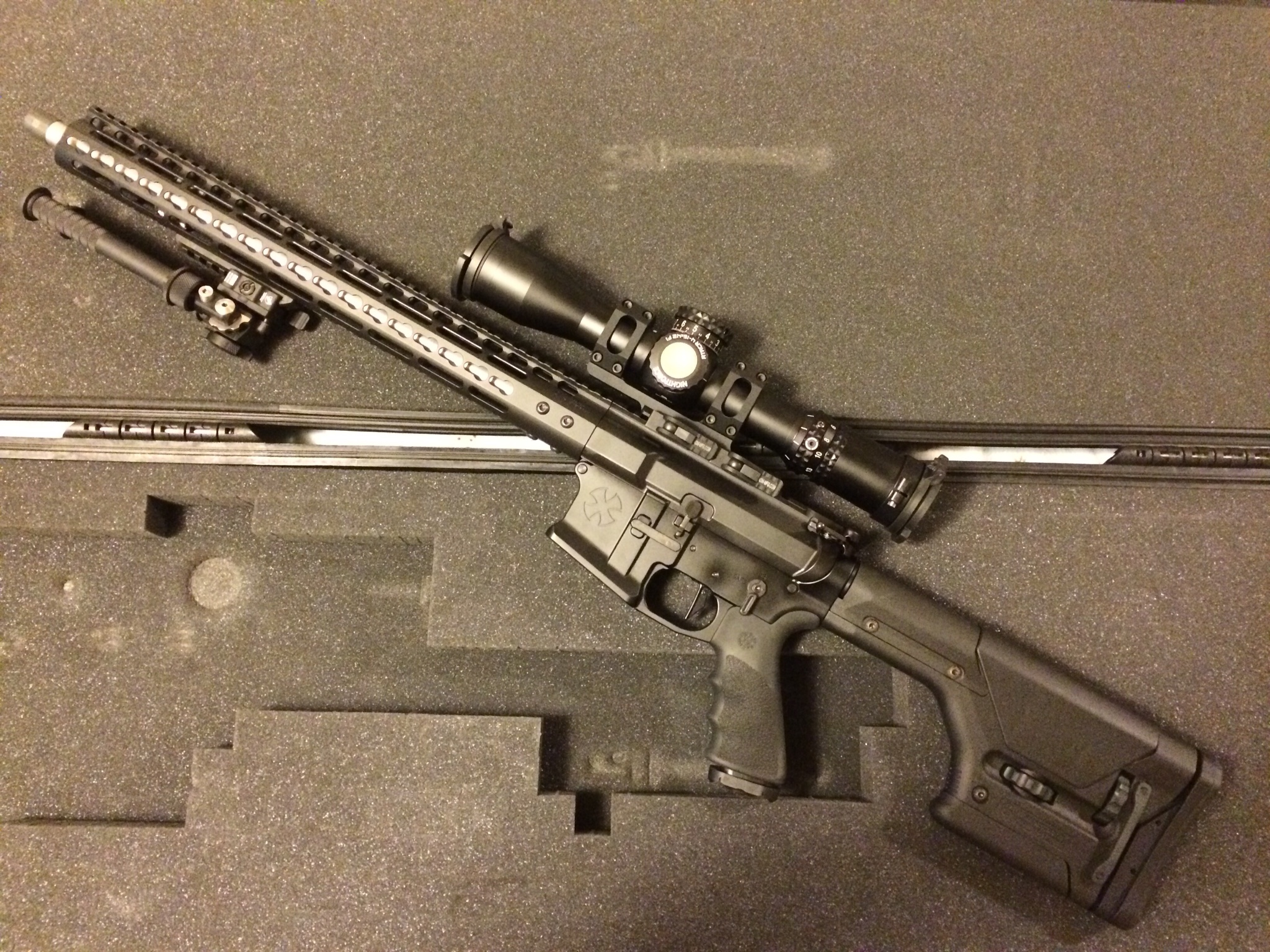

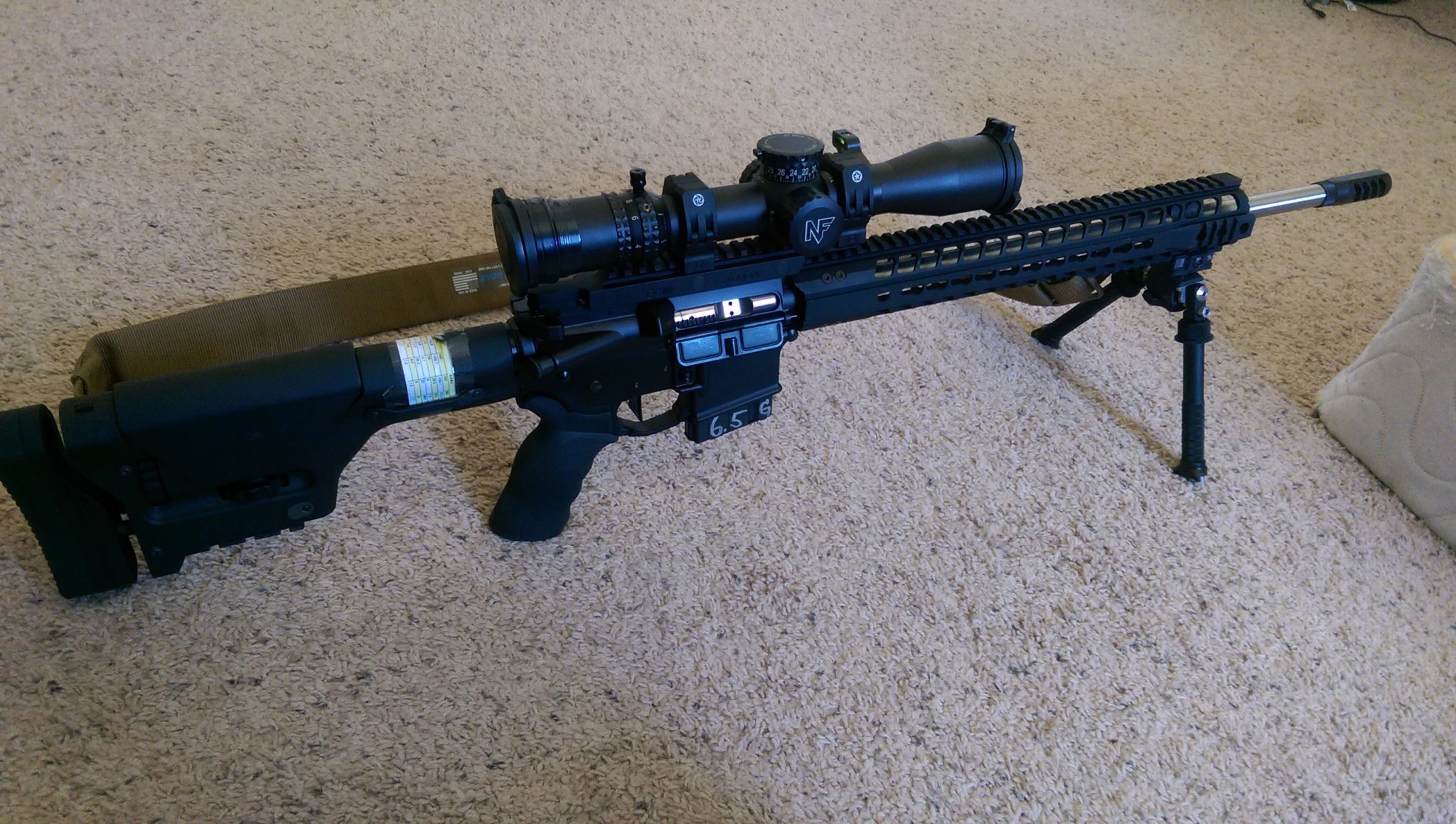

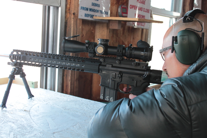

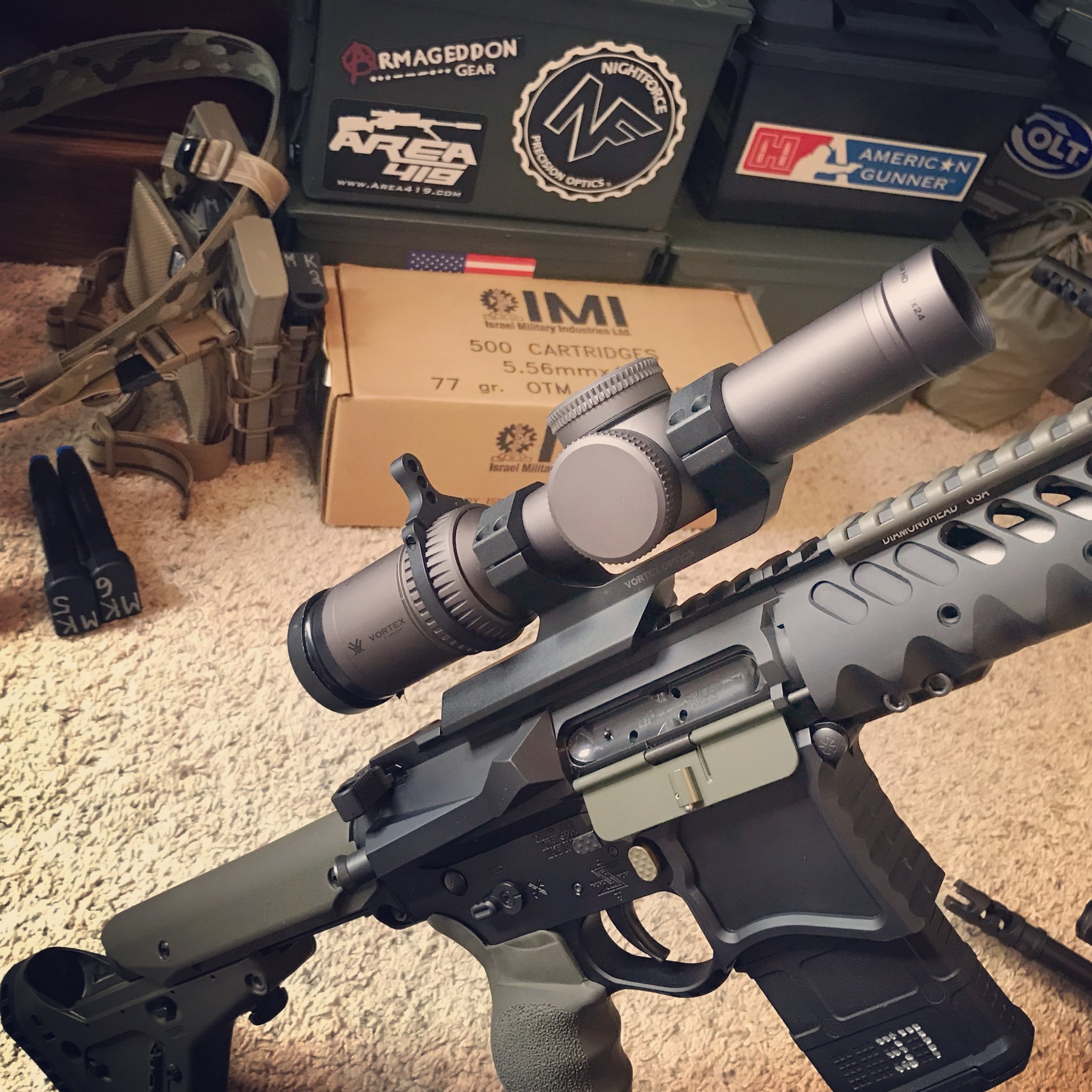

I had a 4-16 F1 NF Atacr that I ran on an AR15 platform (6.5 Grendel). I don’t think it’s too much scope for an AR especially if you’re trying to reach out to further distances. For me, I always like having the extra top end magnification. On my SPR build that I got from a fellow Hide member, he was running a 4-16 NF in a cantilevered Spuhr mount. Some people may think it looks a little off/funny running a 34mm tube scope on an AR, but so what... it’s purely cosmetic. Now, on that same SPR rifle (223 wylde AR), I run a 1-6 LPVO Gen2 Razor. I like it for matches and closer in/fast shooting, but am eventually going to snag a 3-15 T5XI for it. Yes, it’ll hit 600+ yds now with the 1-6, but it would be a bit easier for me to really tighten those groups up if I had some extra magnification. Anyways, here’s some pics for reference...

Reactions: BA226 and Joeyg023

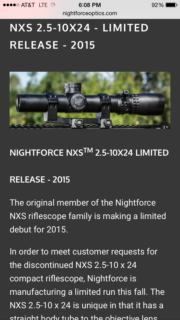

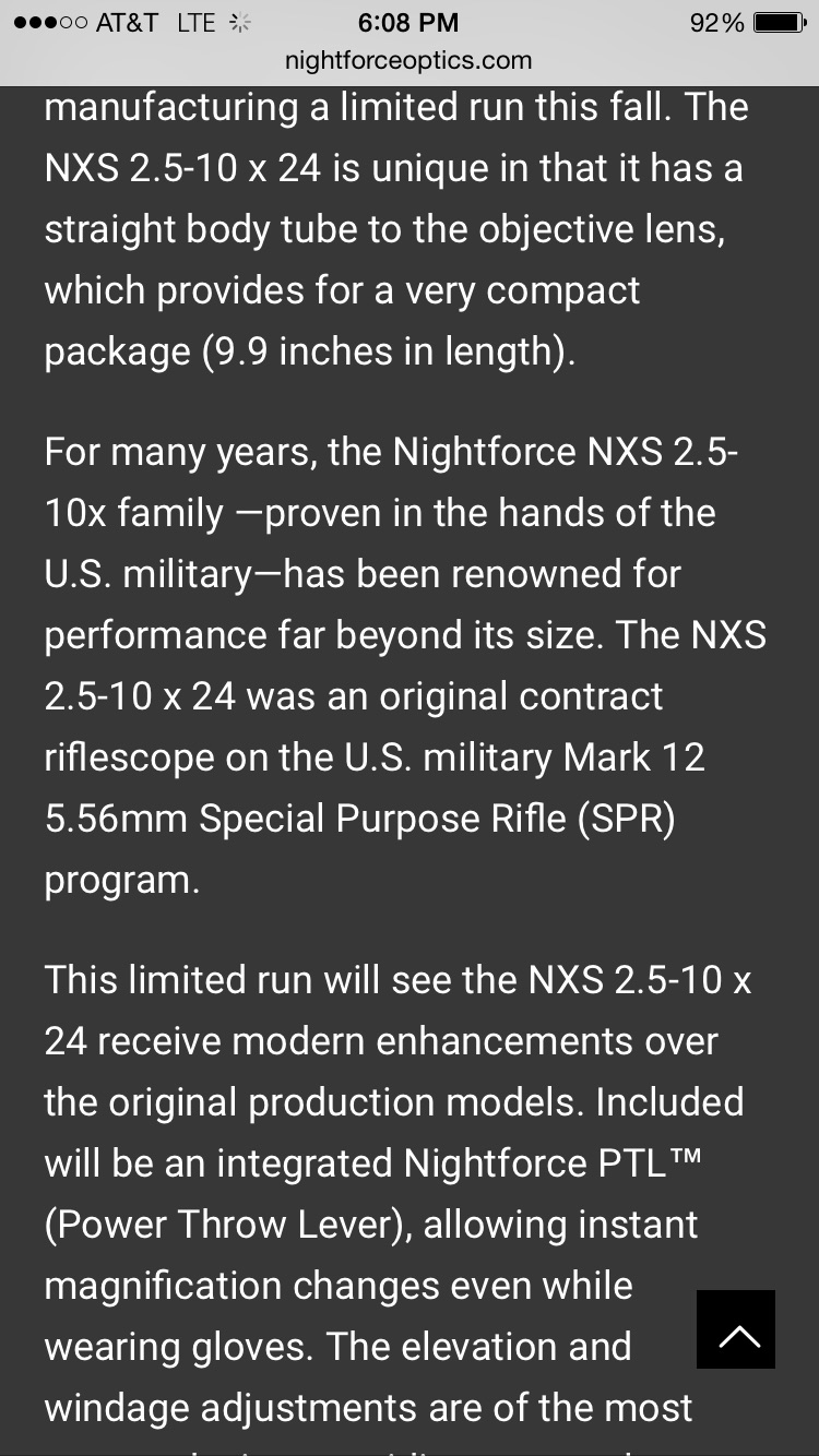

So my dealer i use for scopes has a Nightforce 2.5-10x24 and he thinks that would work good for what i want to do. Only draw back is it’s 2nd focal plane. He said it’s been discontinued, but he has 1 left still sealed in the box.
It all depends on what you want to do - and the answer will vary from person to person. I'm in the process of building a Mk12'ish clone and plan to go with the ATACR 4-16x42. I have a DMR rig that I use for PRS and it has a NF 3.5-15 F1 (I agree with you on the preference for first focal). For PRS I almost never have my magnification higher than 15x because it's easier for me for target acquisition - so that optic works on that rig... for me. But, if I'm shooting steel or paper prone or from a bench, I usually like a higher magnification. My eyesight has also gotten worse over the years - so I sometimes like to turn it up. If you need something compact and don't mind the 2nd focal, the 2.5-10x24 could be a good choice. But if you can spare the weight and size, the 2.5-10x32 is a better option - or go with the ATACR 4-16 and get an F1 (don't let your dealer reel you in by enticing you to buy a discontinued scope that he most likely just wants to get rid of).
As far as an extended mount, it all depends on what you're using it for and the eye relief needed. In general I have to use an extended mount on all of my ARs that aren't running holo sights.
That would be a good MK12 clone scope. I wouldn't use it myself.

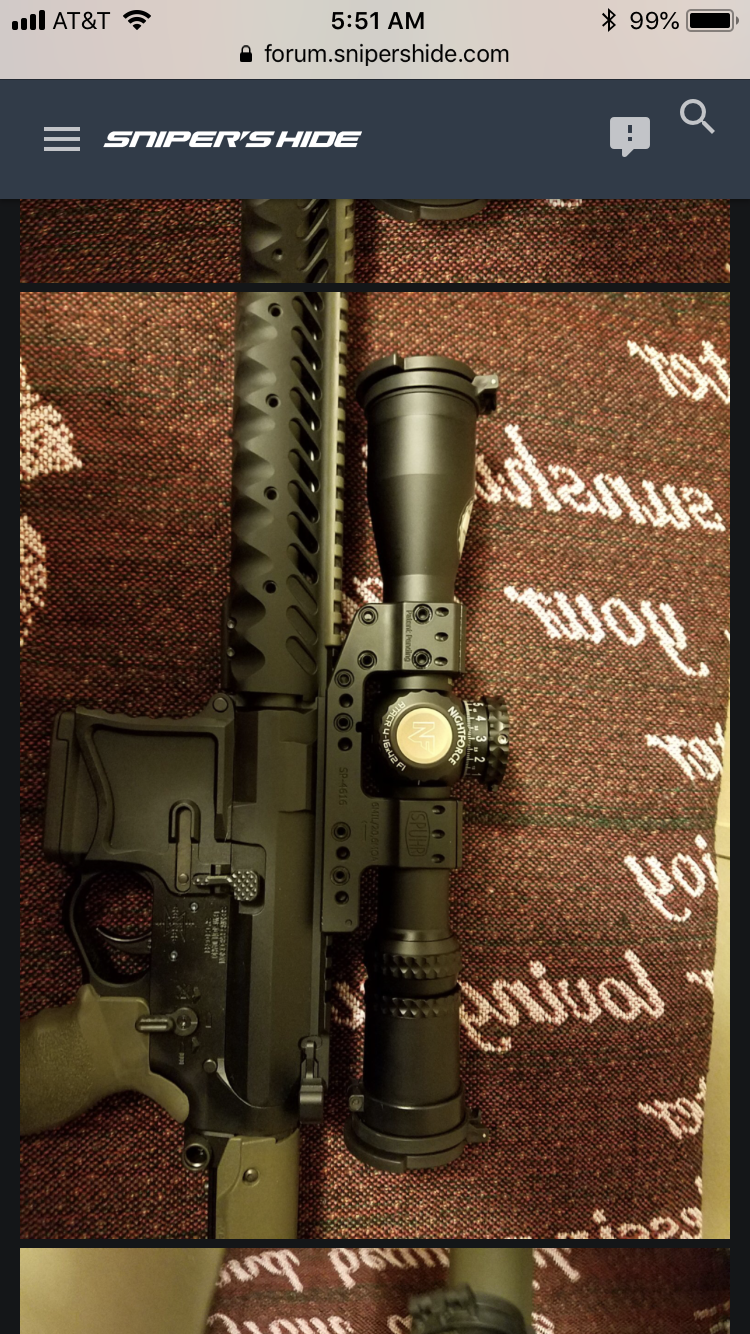

I have the ATACR on my “SPR” Noveske and I don’t find it to be too much at all. In fact it’s one of my favorite optics I have ever owned. It’s a very useful mag range, it’s obviously quality and it just looks so good:
