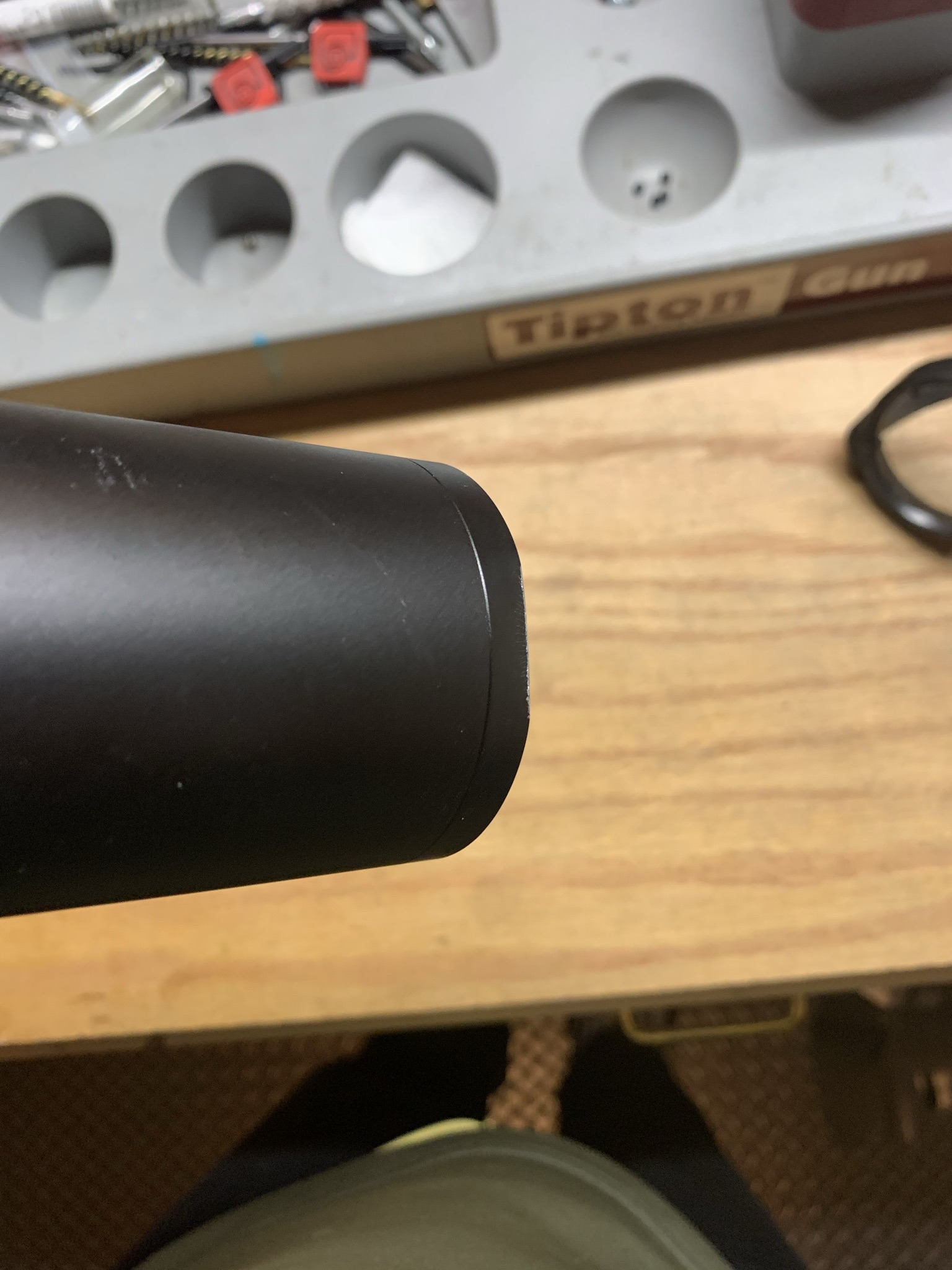

Several years ago at a BR match a guy had his 15 lb bench gun with a Nightforce 12-42 on the bench setting in a Bald Eagle from rest, rear bag.
Somehow he snagged it with his jacket and it rolled out and landed on one of the rest leg bolts upside down on the scope.
It made a pretty good gash in the bell but didn’t loose zero.
He said he shot the whole match and never moved it.
I was one bench away and believe him.
