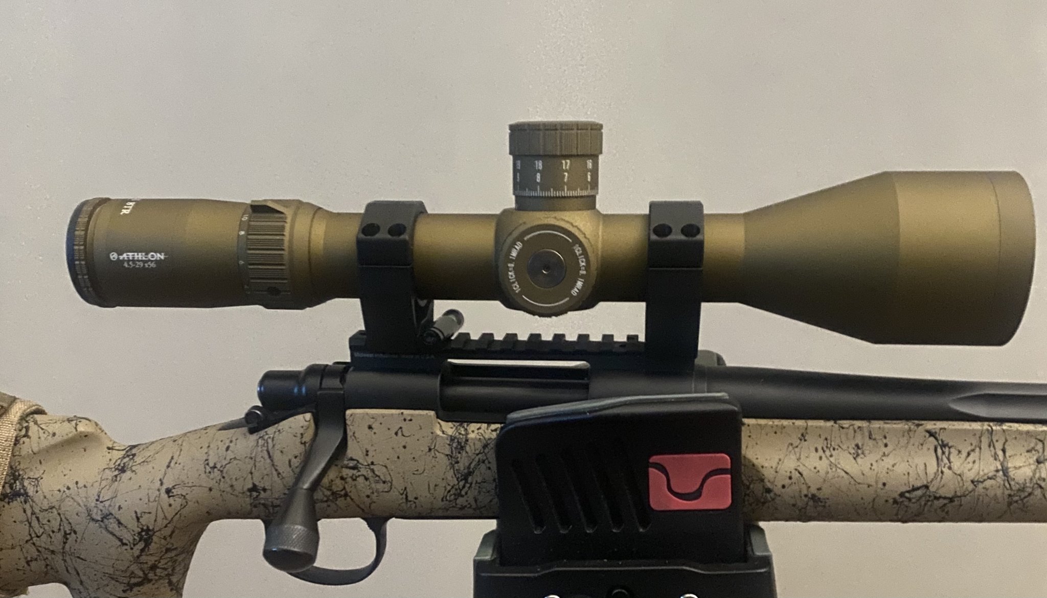

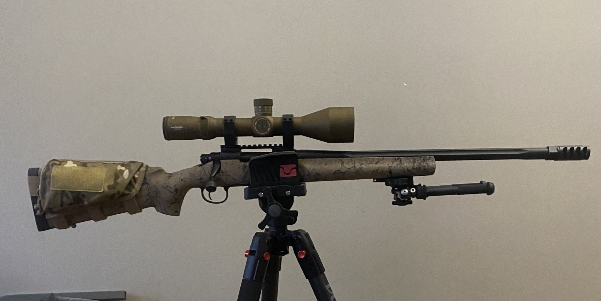

Just got home. The rifle is a Remington 700 with the 5r barrel and hs precision stock in .308. The scope base is 0 moa by Midwest Industries and the rings are vortex precision matched. There are lower rings on the way, I measured incorrectly the first go round.
It’s typically used for targets out to 500 or so, hog hunting to 300 and whitetail at 1-200, so nothing extreme.
For scale the scope bell is 5/8 over the barrel.
I find it very odd that you're not closer to the middle of your scope with a 0 MOA rail. That means your sight axis diverges up from your bore axis by over 5 mrad. Is it possible that you have 20 MOA rings installed backwards? Your front ring does look taller to me in the picture, but it could just be perspective. And that would put your sight axis around 6 mrad up from the bore axis. If you're taking the rings off anyway, try putting them next to each other and see if they're the same size.
When I mount a new scope, I generally convert the rail's incline to mrad, dial down that much, shoot the rifle, and I'm nearly on target at 100 yards, because the sight an bore axes are so close to each other.

I took it all apart and measured the rings heights from the top of the rail to the lowest section of the rings that hold the scope tube (hopefully that makes sense) with a micrometer and they’re both the exact same. The scope is new to the rifle, before it had a vortex 30mm that was right on. Went to a 34mm tube to get more elevation adjustment.
If the zero of your other scope was close to the middle of your elevation, I'd suspect the new scope might be bad. It's possible something is loose in the elevation mechanism, or there was a manufacturing error. Athlon has a lifetime warranty, I believe. Maybe give them a call.
