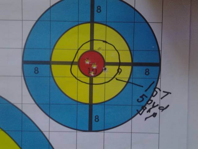

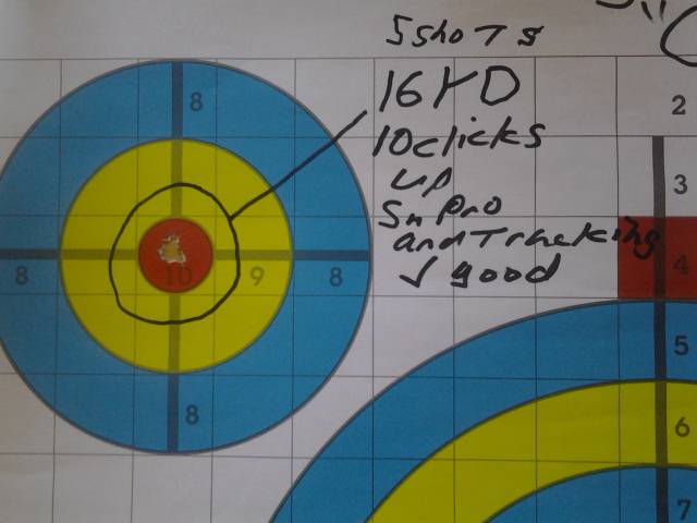

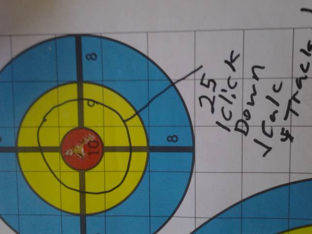

So I got to the range with the Bushnell 3 x 9.
Shot 16.6, 25 and 50yds.
The scope tracked and returned to zero at those short yardages.
The side focus preformed well and lined up with factory hash marks for distance.
The reticle focus came in clear.
The low wide well marked turrets are easy to see.
Small mounting hassle, I had to use a high scope ring to clear the base there is a ?spring housing on the bottom.
That put center at 2 inches.
Setting the turrets zeros is stiff and takes some hand strength to lift them up, new!
Precision shooters with good eyes may want thinner reticle and 1/8 clicks.
I have not got past 50yds yet, if it continues to preform I will be getting more of these!
Big bore boys set up next to me so I stopped at 50 for the day.
100$ class win win so far.
Here's a couple of cherry picked groups from the day.
