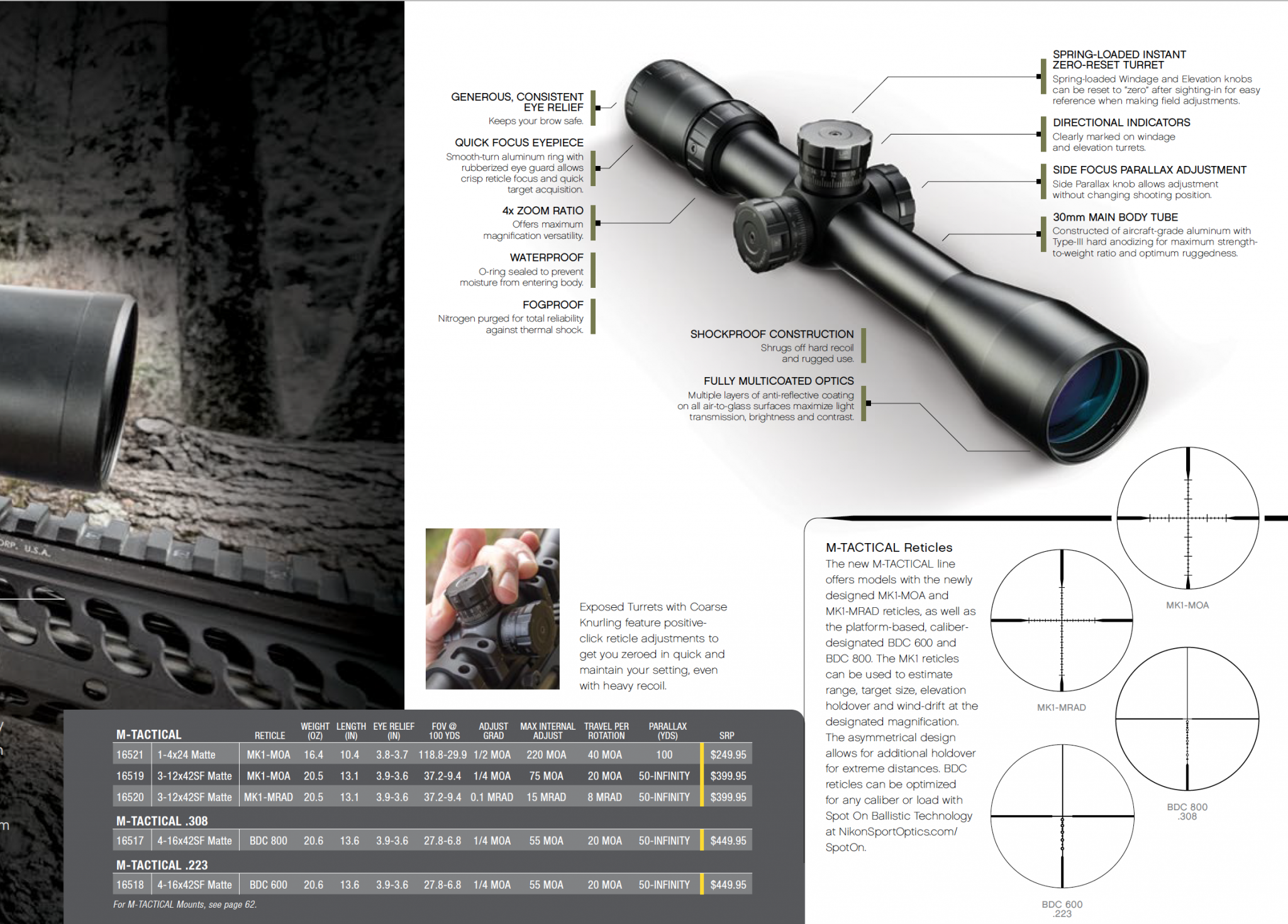

Nikon has designed the M-223 scope and it is much more user friendly and has some great added features. It is called the M-Tactical and you can get it in BDC, MOA or MRAD. Different magnification setting's as well. 30 MOA tube's and no plastic or decal's applied. Definitely a much nicer more user friendly scope. Check ouut the feature's here.
