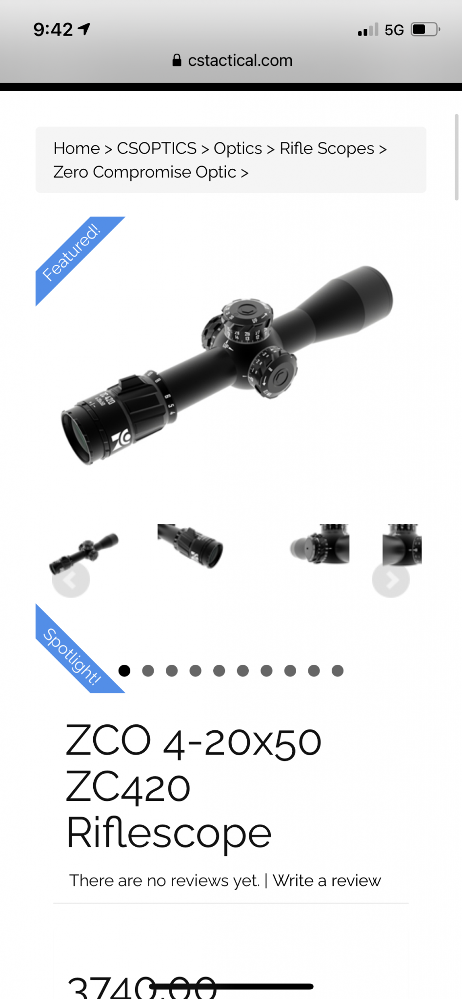

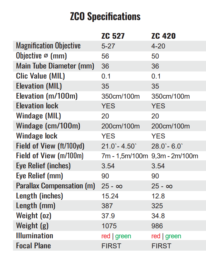

ZCO-what can I say. The 5-25 is my favorite scope I've owned yet but the 4-20 may be a bit overkill on this rifle.
