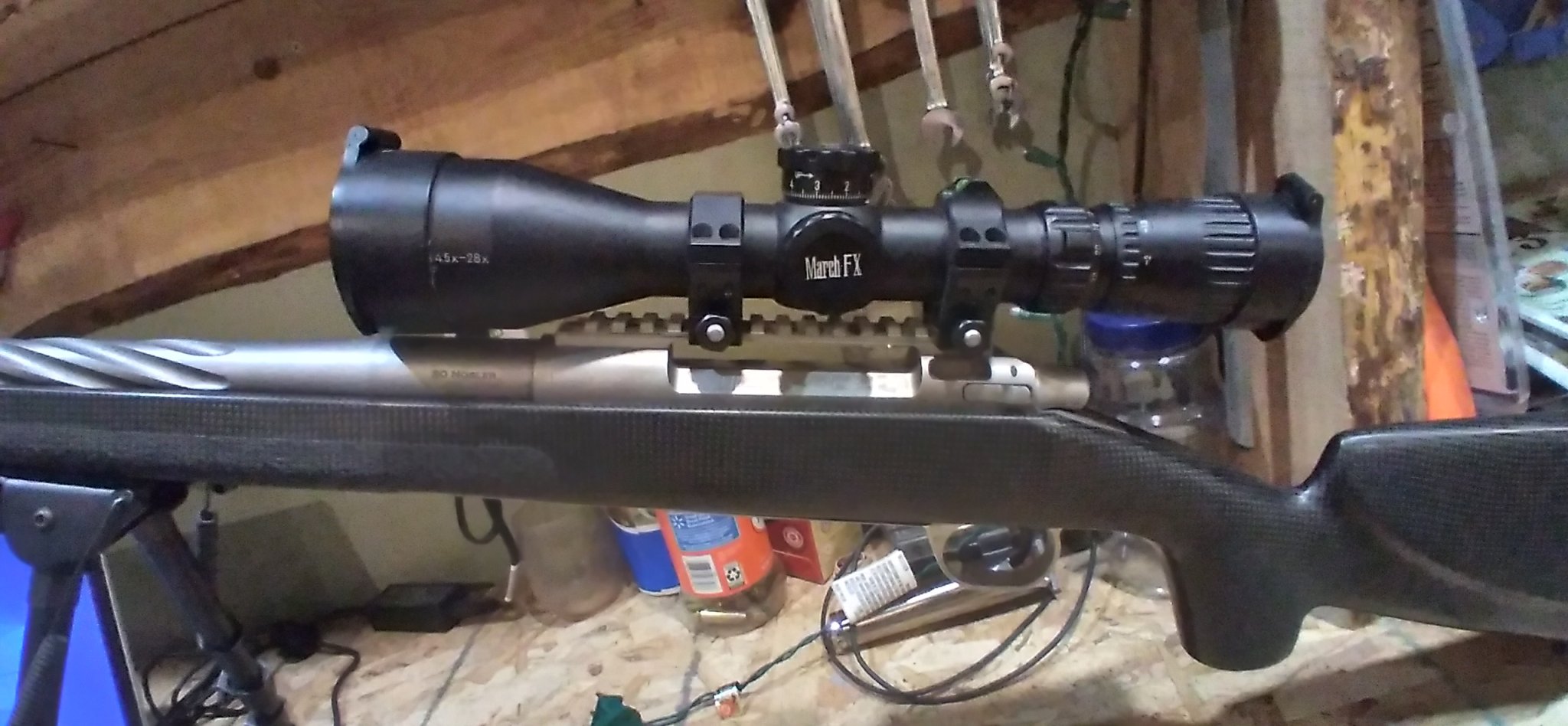

Unfortunatly I realized that the March scopes wouldn't fit on my Anti-X long action (too short).
I don't know it fits pretty dang good on mine with the included pic rail and Hawkins ultralight rings
