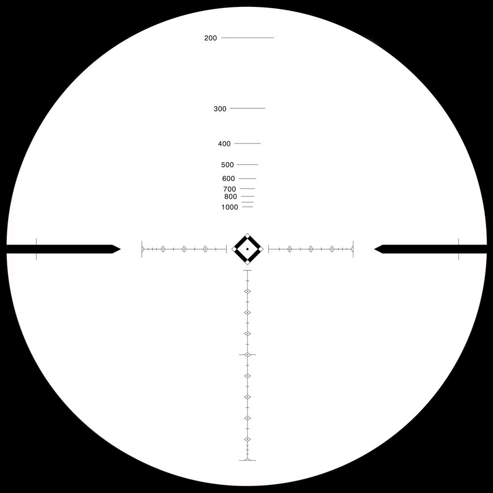

I use a SWFA 3-15 SFP DM reticle. Usually turn down to 10x for PRS type matches. Struggled at first till I figured out how to use Strelok and its holdover with reduced power function and get holdovers to put on my armband. Works really good and if the target is in the diamond shoot. Don't have to hunt for the reticle and with SFP the subtensions are easy to see.
I use 20x MOA-Quad SWFA on my longrange rimfires but for quick target acquisitions this works great. Bad news is they only made it for a couple years and are hard to find. Advantages and disadvantages to both.

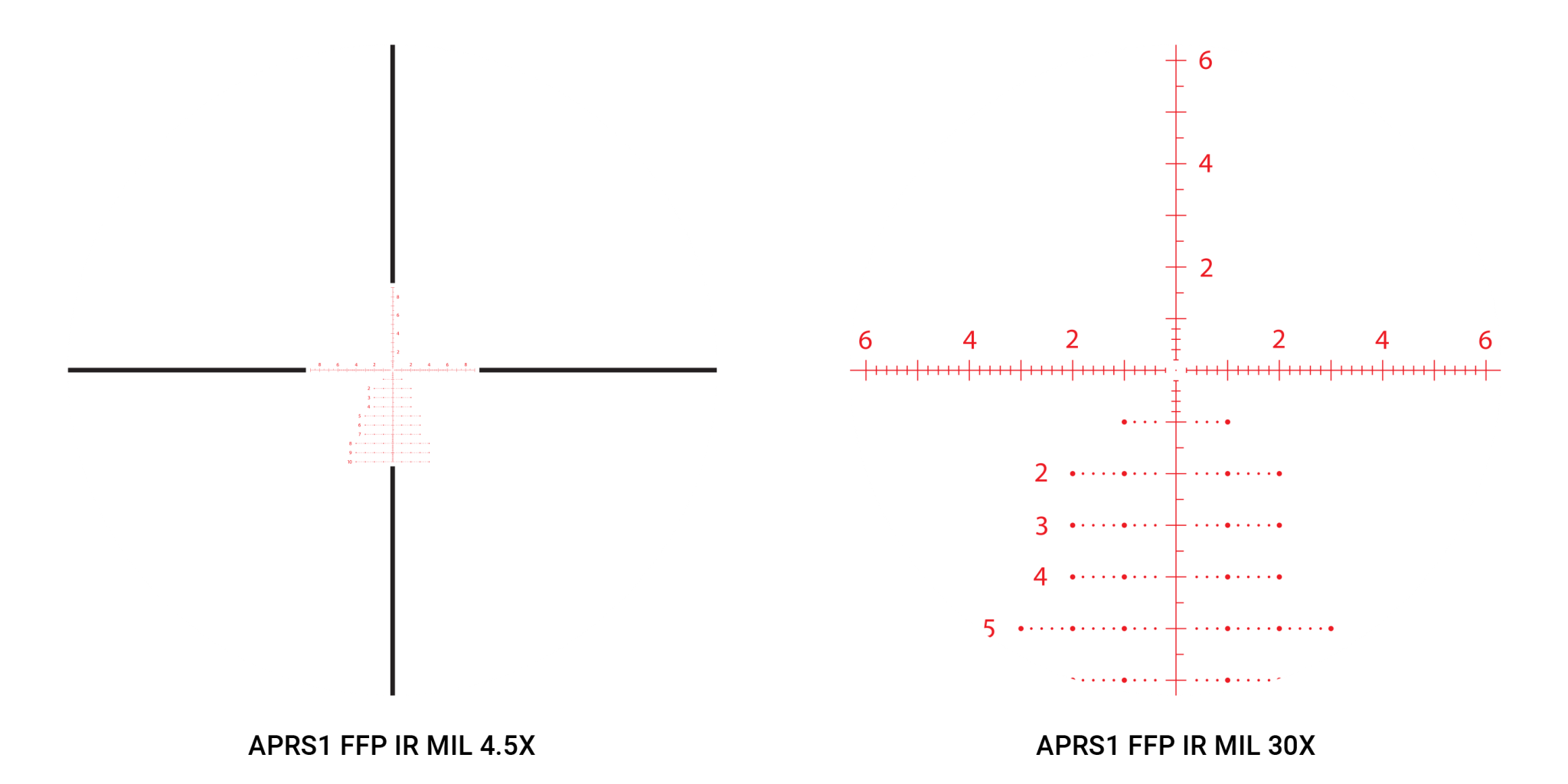

I have an Ares ETR 4.5-30. I don't think I've ever run it at 4.5, maybe if I'm shooting for a 5" plate at 75 yards in offhand position - When I'm shooting at that range, I don't really need to care about the reticle and holdovers, so it's pretty easy to see the left pictured reticle and know where the center is. When I'm shooting for the 1/4" and 1/2" targets at 50 yards, I generally run it at around 12-15x. I sometimes will go up to 20x if I'm going for the 1.5" at 100 yards. In all the ranges 12-30x I have no problem findinging my subtensions and shooting my targets w/ holdovers.
I like 30x for punching holes in paper and looking at my groups at 100/200.
