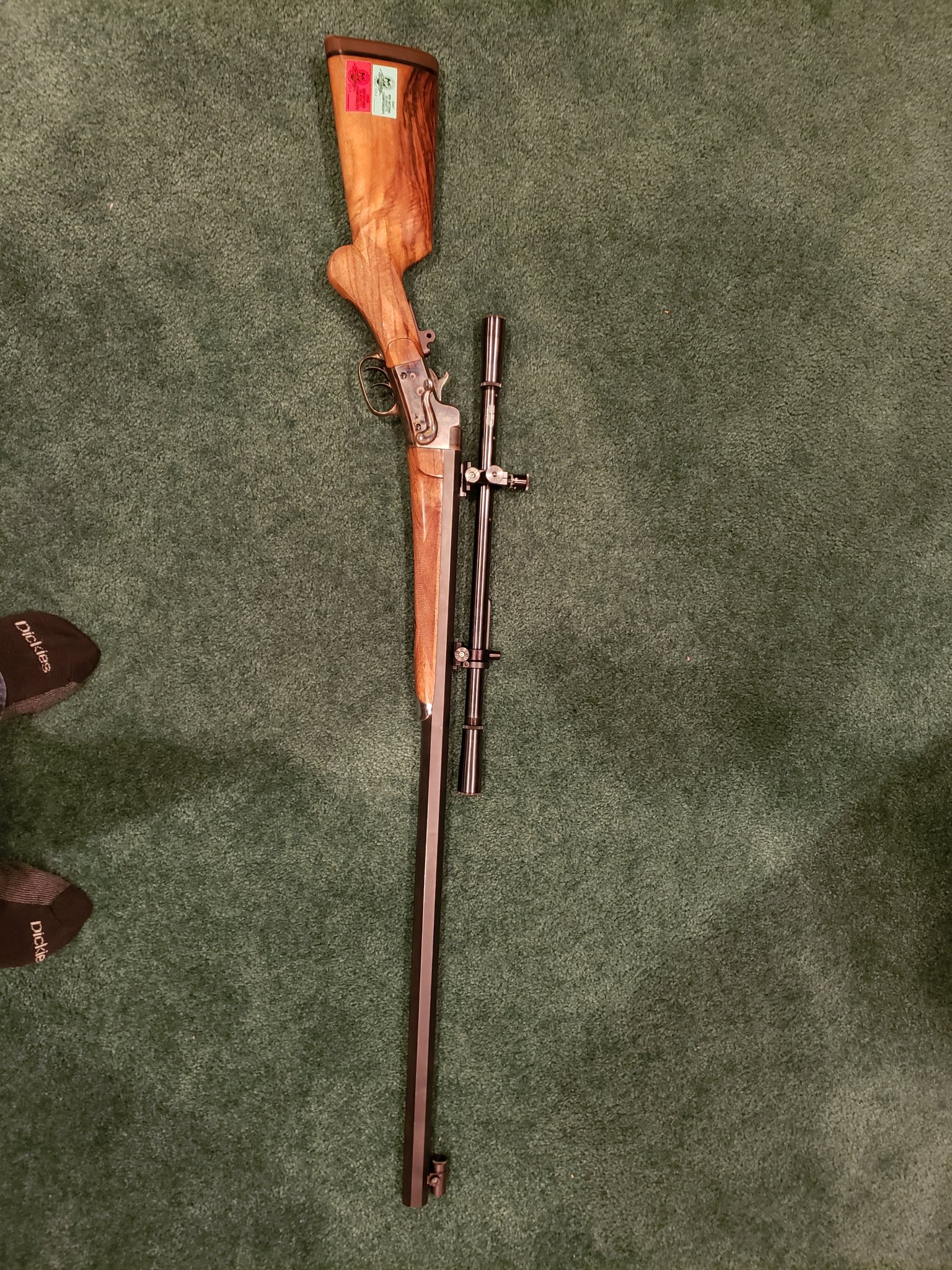

I acquired a 38-55 Sharps sometime ago and am finally trying to get it operational. I would like to put on a period scope. It came with what I believe to be a Unertl Type Scope Mount on the gun. See First image.

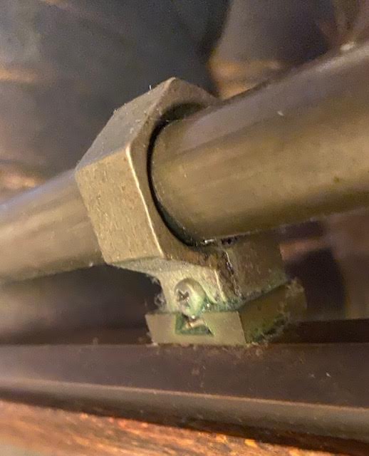

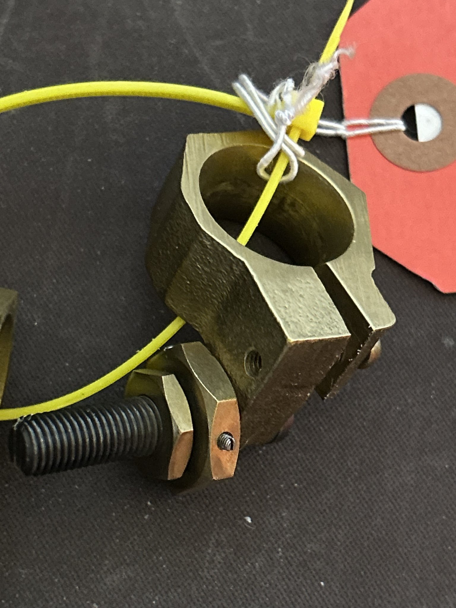

I just found a brass Navy Arms 4x15 scope with mounts that appear to need to be tapped into the barrel. See Second and Third images.
Would you recommend:
1) that I remove the existing mounts and retap the barrel.
2) that I get a different scope that can be mounted using the Unertl mounts
3) use a brass plate or something to marry the two together
4) something else

There should be a block for that middle ring to slide in, that's how you adjust windage (poorly). As well the "mount" portion of the rear ring.
The mounts are crappy, I wouldn't use them if I had the option not to. Occasionally I think about buying new mounts and putting my scope on something else, though I don't know if it's worth it money wise.
(I think I paid $200 for my scope/mounts around 1989.)
