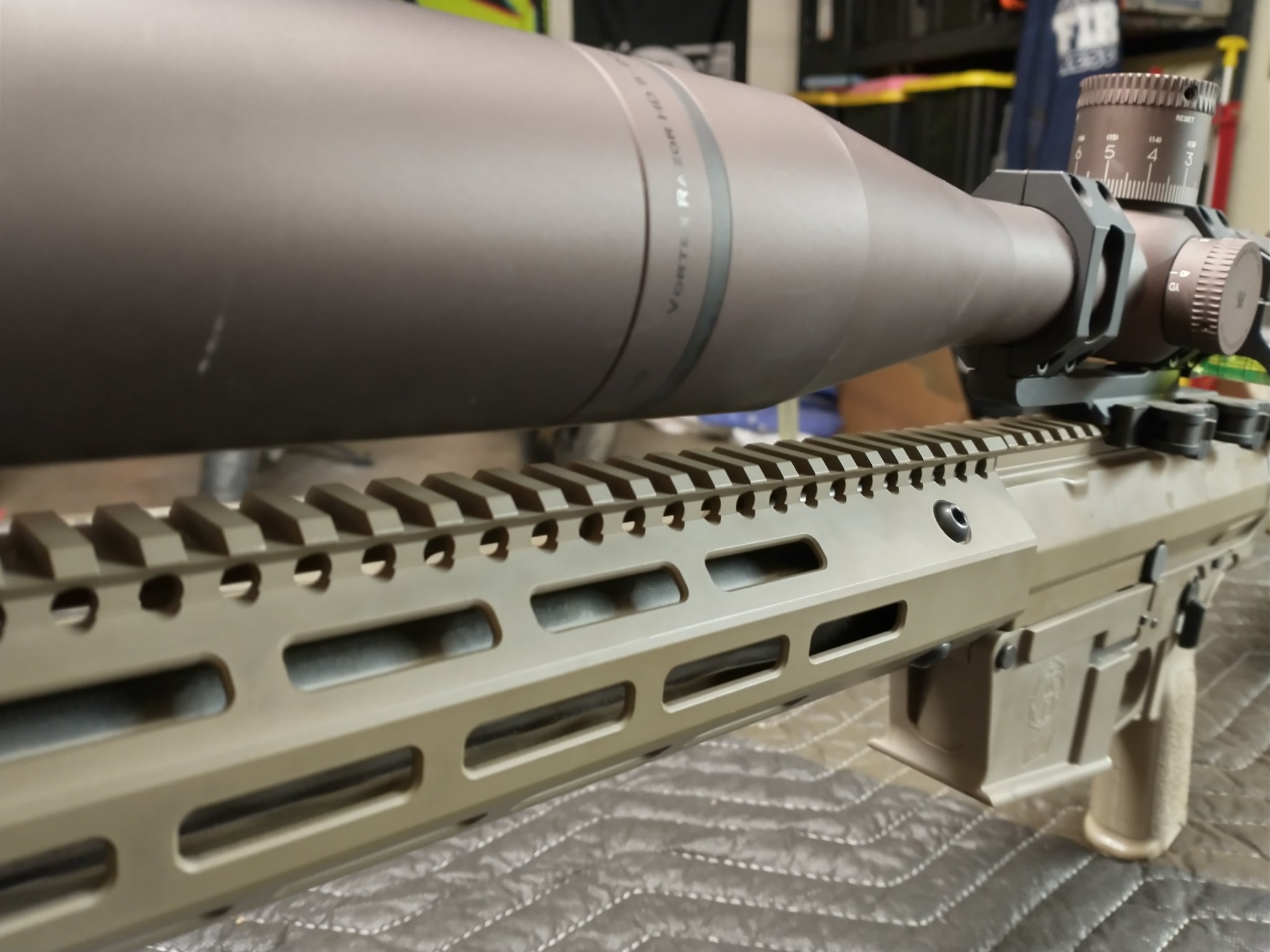

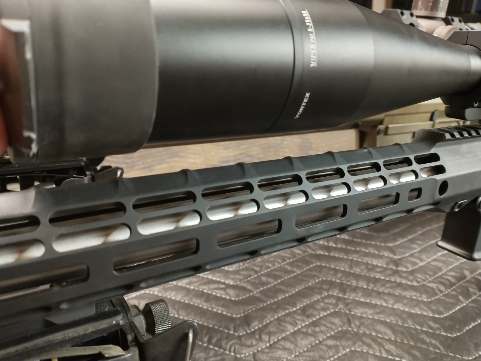

Depends on the handguard. I run an AR-10 with a Razor HD in an ADM 20MOA mount and with the Troy handguard there's enough space to feel comfortable. I also have a PST G2 on an AR-15 in .224 Valkyrie and in the same model mount (albeit for a 30mm tube instead of a 35mm tube) there's even more - but that's because I have an Aero handguard that narrows after the barrel nut. But to answer your question more directly, if you're using the stock handguard, standard Vortex High rings (or any other ring that offers ~1.26" center scope height) will do. Why are you trying to get your scope so low?

View attachment 7772953View attachment 7772954
Not necessarily looking for as low as possible. Just not wanting my scope to touch. Was looking for the least clearance I could get away with, essentially just to know a baseline for mount options.

What height are your mounts?
Generally, you find you are best served with a 1.5" mount, which is somewhat standard for AR platforms. The 1.5" general rule of thumb is that it will clear a 56mm bell housing with 0 MOA cant. Since you are at 50mm, and have some modest cant at 20 MOA, you could get by with less than 1.5", but you will find a hugh selection at 1.5", 1.48", 1.44" etc, which will work fine.
