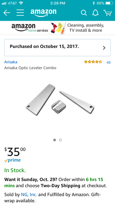

I bought this tool off amazon, it’s basically the same as the sphur. I mounted my Vortex amg in a set of ARC M10 rings in under 5 minutes and it appears perfectly straight to me. I also checked it with a couple of levels and they show dead on.

Anyone tried the Arisaka Scope Leveler ?
Looks a good little tool and easy to carry. Doesn't depend on plumb lines or level benches....
Yes, it works good if you have a mount with plenty of clearance between the base and scope. Feeler gauges do the exact same thing, just a bit more involved getting the correct “stack”. However, it works better for tighter clearances.
You can get the same thing as the Arisaka tool (and other brands) at McMaster Carr. For half the price. But a set of feeler gauges or playing cards work well too. Like someone above said, the Arisaka-type levels only work if your scope is super high off your rail or mount. I have the smaller one and it doesn't really fit under a typical 5-25x scope.
