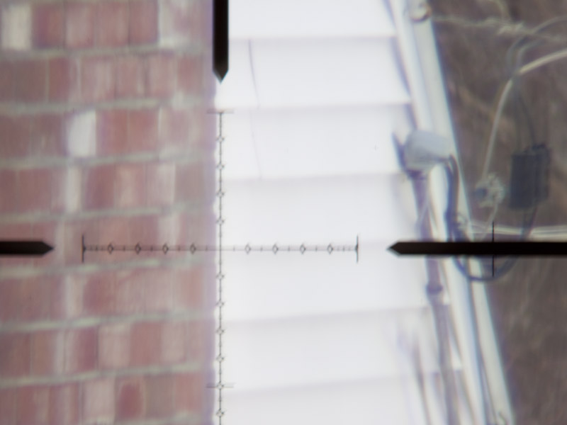

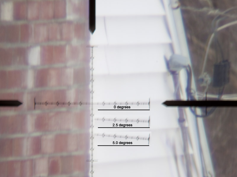

I made a power point slide with a vertical and horizontal line. Made sure my computer was level. Screwed my D.F.A.T in and then set the reticle to the vertical and horizontal lines. I'll check it with a tall target when I get to the range.

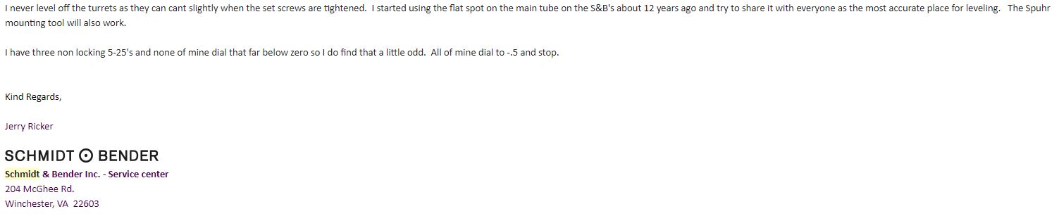

Leveling scope by the reticle housing flat on the bottom of the scope is the correct method. I wouldn't count on the turret caps being an accurate indicator. Maybe this is what you mean and we're just talking past each other? (Edit: just re-read your post and see that is what you're describing).
FWIW, using feeler gauges between the rail and the flat on the bottom of my SWFA HD scope indicates it's square after using the method I described above.
@ ThePretzel, I understand what you're saying.
See post #12 here - http://www.snipershide.com/shooting/threads/using-scope-turret-to-level-scope-fail.6595494/
Bingo...leveling using the turret caps is far from perfect. The link you specified describes the process perfectly and it is the method I have followed since reading it. It works extraordinarily well for me.

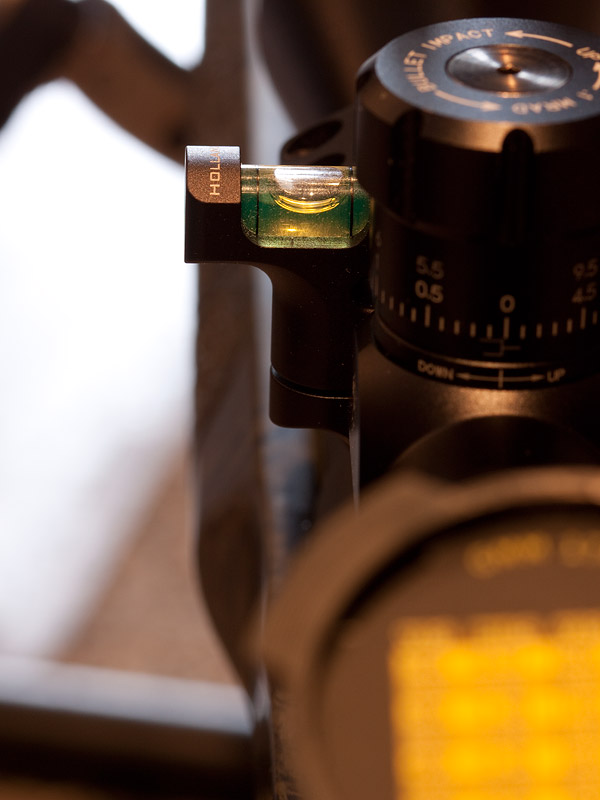

In all cases, the rifle should be used with the scope level bubble as perfectly centered as possible.​
If we are in agreement with the above, here is what I think would be the practical scope-mounting method;
Use something like this (or the deck of cards, feeler gauges, etc.) to install the scope with its turret housing square to the rail.​
Use the EXD tool to position and hold the rifle with the scope plumb to the bore (zero cant) as shown in post #12 above.​

Bubble level should be mounted level with the reticle. You r doing it right.
I understand the math...what I don't understand is the process discussed, namely, why the way the scope level is mounted is dependent on whether you dial or holdover.
The scope level isn't dependent on whether you dial or holdover. Once you've leveled your scope properly you adjust the scope level to match, simple as that. Regardless of how you level a scope, you always set the bubble level on the scope as the last step in the process since if you set it earlier it'll be wrong once you properly adjust the scope.

If the scope is installed with the turret housing perfectly square to the rail (and assuming the rail is square to the receiver), then positioning the rifle with zero cant (using something like the EXD tool) should place the vertical turret perfectly square to gravity. This will allow one to see if the reticle was installed straight with the turrets by observing a known vertical line (plumb bob, side of building, etc.). I believe this might be the most practical way to make that evaluation.
Scenario 1 - Canted Reticle
If the reticle appears canted when doing the above evaluation, it would be reasonable to conclude the reticle was installed canted to the turrets when the scope was made. If that is the case (and assuming the scope is NOT sent back for correction), one will need to determine whether they will use hold-over or dial-in corrections because the bubble level cannot be squared with both the reticle and turrets simultaneously.
If one is using hold-over, the bubble level should be squared with the reticle to ensure the vertical stadia is held plumb to the fall of the bullet.
If one is using dial-in corrections, the bubble level should be squared with the turret housing to ensure it is held plumb to the fall of the bullet.
Scenario 2 - Straight Reticle
In this case, the reticle and turret housing are square to each other. Install the bubble level and use either hold-over or dial-in elevation corrections as a centered bubble in the scope level indicate both the reticle and turret are square to the fall of the bullet. :)
At the end of the day, the most critical thing I want to accomplish is to square my scope level to either the reticle or the turret housing (which will be one-in-the-same if the reticle was installed straight) and use the scope level to ensure I hold square to the fall of the bullet when I pull the trigger.

So, you can "only afford" to buy S&B? Even NightForce only guarantees no worse than .5 degree reticle offset. Unless you have taken the time to actually evaluate your scopes, you'll never know if the reticles are canted or not (assuming you know how to do so).

The scope is the weakest link in your precision rifle system, you have to test it, especially with OEM products that are not assembled in the US or at the parent location. Most are batch tested.
There is a ton here to unpack, so don’t expect me to read every post, but a lot of what I have read is bad.
1. The true nature of the reticle is a Horus talking point, holding is not more precise, otherwise the other precision disciplines would be using it more. It’s a tlking point from a company that used to only have their reticles in cheap Asian scope, namely Hakko
The Reticles are never squared to the turrets, they use the flat at the bottom. Think about the construction of a scope. The turrets are screws that push or release on the erector which has tension from a spring. The erector has the reticle attached to it, that erector tube is placed inside the scope main tube and is not attached to the turrets, but held under spring tension. Because of that you are not just testing the tracking in terms of adjustment, but by design, some display a curve at the top end of the adjustment range. That curve is because of two round objects being moved in a linear way. If you get too far out to one side a curve will appear.
The spec for a company can vary, so whether it is .5 degrees or 2 degrees, there is a spec and that spec can display an error and still not be eligible for warranty.
