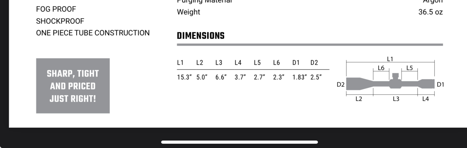

Looking for Measurement from Bottom of Erector housing to middle of Tube for a Athlon Ares ETR 4.5-30x56
Would like to drop an order today and just need to make sure which MPA Unimount I need to throw in the cart

Why that measurement? I’d be more concerned with the objective clearance. There is a formula that is in a pinned comment in the scope section that solves it.

I need to know how much room there will be between bottom of erector housing and the base of the mount so the scope will actually fit in the mount
Because it’s a Unimount
Right but if the objective clears the bottom of the turret surely will. It would have to be an absolutely huge erector assembly to go lower than a 56mm objective. I also have never seen any modern unimount mount or rings where the erector assembly is the critical clearance issue.
are you trying to get the absolute lowest mount possible or some reason? What are you mounting it on?
Even the spec sheet shows this

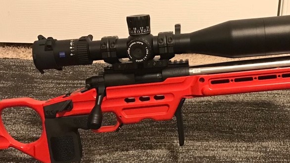

I wouldn't go below 1.125" just for comfort behind the scope. This is a 56mm scope in 1.125" mount and the scope cap has about .1" between the barrel. I actually just moved this to a 1.250" height. Low as possible is an old hunter way of setting up a scope. Being comfortable behind it is much more important.
Thank you brother I appreciate the info
As far a low goes I only shoot targets and always prone but I will keep what you said in mind
I’m sure it wouldn’t hurt to try 1 size up
to 1.250”
