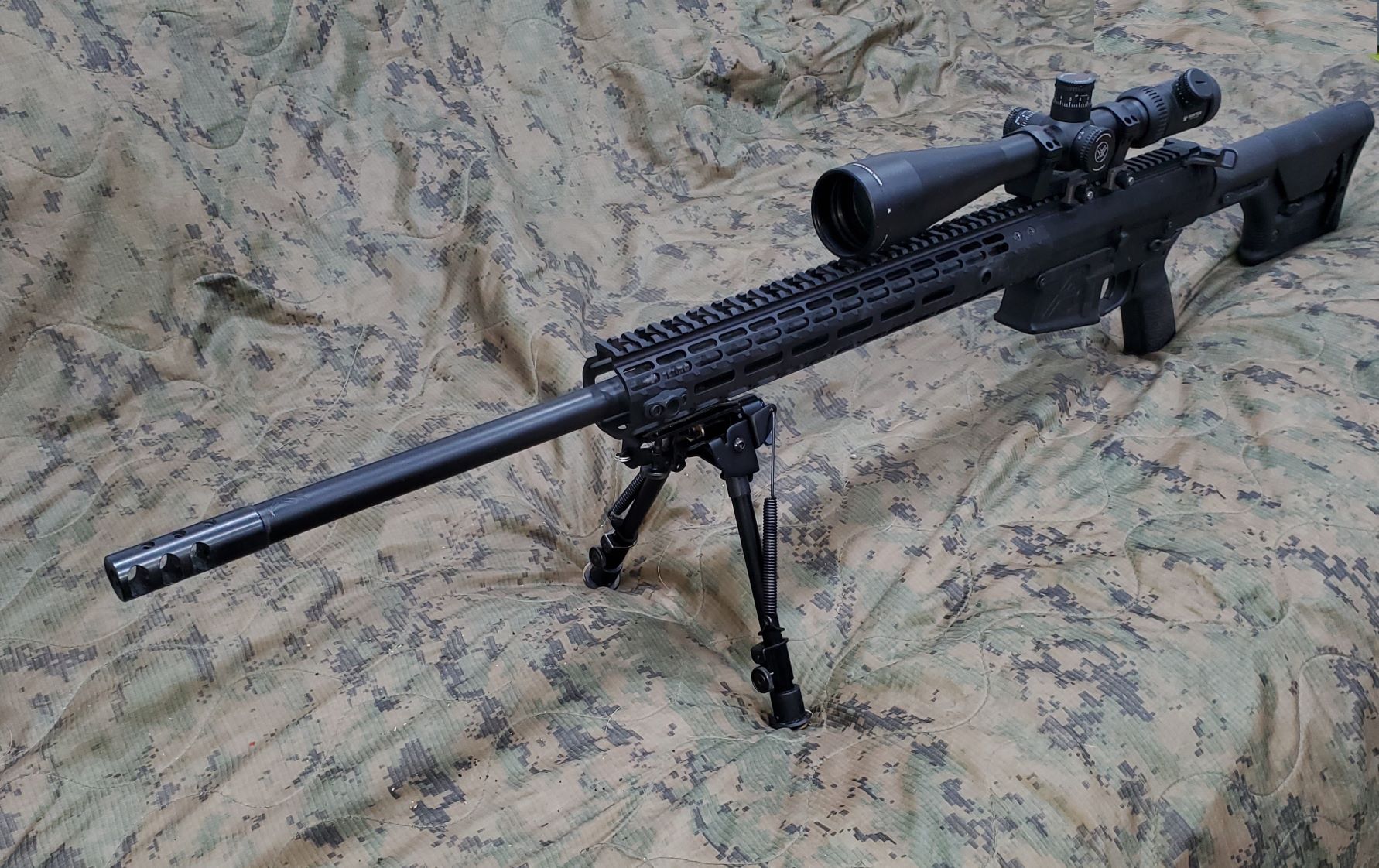

Just buy a Spuhr Cantilever with the built in bubble level and be done and never worry about it. You get what you pay for and why not buy the Best from the get go. I have a Spuhr SP-4016 Cantilever on my GAP-10 and it is Rock Solid, and it looks Great too.
I would prefer the Geiselle Super Precision SR25 Mount but I can't find one or they are no longer made.
