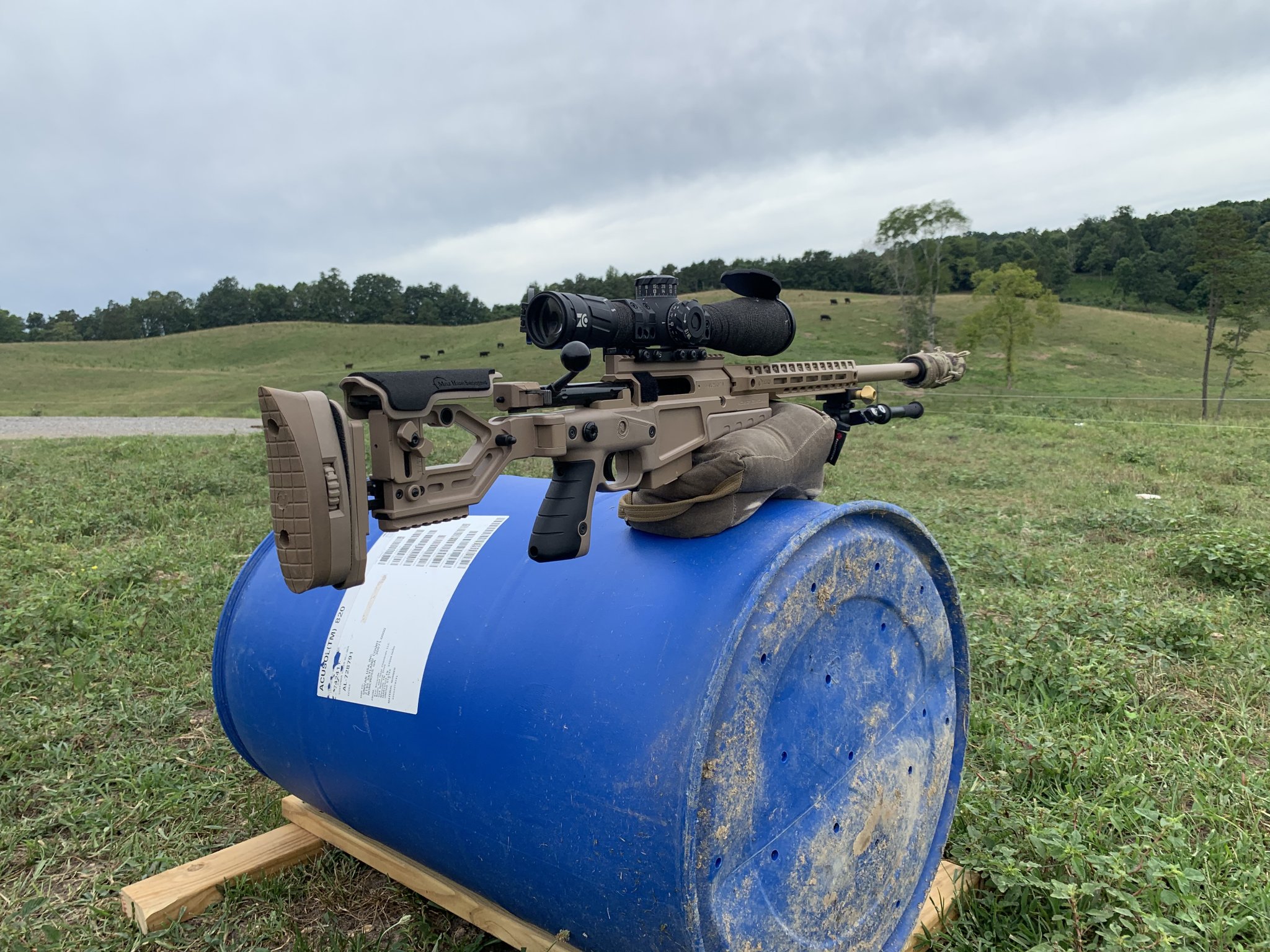

It’s going on a MPA BA comp.

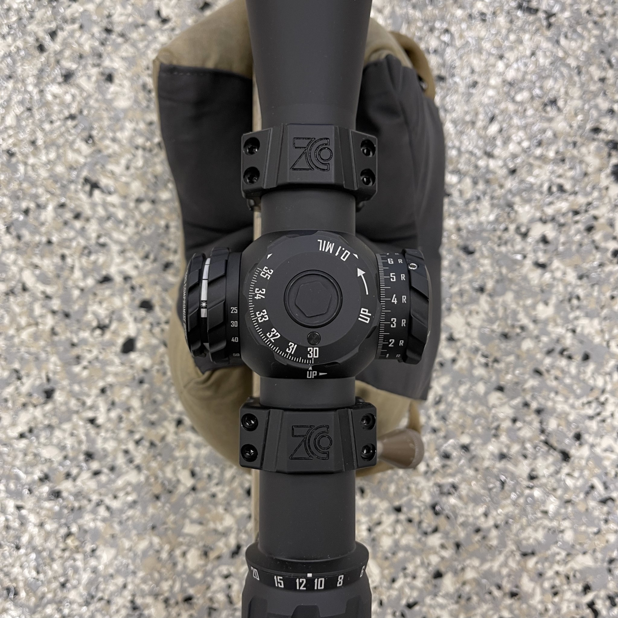

I would grab a set of ARC M10 mediums (36mm tube / 28mm/1.10" height). In fact i just ordered the same set
If you decide on QD, you'll probably have to look past Spuhr then. I can't speak to the other QD mounts you have listed because i haven't personally used them... all reputable companies though.

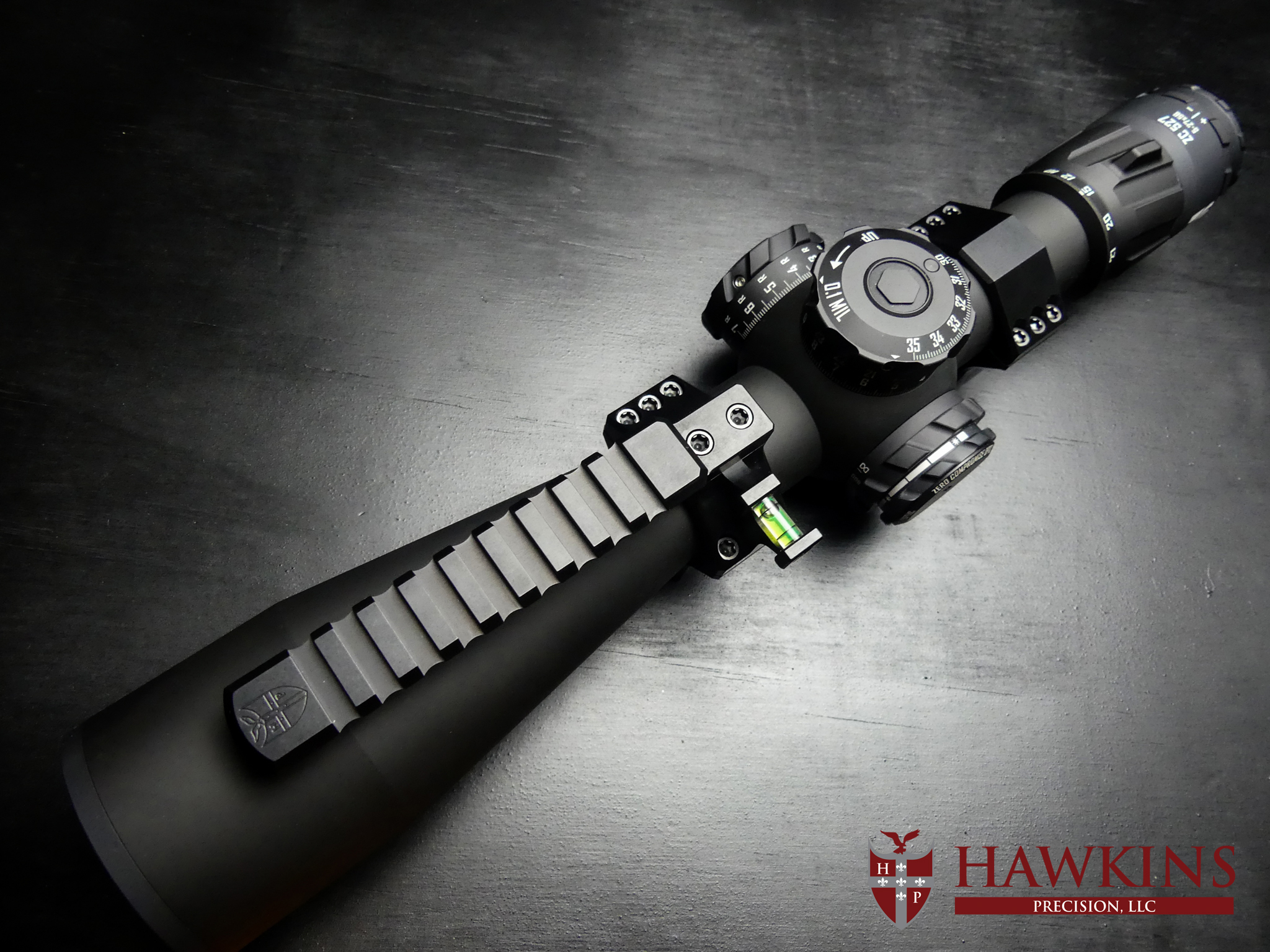

Do you know if they offer a bubble level version?
I don’t believe so but Hoptic makes a cheap picatinny mounted bubble level.

I have both ARC and Spuhr for my ZCOs. I have zero complaints about either of them.
I do like the Spuhr a little better for the easy of removal/swapping between rifles
Thank you!
I’ve got a ZCO 5x27-56 in a Spuhr QD 6002 on a MPA BA Comp shooting a 6.5 and it fits fantastic. If you have any interest in a Send It level you’ll want to opt for the non QD though.
