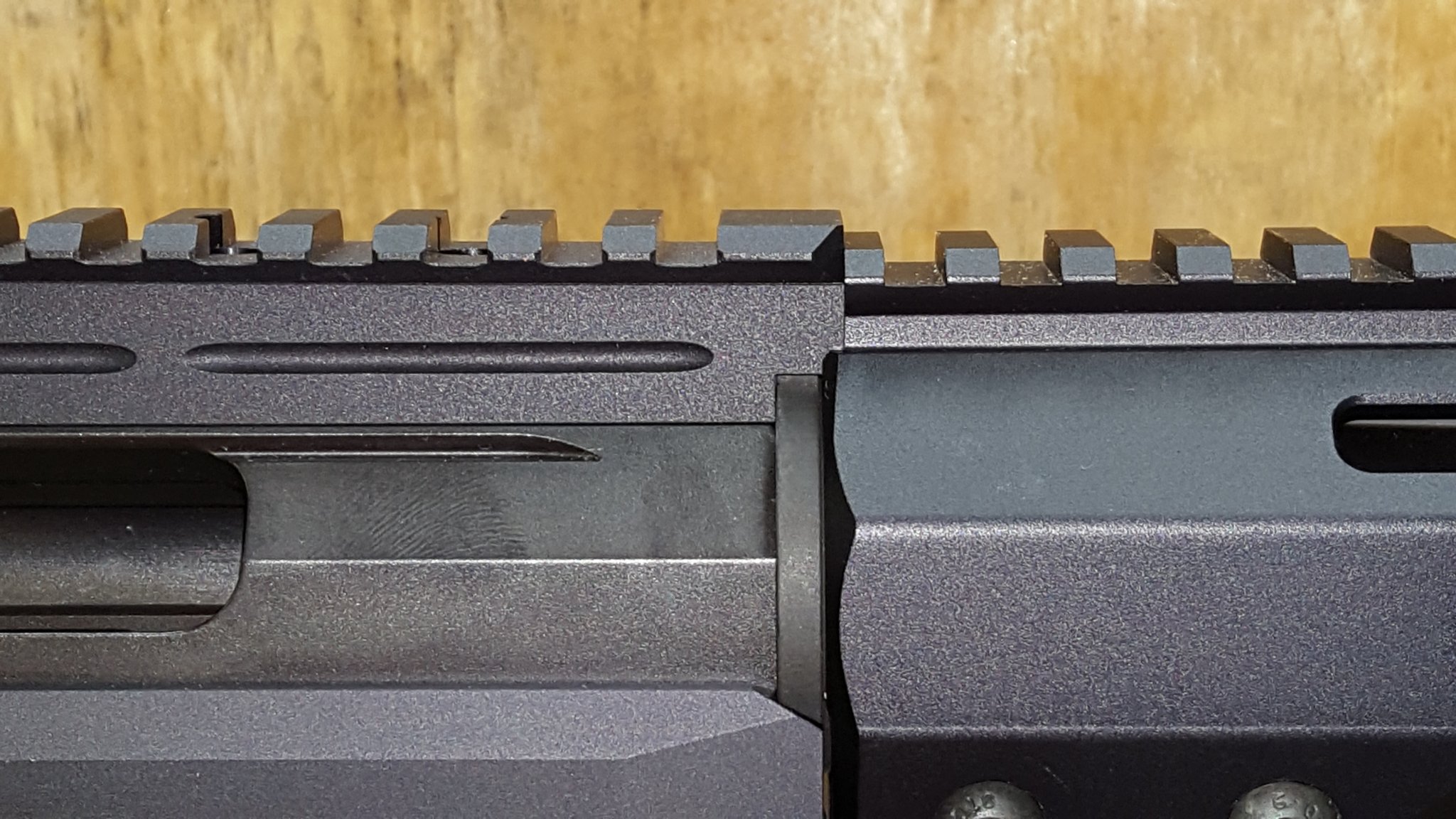

Yes....removing the factory 0 MOA rail is a PITA but very possible.
Yes....there will be a "step" between the 20 MOA and the forend rail.
I personally have removed the factory rail and installed a custom made 20 MOA rail with positive results.
The pic shows the "step" between the rail and forend.
