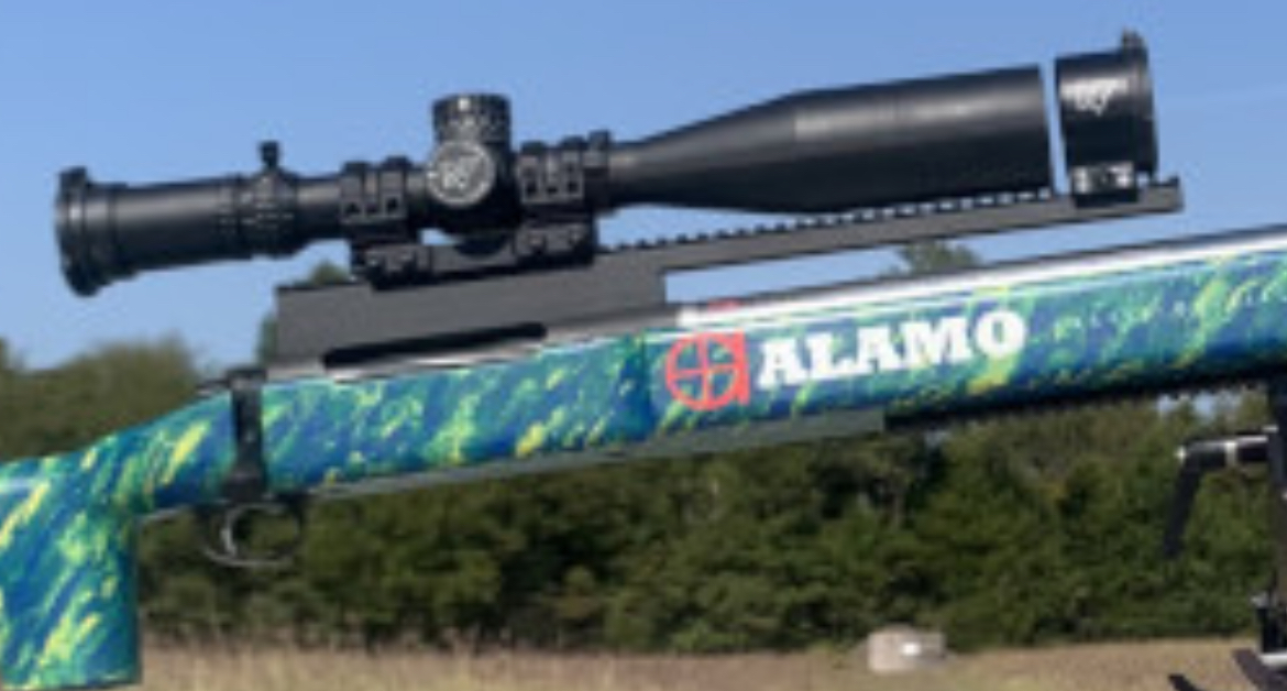

SPUHR 61.8 MOA w a ZEISS LRP S5 with 140 MOA internal travel. Not bottomed out. But remember the mount must be taller and rear of the scope rises up even more with more cant thus making adjustable riser a necessity. Look how tall it sits on that DT HTI.
But, it gets me to 3250 yards at 5000 DA with 50 BMG and 375CT - no prism needed. :)
