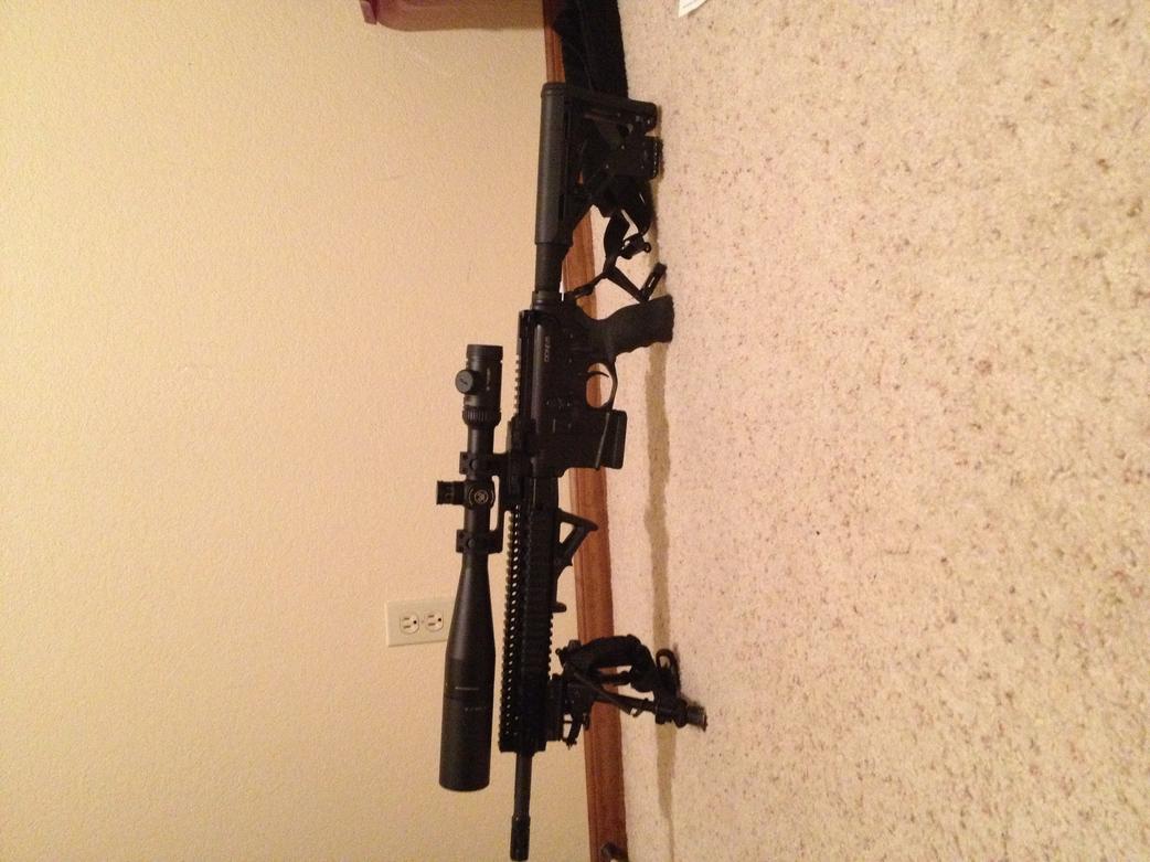

Here are some pics. After working on cheek weld I believe I have been too high on the stock. When I do eyes closed test I think ring height about right for me. But I do think scope needs to be moved back fully on receiver for being more solid and think my problem with cheek weld has been that I was trying to lean forward to get correct eye relief. Think this will get eye relief correct without neck tension. image.jpg

He's talking about how your grip is too high causing your trigger finger to come in canted to the trigger, not that your finger is on the trigger in the first place. Lower your grip down a bit until your trigger finger is squared up, then you can have better trigger control pulling straight to the rear.
And JohnnyC's advice to push the scope further forward in the mount is good. You have what looks to be about an inch of room to work with in there at least.
