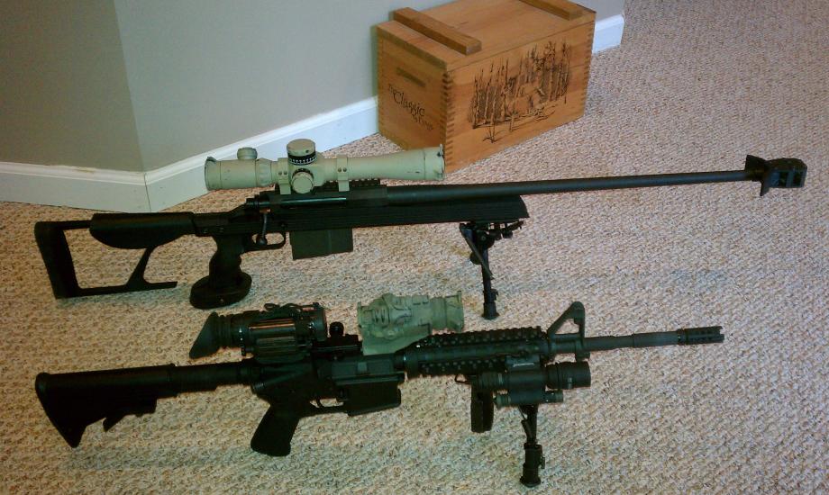

Update....
This is the setup I put together last weekend; with the -14 mounted behind an Aimpoint Comp M3 (my brothers). Seems to work decent.... will hopefully find out this weekend if the weather cooperates.

Just sayin.... Practice gettin it on the gun and I mean practice!!! I'm tellin ya it happens fast, then u r fumblin around getting it on the gun, then u look for it thru the sight and it'll b gone.. So be efficient getting it mounted!!! Good luck, you'll have a blast!!
