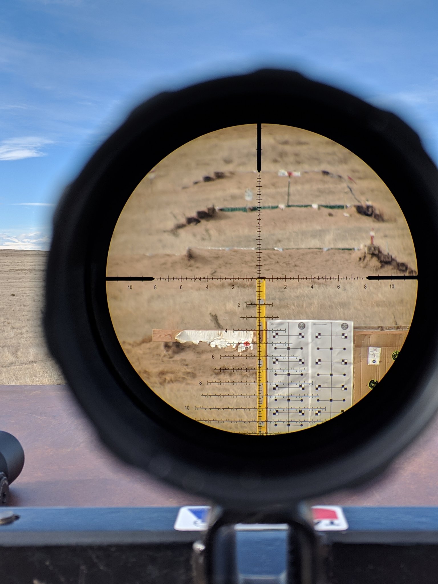

Let’s see if I can keep from getting blasted for asking an “uneducated” marksmen question, in the uneducated forum...haha
I want to confirm my scope reticle is perfect, both from manufacturing and my install and tools.
Assume I took all the proper steps thus far and the scope is on the rifle as level as my tools allow.
My understanding seems like the center of the reticle shouldn’t be too affected by a scope partially rotated, or reticle manufacturing error with tilt. Where it seems the shooter will most be affected is when trying to use hold-over subtensions.
First off I have a Leupold Mk5 with the new pr-1moa reticle. I know there are other methods of testing the reticle (tall target test, ect). What do you guys think about simply dialing in 60 moa of elevation then using the 60moa hold under and seeing if the shot lands as aimed? Then doing the same thing along the windage axis?
I apologize about the jaded tone but kinda got bashed for no particular reason by one of the members in one of the last posts for no real reason. I think everyone is trying to better themselves and I’m just looking for education

Plumb line or level, Tall Target Test 100% of the travel if possible
You can get a partial answer by mounting the scope in a fixture and seeing if it tracks a plumb line. But to check the entire weapon system out I think you need to do a tall target test and really pay attention to the scope level while releasing the shot.
I recall a discussion about leveling the scope to the shooter, not the rifle. Everyone is going to hold the rifle a bit different and some people have a natural cant to the rifle.
There was some back and forth discussion on which is correct, level to the shooter or rifle. I thought I had it saved in my "watched threads" but it's not there. Maybe it was on the scout hide or I just didn't subscribe to it. I tried s quick Google search but didn't find anything.
I'll try a Google search in a day or two. I'm gonna be a bit busy this weekend.
The reticle MUST ALWAYS be level to gravity. The rifle however can be canted to fit the shooter. This the video you are thinking about where @Lowlight discusses this
The best way to do this as lowlight and myself have said is with either a plumb line or use a level. It’s best to do this with a jig and mount the scope in the rings or base when off the rifle. Then you simply mount the scope on the rifle and go. If you want to do the context rifle level scope approach it takes 2 people to do it effectively and right. Shooter gets behind rifle and gets it set in shoulder. With the scope mounted to rifle but loose enough where it can be rotated the second person rotates the scope while the shooter looks through it and when the reticle lines up with the bob or level, torque the rings. Now you have a canted rifle and a level reticle.
I’ll say it again, the reticle must be level. If not you are already failing.

Tall target tests are for scope turret tracking but you can see cant effects as well as long as when you hang the target you take the extra time and attention to make sure the target is perfectly level.

You test it by hanging a plumb bob and twisting the scope until the reticle is aligned with the bob which is perfect with the fall of gravity. Putting a level on top of the turrets and leveling that will get you by for a while, but it isn’t the correct way to do it.

Right, I understand the leveling process. My point is, say the reticle and the turrets aren't correctly aligned with respect to each other. Using the reticle to plumb the scope would result in a turret that isn't plumb. This would reveal itself on a tall target test. As you dial up, you would also see left/right movement.
My question is, once you see that result on a tall target test, then what? Either its a turret that doesn't track perfectly vertical, or its a misaligned reticle. Its probably going back to the manufacturer either way, but is there a way to tell which problem you have?

A reticle that is slightly off shouldn’t cause too much of an issue. If it’s feally really obvious the turret and reticle aren’t perpendicular, do as you say, send it back..
I'm a newbie as well but have discovered that many scopes will deviate for plumb at extreme travel of the turret. If I dial from 0 to the maximum elevation on a decent scope there will usually be some deviation from "perfect". In good scopes it is minimal and able to be compensated for with experience.
In my opinion, tracking is more important than glass quality. If you dial elevation to the extremes and it doesn't stay perfectly level it will require a trip back to the manufacturer to resolve. Luckily I have not encountered this yet. None of them are perfect - the best scopes are certainly very close.
I always hang a line at 100, 200, or more yards and dial it. Roll the elevation from top to bottom and see how it stay level or doesn't. One can also sight vertical objects at distance and average it out. Telephone poles, the sides of buildings, communication towers etc. If I'm sighting a communications tower at 1000+ yards and my reticle stays plumb from 0 to max I call it good.
