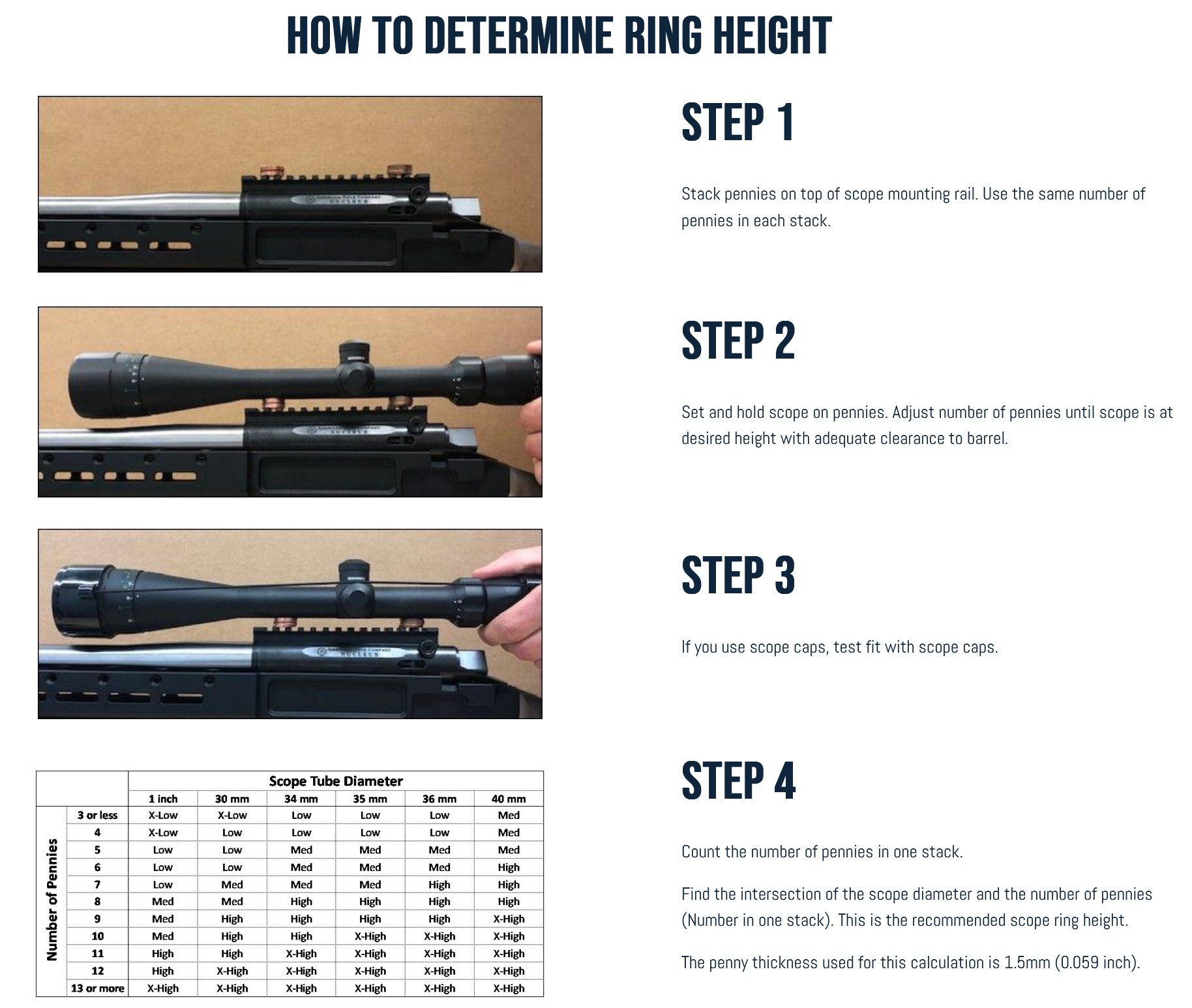

I have no idea where that "math" came from...especially the "+ .20"
But if you are looking at ARC rings, why not take the easy way and use the method they document on their site....and yes, the height found via this method can be used to determine which height rings for other brands also. Its not restricted to ARC.

Since you are using a KRG Bravo which has an adjustable cheek riser, why on earth are you trying to get the ring height so low? Go look at the KRG Bravo page on KRG’s website.
No need to use a low ring height that will prevent you from establishing a good upright head position when shooting prone.
There are lots of threads dealing with this on this site. The majority of shooters today use 1.54” ring heights. Has nothing to do with the type of rifle or the rail. Some of us are experimenting with even taller setups. If you were using a chassis with no cheek riser adjustment, you need to go low and your math works. However, that results in a poor head position. You’re not in that position.
