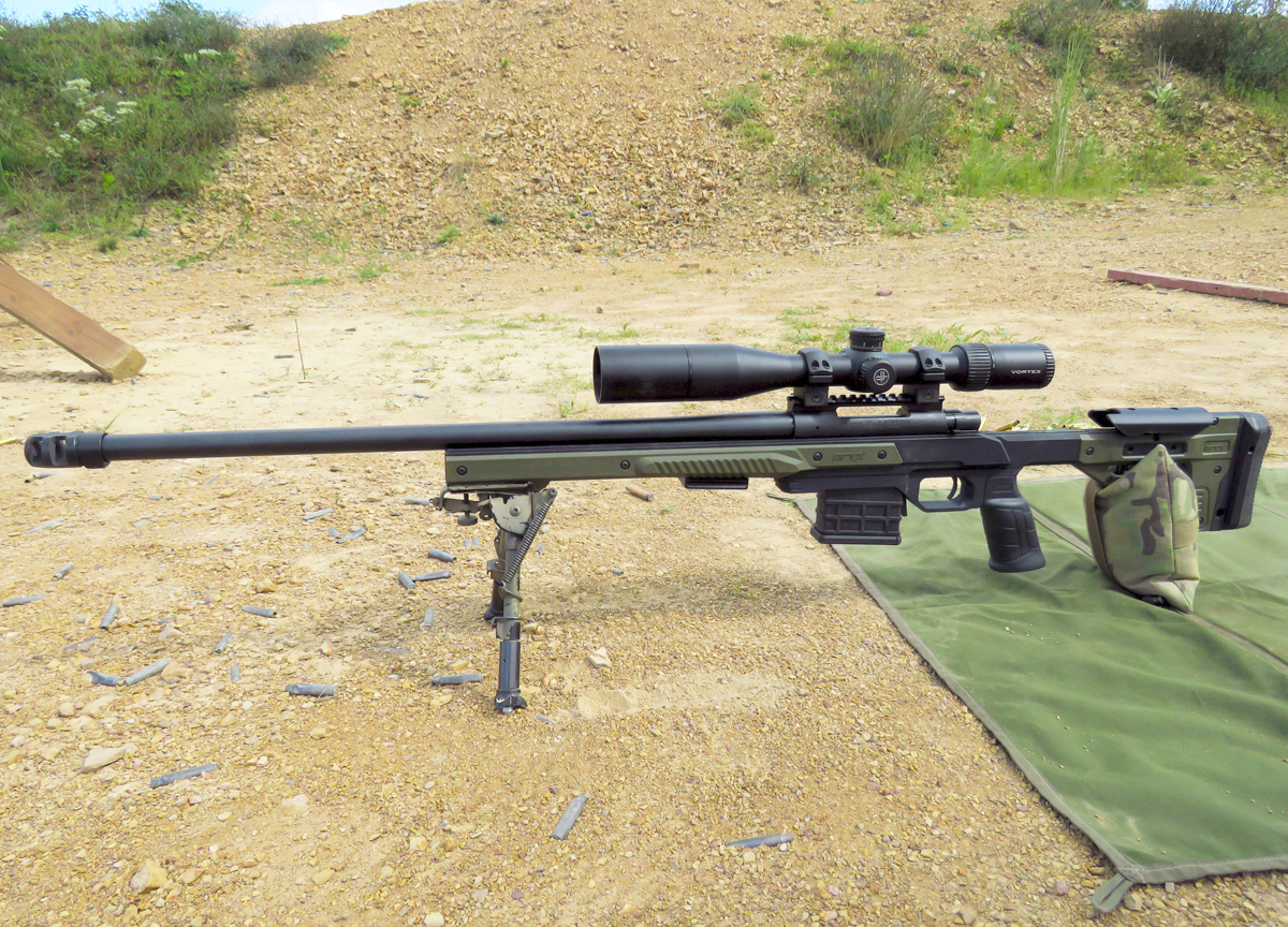

Also, before someone brings up UTG being Chinese junk, the UTG Pros are made in the USA. I used a set on a Howa Oryx, coincidentally with my Vortex DB Tactical 4-16 also and the .98" high lows were good to go. Getting the scope as low as possible doesn't really matter in this day and age because the comb is adjustable, trying to go as low as possible doesn't net you anything.
Well, that would depend on it you have an adjustable comb, I should think. No? And if you do, then it would need to have sufficient adjustment.
in my case, I had to order the long KMW Loggerhead posts from Terry Cross even w my low rings.
