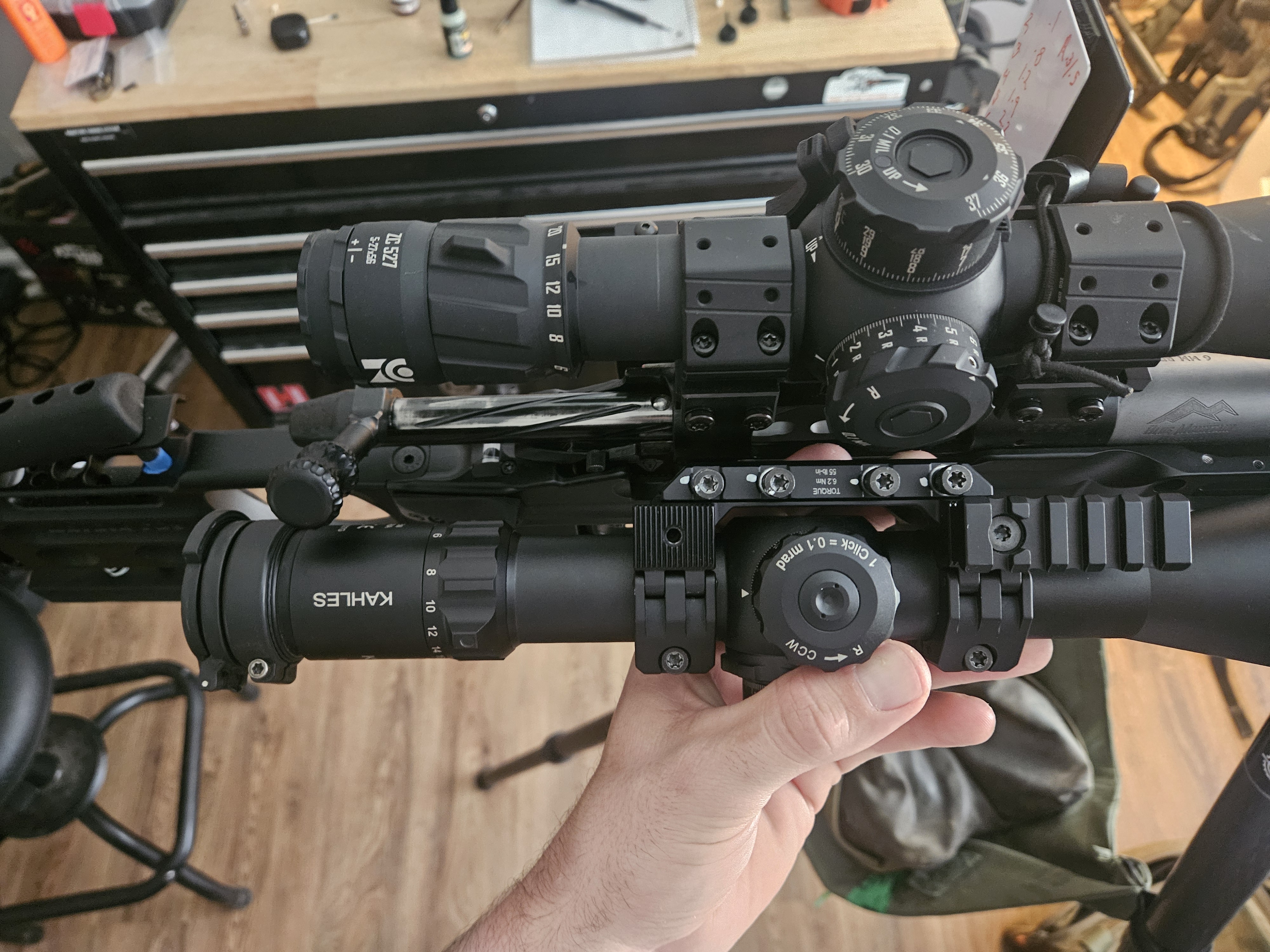

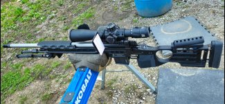

Evening gents. Im setting up a rifle, picked up a ZCO527 for it and I'm struggling to get proper eye relief. It seems like a lot of guys have the opposite problem from me, I'm 6'4", long neck, long arms, but with the way I interface with the gun I can't get the scope back far enough. I'm setting the gun up for shooting barricade 90% of the time, and I normally use around 14.5" LOP.
Im considering buying a pic rail with an overhang so I could scoot the mount back further. Leupold "mark AR", Scalarworks "fuse/01" and PRI are what I've looked at as possible solutions. I'm a little bit hesitant though because this adds complexity, more machined parts, tolerance stacking, things to come loose smd shift etc. Does anyone have experience using a riser like this on a PRS type gun? Any problems with it? I imagine it'd be fine but it gives me the ick as the kids say. I know too many CNC operators...
Another option is to have a scope base custom made that gives me a few more pic rail slots to the rear but that'll be a PITA.
I've never had this problem before so I'm a bit vexed.
If anyone has suggestions or experience using a riser on a precision gun lmk I'd like to hear your thoughts.

They're 1.5", the ZCO Block Mount. I think the increased HOB will be of benefit as well but my main reason for looking at a riser is moving the occular lense rearward.
