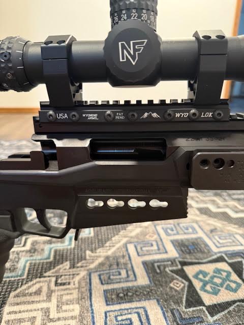

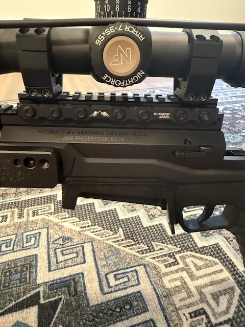

For rails, the Stanag grip type rails, are very secure. I've stacked a couple of GG&G rails and they are as good as being welded together. Scalar Works has a side-and-top-grip rail that is super secure. A 1.57" non-cantilevered scope mount and a 1/2" rail or two is high and plenty secure.
