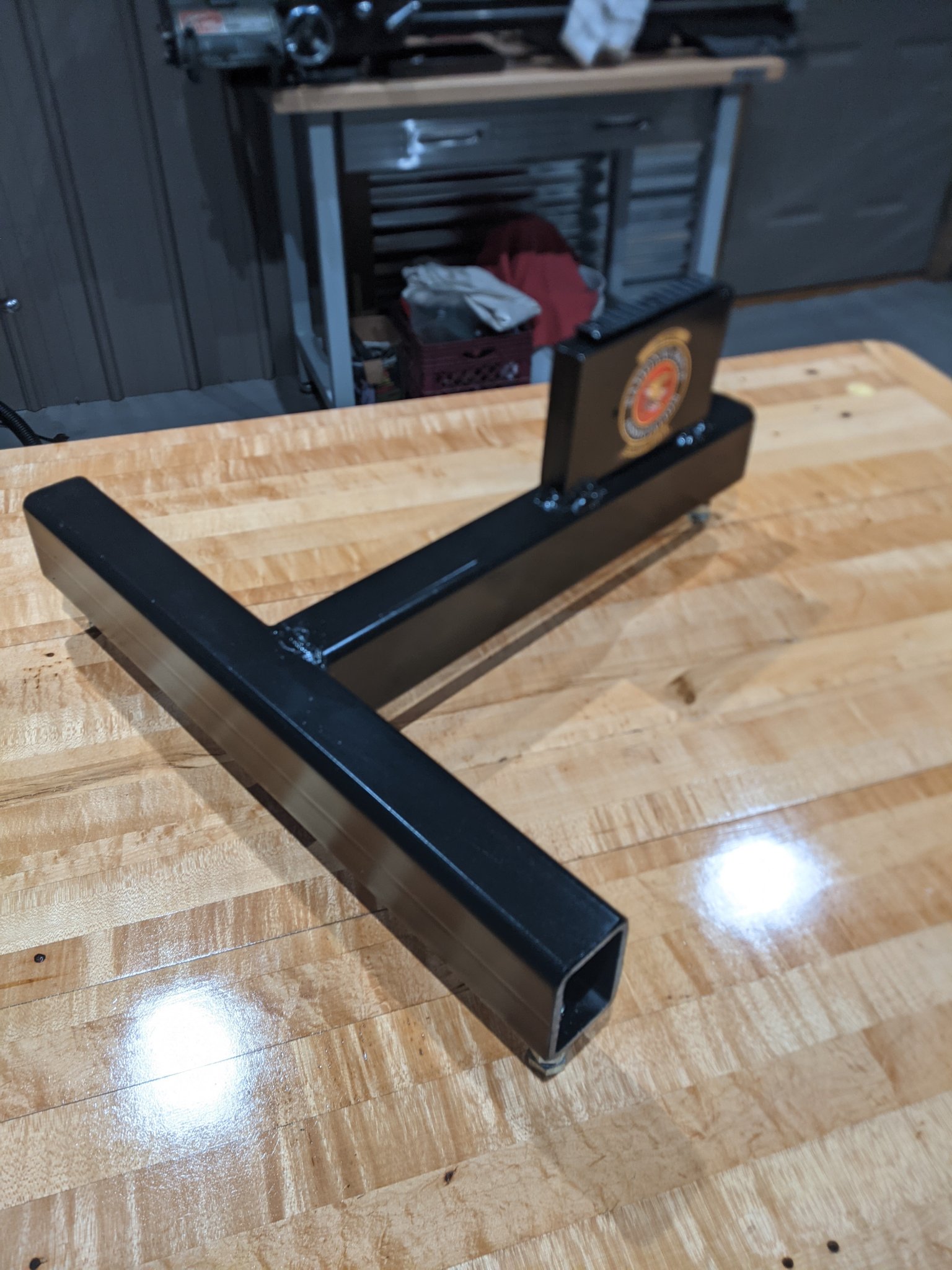

I'm building a fixture to test a scope for tracking ( a well talked about topic on this forum ) a feature that I have planned is the addition of recoil testing for zero shift while in the fixture. I am a brand ambassador for an optics manufacturer so this fixture will be able to really put some heavy recoil on test models. I'll post pics when the fixture is powder coated and filled...
Reactions: theLBC and ken226
Yes I finished the fixture base ( it's heavy) with scope rail and adjustable pegs. I am having some design issues with the recoil release trigger. Then as it always goes I am currently side tracked with a Cartridge front ignition project.
The idea is to install a plunger rod with spring and rear stop. you will push the rod into the main tube from the rear compressing a heavy spring into a latch "sear" When triggered the spring will release and slam the rod stop the rear stop effectively duplicating recoil. Like I mentioned some design issues need to be addressed.

Any idea where to source a “frozen” optic?
As some of the other posts have alluded... that's the fly in the ointment. The damn things don't exactly come up for sale very often, and as I found out the hard way, about half the time they have some sort of weird mounting setup like a dovetail rail, etc.
The other rub is that you kind of need a higher magnification version (36x or above was recommended to me) to be able to really see the movement (or not, if you're lucky). The first few I came across were 24x, and didn't work all that great for this purpose.
That said... I've heard that it can often work with a good fixed power target scope in lieu of a truly frozen scope.
Hi folks. Perhaps a dumb question: I have never heard of a frozen scope. What is it, and what is it used for?
The Field and Cave fixture looked pretty interesting. Nice work.
i think you want to test impact (recoil) in both directions, for scar rifles or people that mount their scopes backwards. :giggle:
Modern scopes have internal adjustments, with springs opposite the adjustment turrets. In theory, any shock to the system can potentially result in a slight movement of the internal lens cell, which is held in place by those springs. Any deviation, however slight, on the part of the springs to return the internals to the same point can manifest as a moving POI relative to POA.
Frozen scopes are where enterprising BR folks, in pursuit of the ultimate precision, take a fixed power target scope, and remove the turrets and springs and fix the internal cell in place. They then fabricate an external mount setup to facilitate holding / aiming the optic. The rear mount may have a set of precision micrometers, with locking screws opposite them. You unsecure the locking screws, make the adjustments, and re-secure the screws. The optic is held completely fixed or 'frozen' during the actual firing, with no opportunity for internal movement
