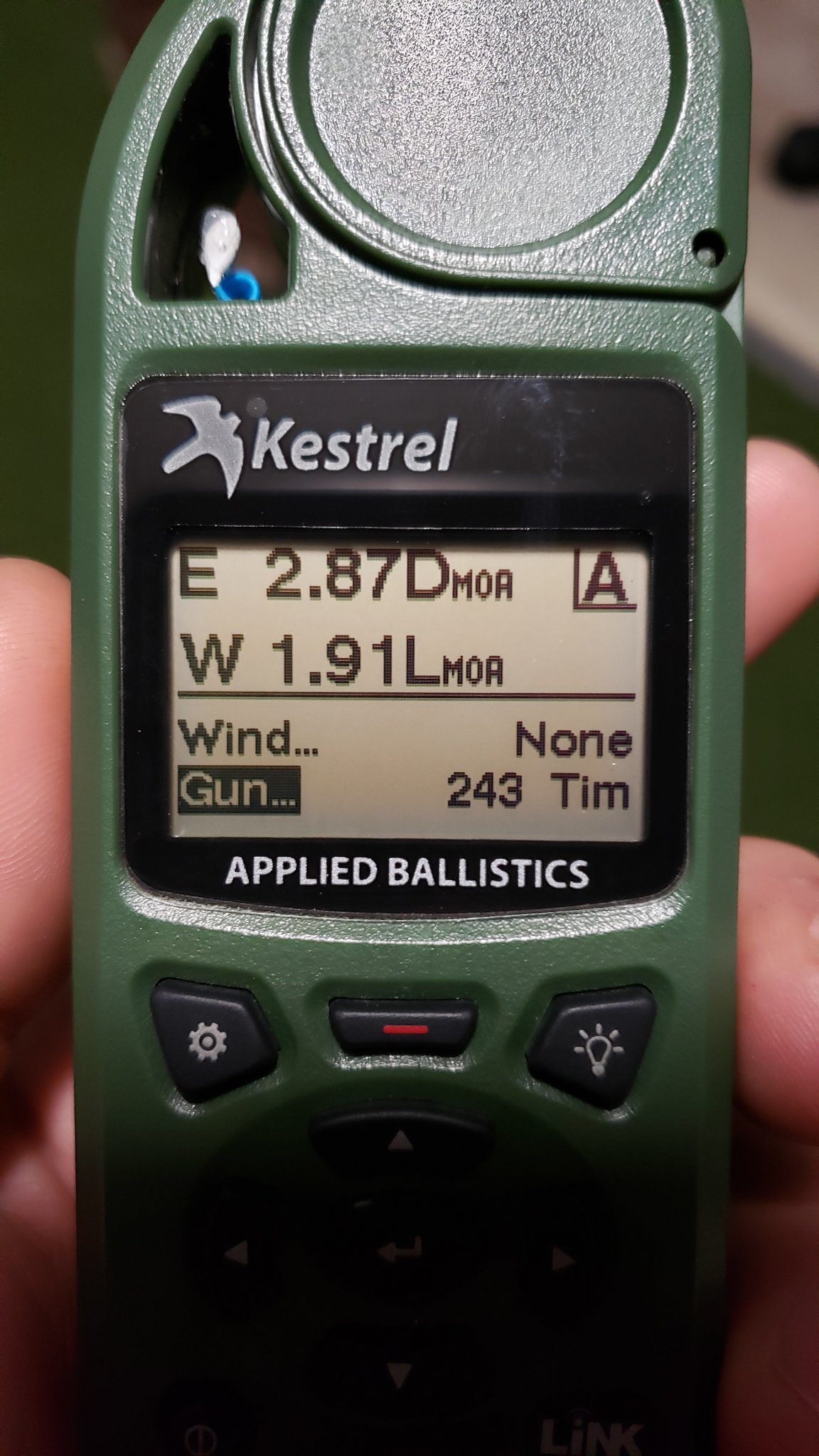

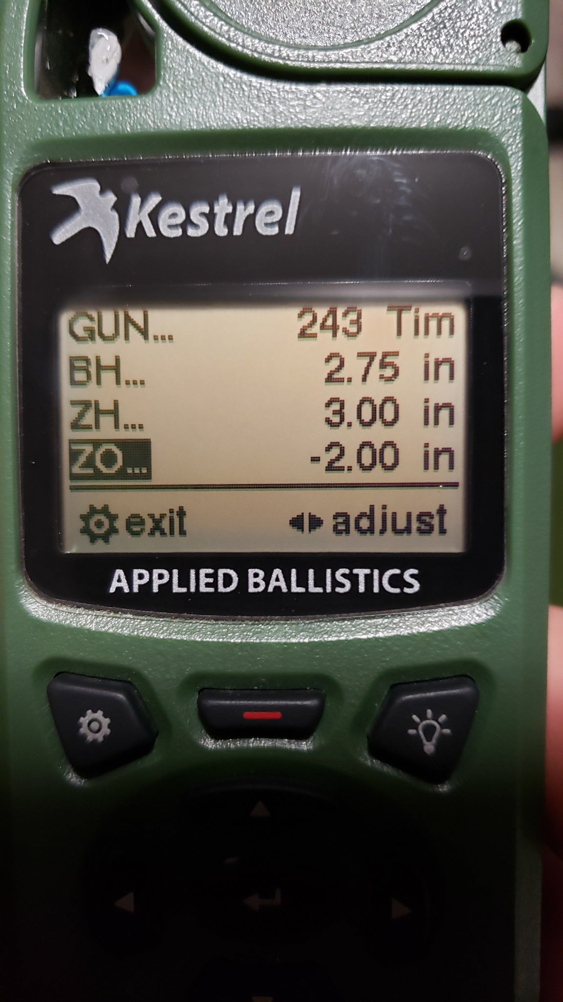

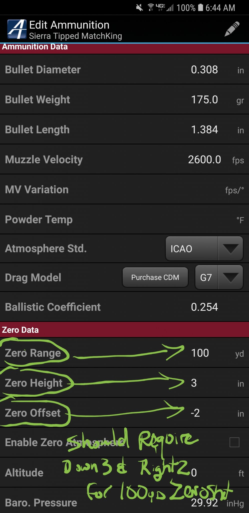

I just entered data similar to yours (albeit in inches and MOA solution) and have posted result below.
If UP and Right values are positive and Low/Left values are negative, a +3 height and -2 offset means impacting 3 inches high, 2 inches left of POA. My solution for 100yd shot should be ~ -3MOA (down) and +2 MOA to right.

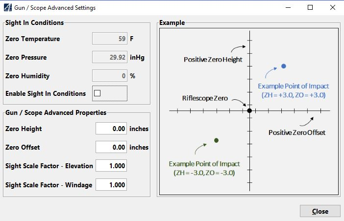

According to AB directions on website:
I tested in Kestrel also with same result:

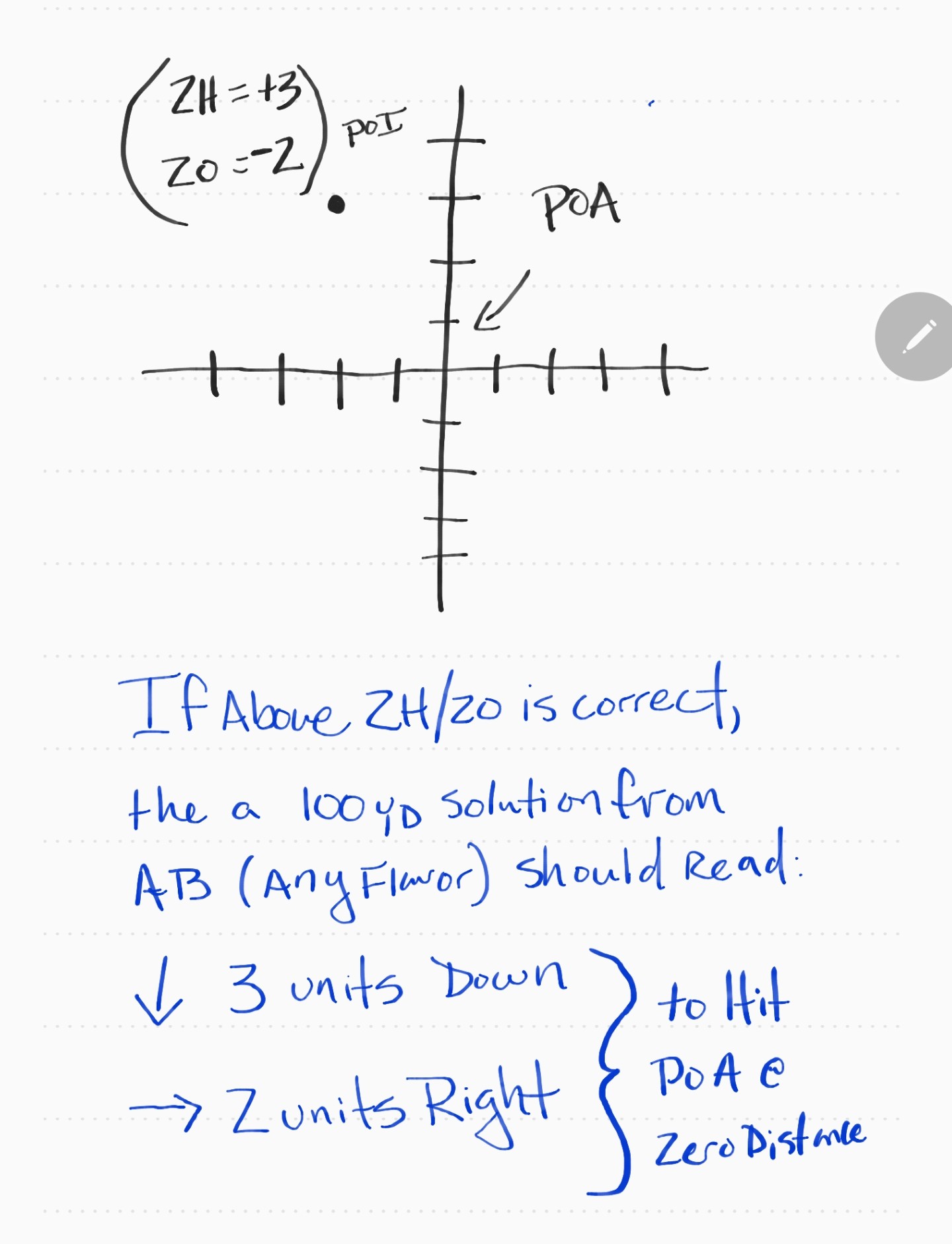

@DocUSMCRetired , can you explain why -2 offset (which refers to 2 inches left in my brain and according to instructions) produces the opposite solution? This should say dial RIGHT ~ 1.75 MOA not left; the solution is backwards; Pretty sure this is a bug.
Could this be related to why @fmjfirearms isn't getting his Garmin to display correct zero solution?
Correct except the windage solution provided by the software is INCORRECT for even zero wind. A -2 inch offset (left 2") should result in a solution that includes ~+2R (dial right ~2 MOA to hit target)...
Did you see the photos showing the reverse? Solution calls for additional Left dial when it should show Right dial. Correct?
