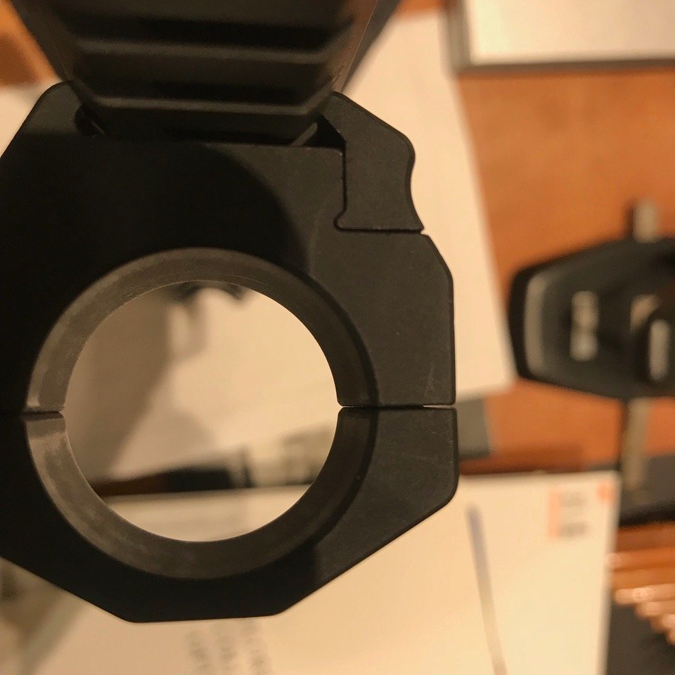

I have a bushnell dmr that seems to shift zero when the gun is jostled around. It will hold groups and track out to 1000 and back. The issue lies in transporting the scope, or just picking it up and bouncing the gun off the butt. Then the zero shifts 2" vertical and 1/2" horizontal. I have tested it on 2 guns. Seems repeatable. I have tested the same guns with an 2 other scopes, and it does not seem to happen. I switched the rings, and it seems to be the same.
Now for the dilemma. I sent it to bushnell and they sent it back saying there was no issue. I do not know if they misunderstood, or if i missed something. Ideas?
What kind of bases and rings are you using? I've seen this kind of stuff happen when the recoilkey of the ring was not engaging the base consistently.
ILya
Seekins/ vortex rings and utg pro rings. I shot it in both sets of rings. on a custom .280 ai and a .243. I was moving on both guns. The only thing i can think is maybe i am not getting the same body position everytime, except i dont have the issue with my other scopes. It does not shift if i shoot, then get up and move around, then shoot again. It only seems to be when jostled. But i will check the ring mount, maybe they are not getting good contact on the rail.
When you mount the scope on the rail, do you make sure that the rings are pushed all the way back to make contact with the base? the rear flat of the recoil lug inside a cross lot has to make contact with the front flat of the rail.
I have not used UTG Pro rings, but I have a fair amount of mileage with Seekins rings and they work well.
It is really weird if it shifts when you move the gun, but does not shift under recoil. It is possible that it is the scope, but it does not sound likely.
ILya
ILya
Maybe I misunderstood your post but to clarify. Rings should be pushed forward so the front of the bar contacts the rear of the rail. This helps prevent movement under the time of most stress, which is recoil. Newton’s 1st law.
Or maybe I’ve been wrong from day one.
Reactions: lancetkenyon
You are correct. I was thinking one thing and typing another.
I would also pull your rings and check the crossbar on the underside of the clamp for impact marks. I just had a new set of Vortex PMR rings which are Seekins rings with the Vortex name on them, and a new Vortex AMG that was having unexplained shifts in POI. I sent them back to Scott Parks at Vortex and the scope checked out perfectly but the rings were out of spec. The aluminum ring side of the clamp to the rail was fat so when the torx screws were tightened, the clamp was clamped to the aluminum ring and not transferring force to clamp to the picatinny rail. Only one ring of the pair had this problem but it was enough that my scope was not holding zero. It would be fine for a while then for no reason would shift.
