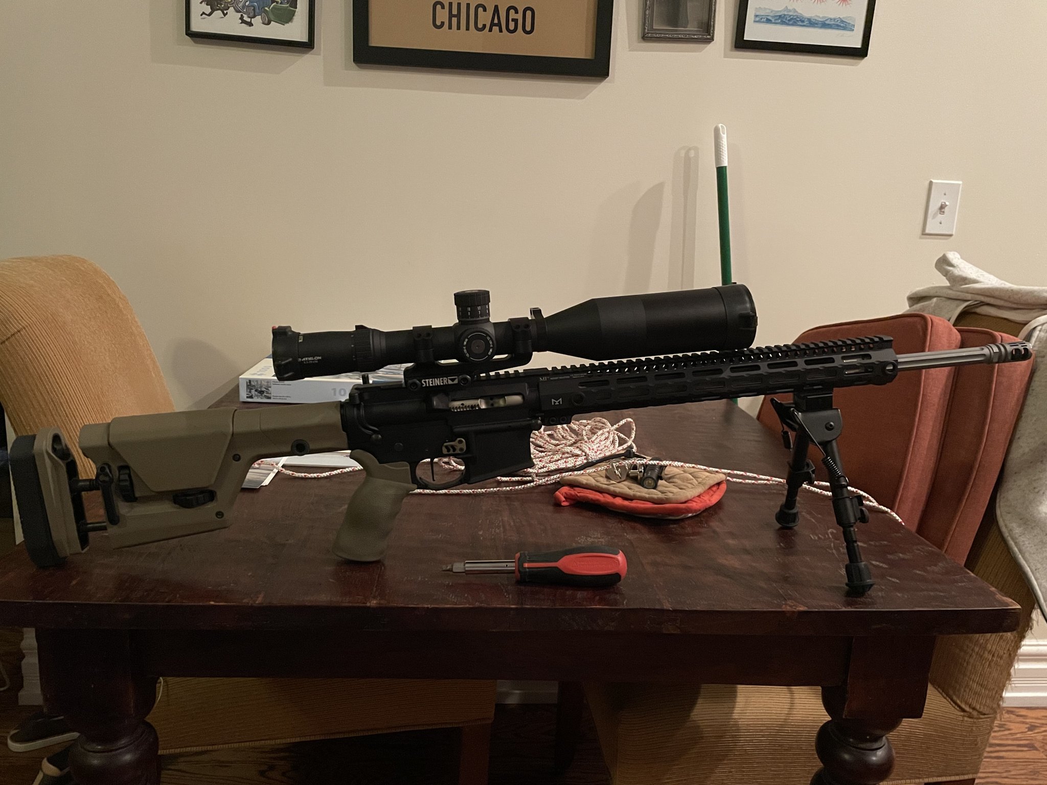

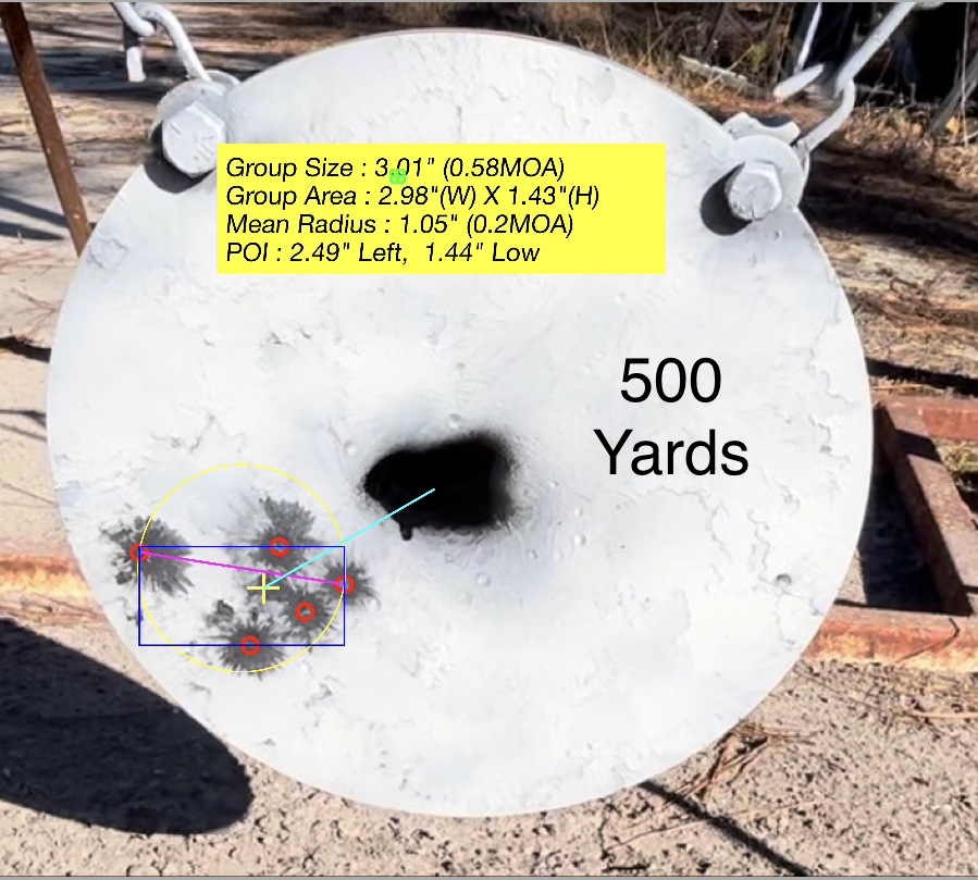

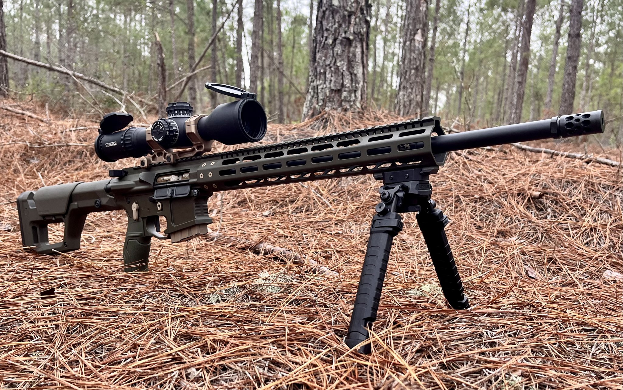

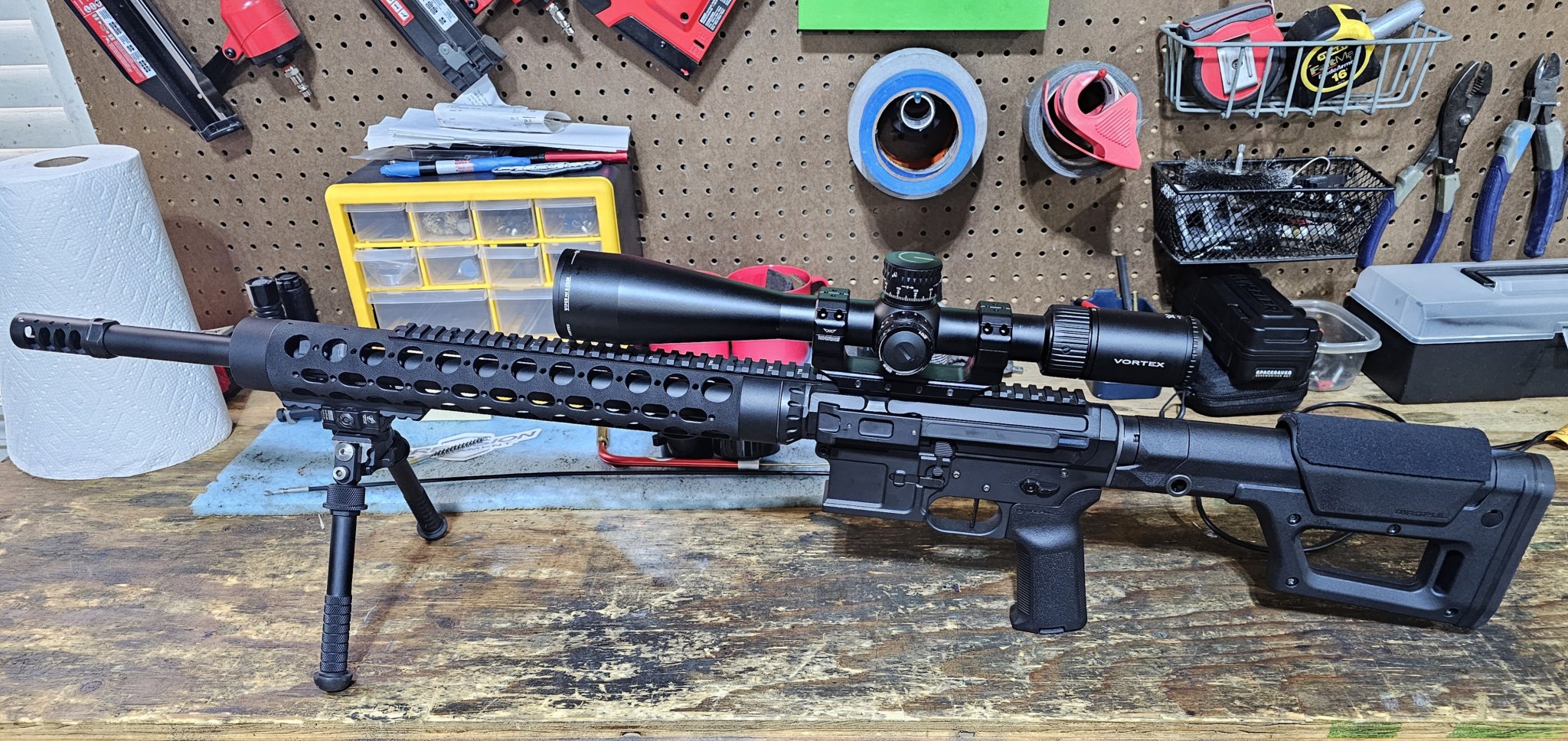

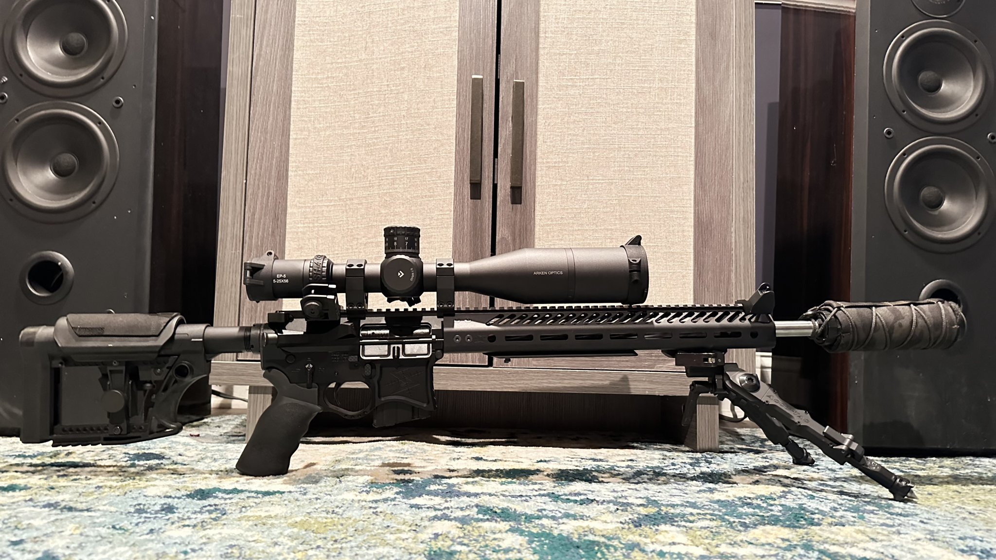

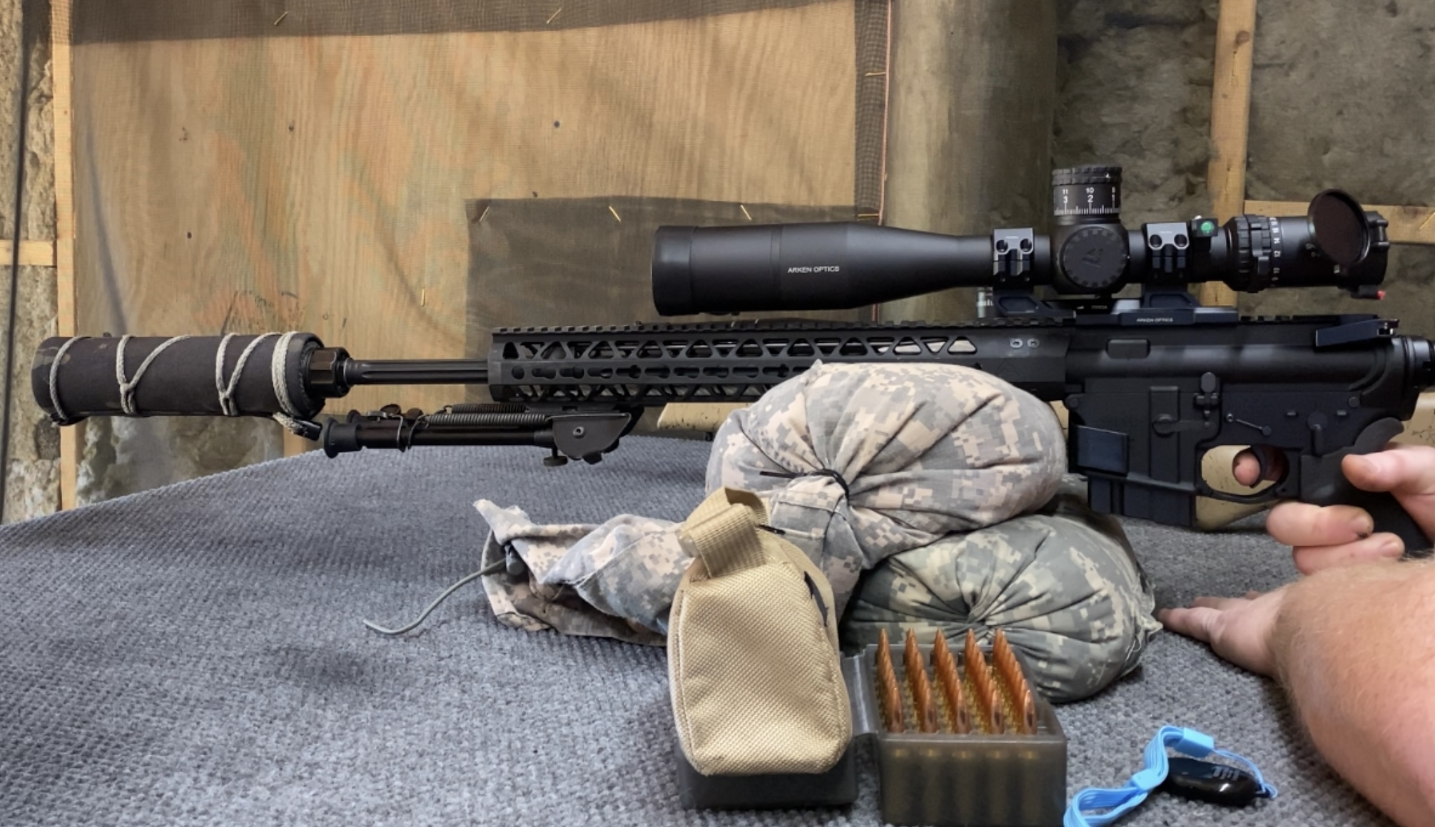

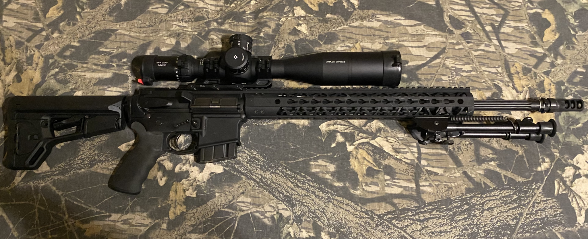

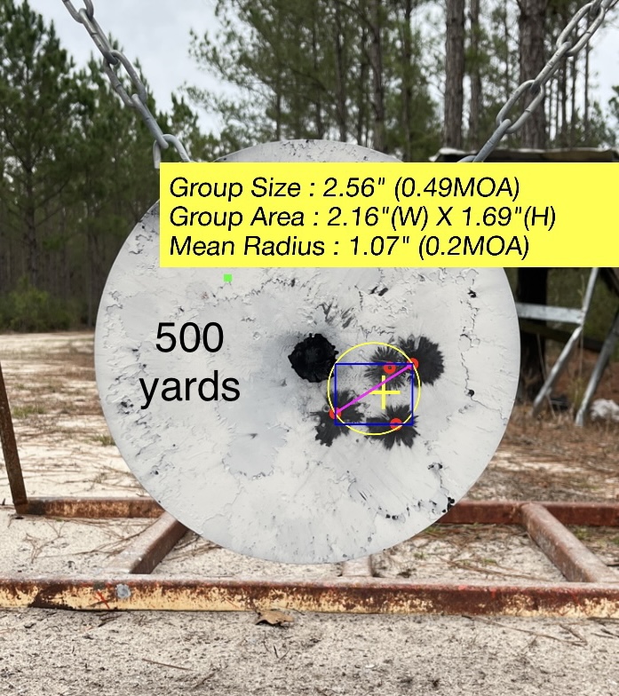

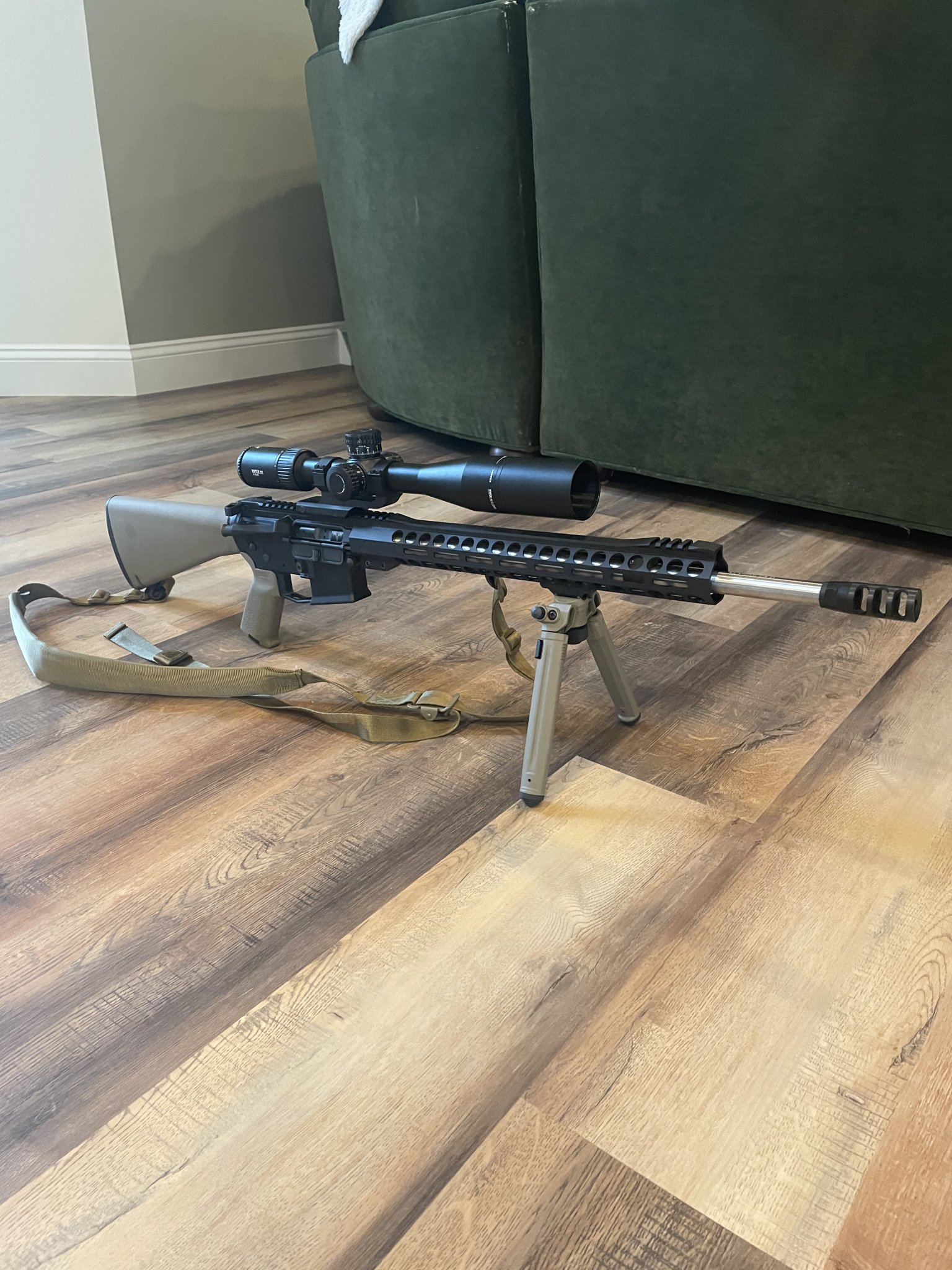

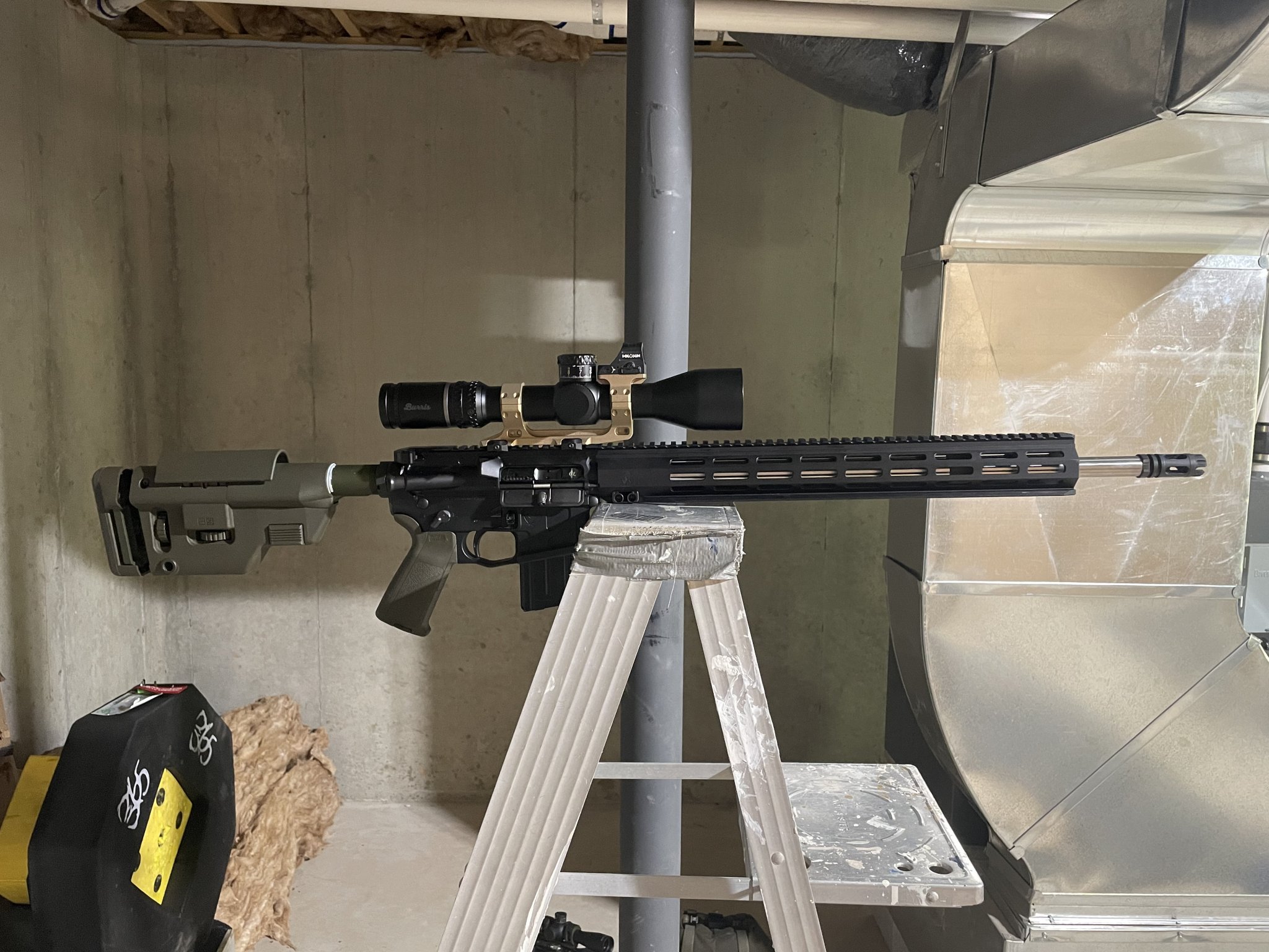

Scoped 20" AR pictures
6.5 Grendel 20”
Reactions: jLorenzo and simonp
Awesome. That first one is close to what I'm going for.

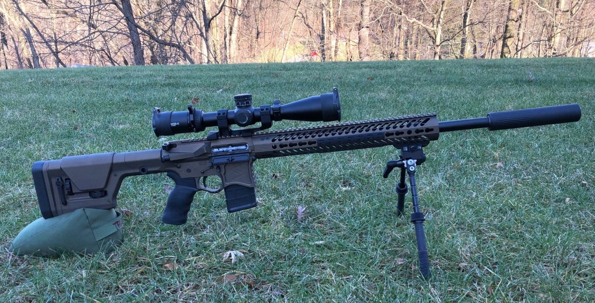

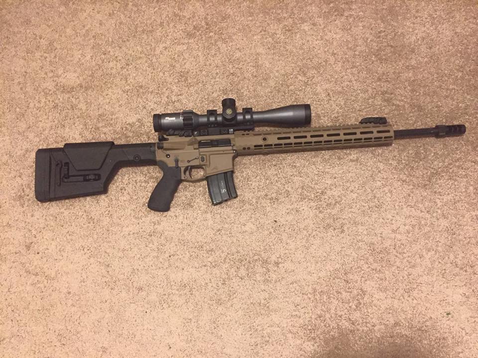

Wilson combat SS 20" on bottom. Haven't taken it past 100 yet. Hammers 69 smk under an inch. Will take it to 1000 on steel this weekend for the real test.
I say go 20"
If I need a rifle for maneuvering I'll grab a shorter one. And it's really not unwieldy
