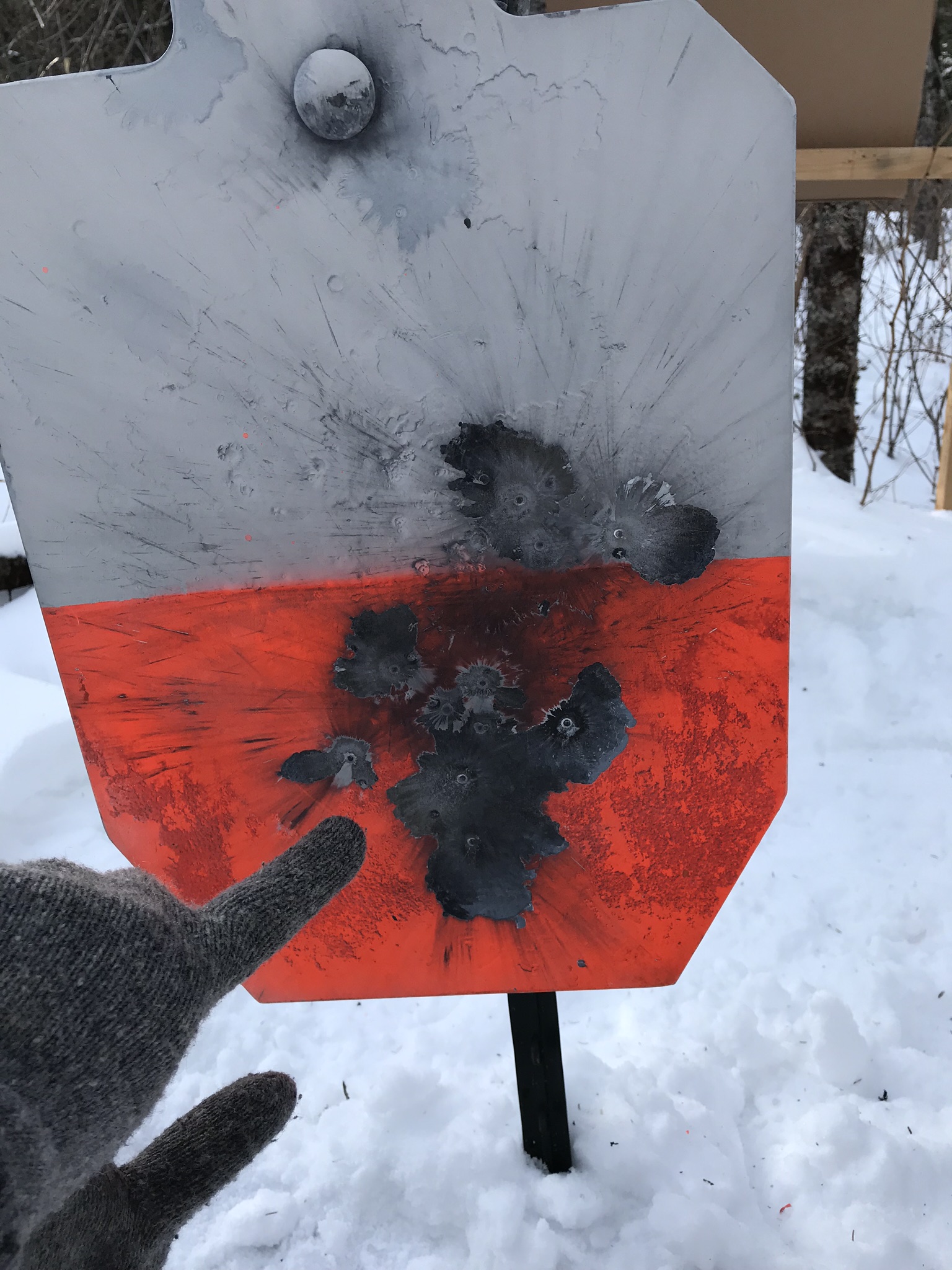

Meh. Groups were nothing spectacular. As per the Diopter thread, about 2 3/4” at 100yds using the v-notch rear, a sitting rest, 56yr old eyes and Herter’s ammo. I’m sure It could do better with some handloads, but using that rear sight is a young man’s game. Diopters or peeps are in order. Lederhosen shall be optional.

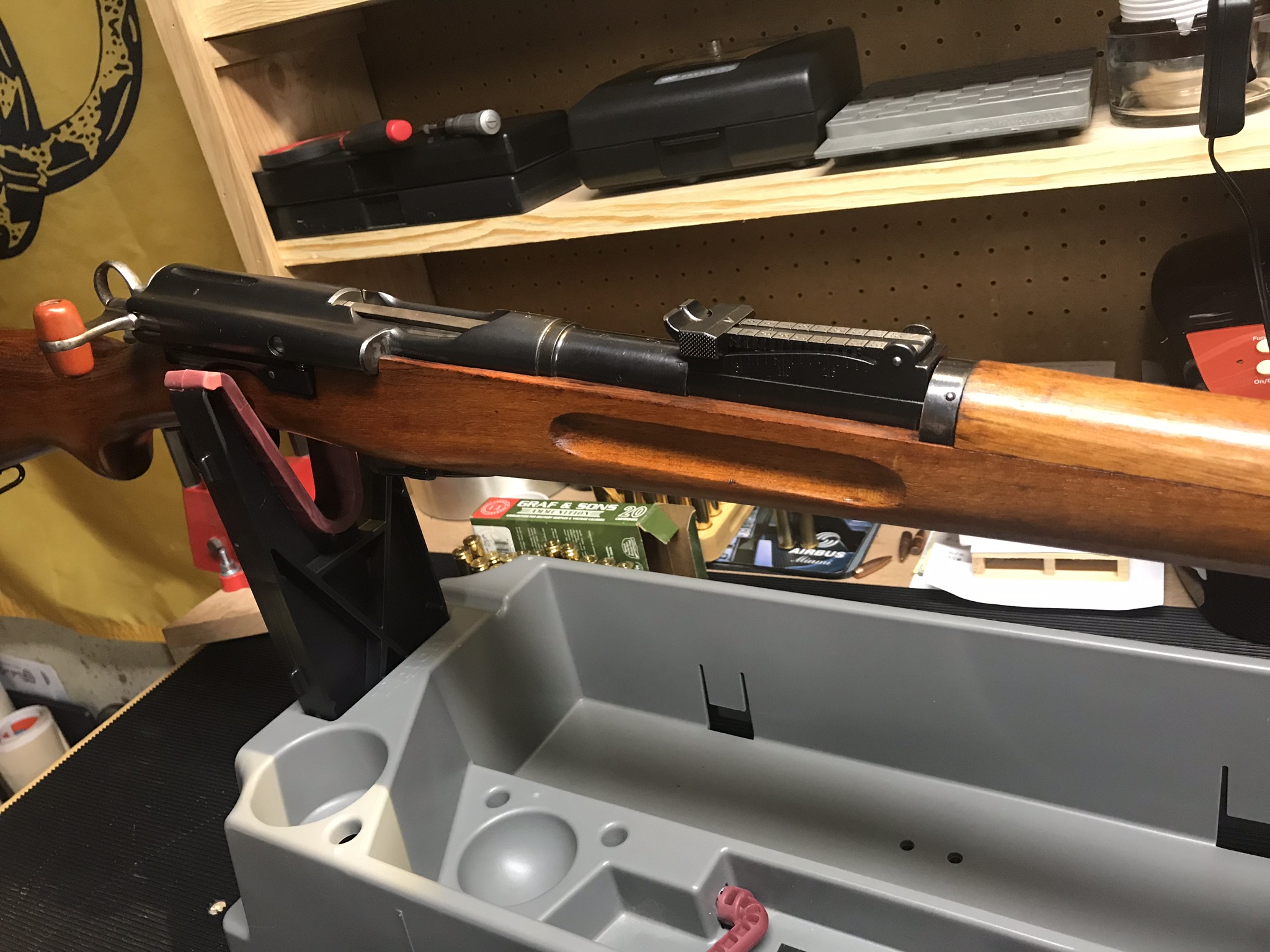

Note to self: Don’t expect stock to rub iinseed oil on itself for two weeks.
Barrel cleaned with PatchOut. A bit of blue, some brown carbon, but nothing like other milsurps I’ve cleaned. Two applications and it was clean. Probably could have left it at one application. Inside of receiver soaking in foam. A few more coats on the stock, and it will go back together tomorrow.
Dies, PPU brass sitting on bench. Search begins for some RL15 data for the 175smk and the 165 PSPCL.
Pics when its back together. Sights to follow.
I meant to type “RL17”. This is why I stay far away from sharp instuments for a day or two when I return from being on the road....?‍♂️
Rifle reassembled. Action screws torqued to 30in/lb which seems resonable. Tang screw is less. Barrel free within stock and collar. I will continue the linseed oil in the weeks ahead.

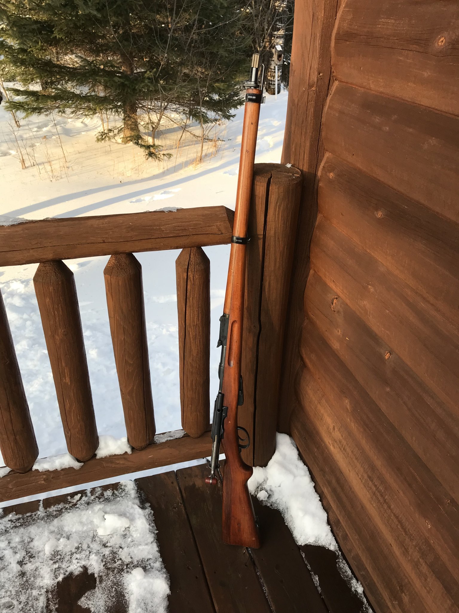

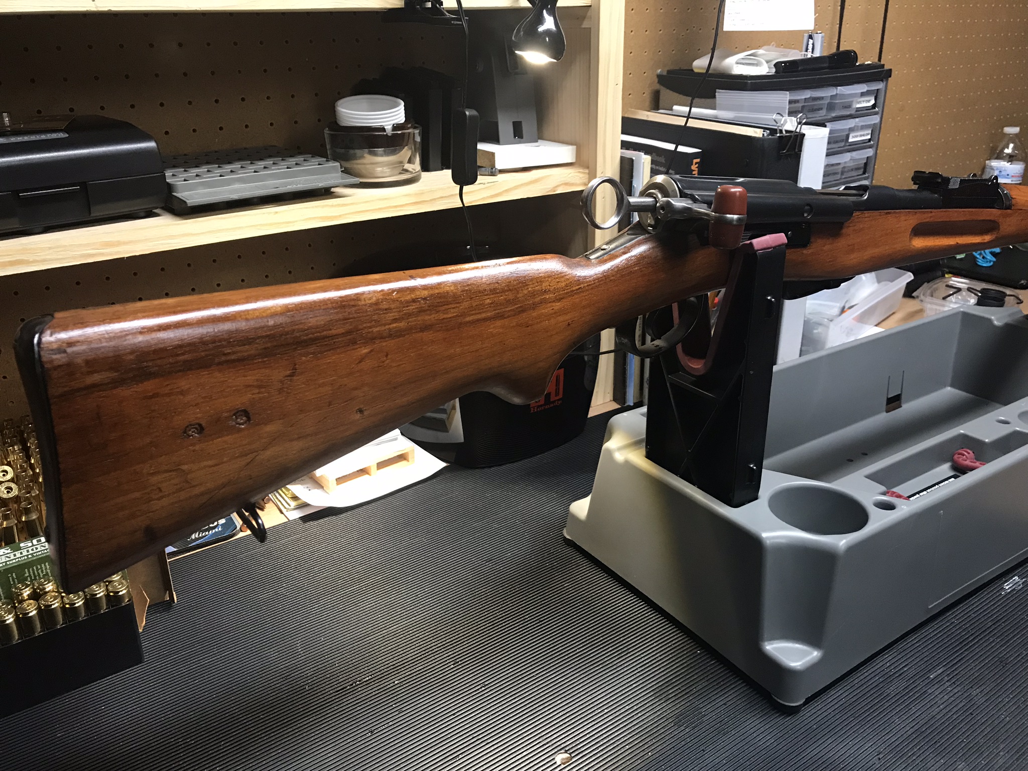

Gorgeous rifle! The sharp edges of the butt stock and particularly the finger grooves tell me that it's not been refinished. The double cartouche tells me that the armoury may have been involved after original issue.
Is there anything stamped on the tang?

Thanks for the kind words on the rifle. No, there are no stampings on the tang. There is a “armory thru” stamp on the receiver of “33”. Is this the reason perhaps for the double stock cartouche?

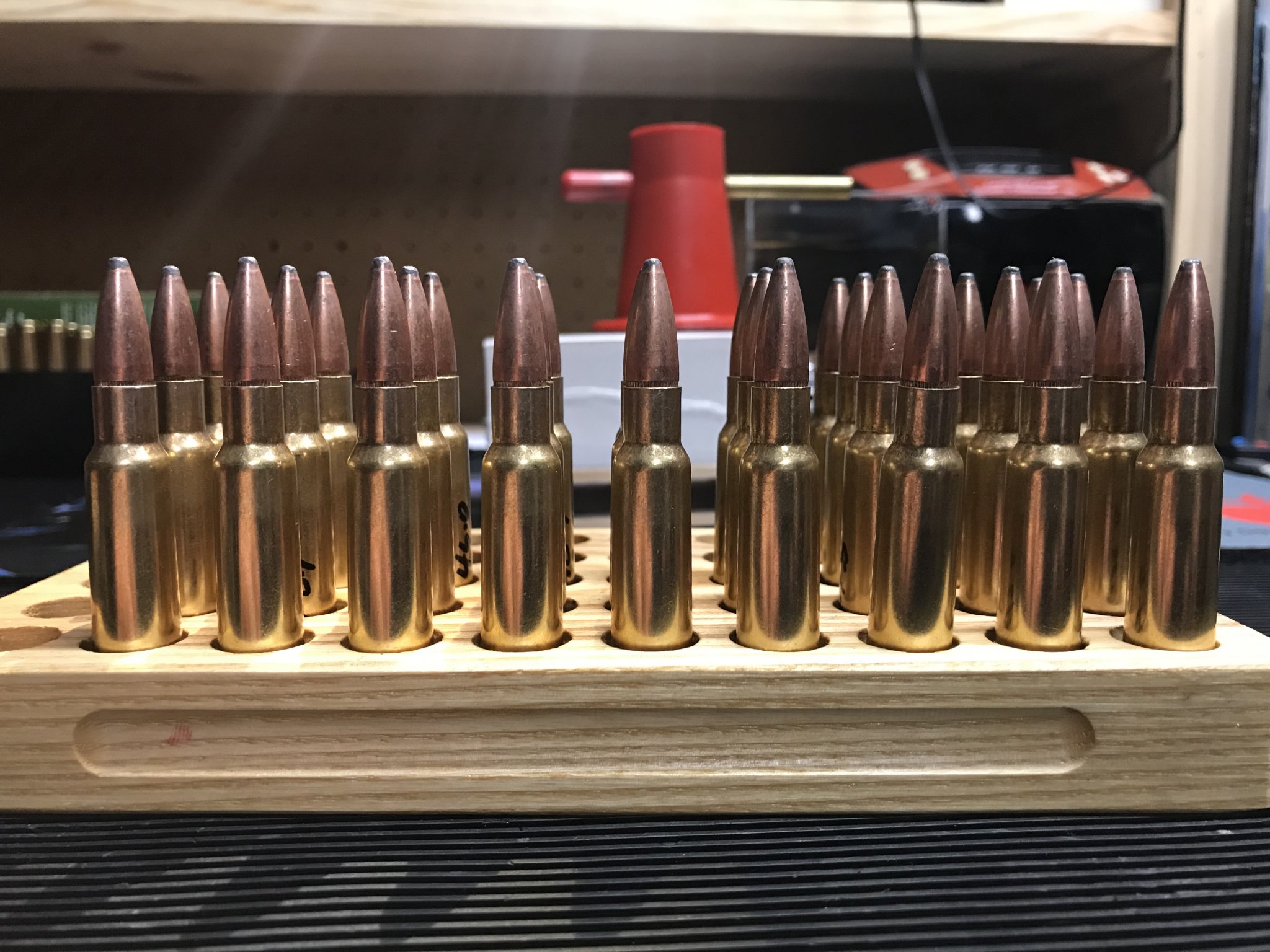

Loaded up a spread using IMR4350 and the 165gr Remingtons. Weather going down the tubes next few days. Range time is questionalble. Maybe have the case back from Hornady and some 175gr SMKs loaded by then. Have some 168 & 178gr AMAX on the shelves that the .308 bolt gun didn’t like. Maybe give those a whirl too.
