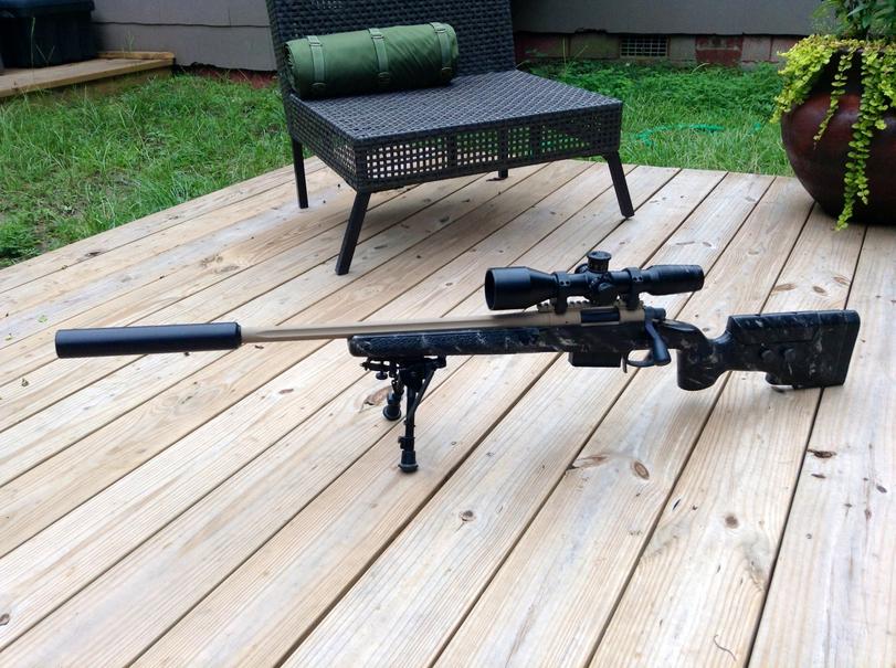

Just got my 700P LTR back from Russell at Scout Supply Co. This is the 4th rifle Russell has tuned up for me and I can't wait until I get back home from work and have a chance to shoot it! It is a lefty 700P LTR in .308. Russell tuned up the action, threaded and rechambered the barrel with a match reamer, he bedded the action in a McMillan A5 with Badger bottom metal, coated the bolt with microslick, added a badger knob, and painted the action to match the tan in the stock. The rig fully dressed out with scope and suppressor weighs in at just under 14lbs and is extremely well balanced. It is topped with a Hensoldt 3-12x56mm scope.

Very nice looking package. I am curious as to how/when you came across the LH 700P. Sounds like you had acquired it and sent it off to Scout Supply. I have been looking all over the net and in the LGS's for a LH Remington 308. Scout Supply certainly has been getting good reviews from Hide members. Congratulations on a nice build!
I found it on snipercountrypx.com in March. I didn't know they existed either so when I saw it I grabbed it! Russell really does a great job, I highly recommend him!

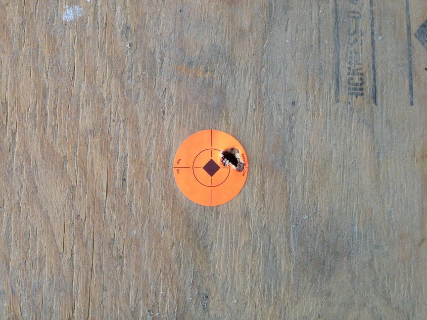

First group of hand loads out of the rifle! 178 AMAXs over H4895 in new Lapua brass with CCI BR-2. Sadly, this was a random load I made up just to use the last five pieces of new brass I had....I know what combo to play with now though! Strangely, this gun does not seem to like 168 FGMM. I shot a box thru it yesterday and the best group wasn't nearly as good as the one pictured. Even before Russell worked on the gun, I was never able to find a SMK load it would shoot well. I do have some H4895/175 SMK loads to try today.

My 308 really liked 175gr SMK with 43.5 -44.5 hrs of Varget with 44.0gr shooting the best. Fed 210 primers and Lapua brass. Running 2725fps out of a factory 24" 5r. Never could find a consistent load with H4895 for it.
