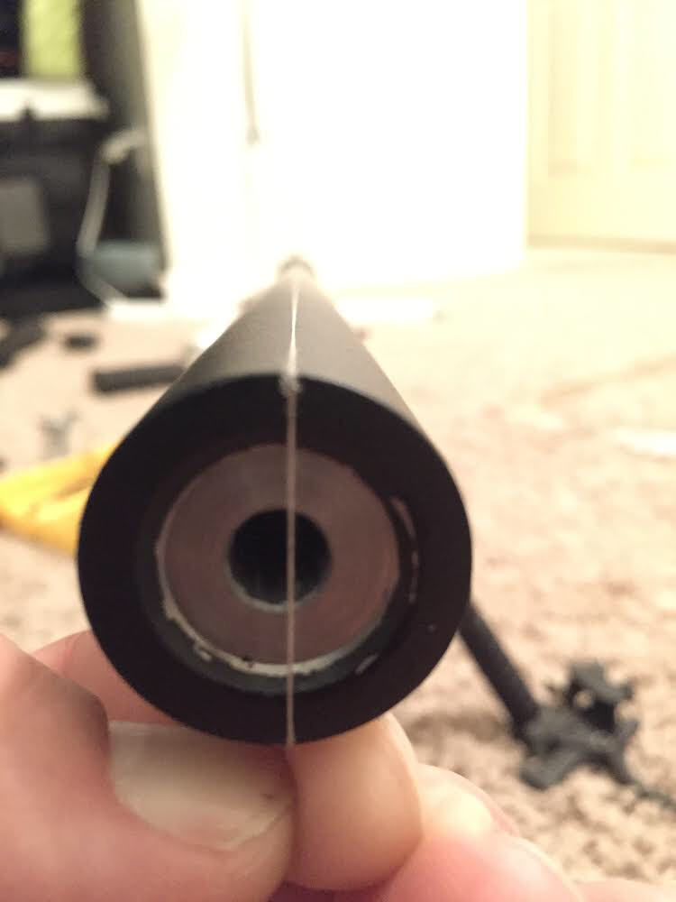

Take a string and tie it around a screw in the back scope base hole. Then pull the string really right and fold it over the very center of the barrel(over the hole in the end of the barrel) Be sure the string is centered on the back scope base hole. This will quickly tell you if everything is lined up. You may have to do it a few times and you will start to see where the string really lands. It is easiest to do this with the rifle butt on the ground, looking straight at the barrel. Make sure your firearm is unloaded....

its funny you mention this cause i was talking with a friend to see how to remotely check if it is the rifle. i have a video of a piece of twine inserted in the rear scope mounting hole and stretched to the end of the barrel. everything seems straight. i will i could upload it.
ill take a look

It’s kind of a tricky thing to do and get right. You have to make sure when you reach the end and fold the string down over the muzzle you are dead center. It’s easy to cheat it accidentally and line it up with the scope holes rather than true center of the bore. We are talking millimeters which can be hard to deal with considering you are using your eye and stretching a string.
Yeah your probably right. Let’s see what zeiss says. I think I will call mid week just to see. I hate to be that guy but I just might. I am truly wondering if it is the rifle now
You can also pull the string very tight lines up perfectly with the scope base holes, then press it right at the end of the barrel and fold it over the muzzle and see if it is centered over the muzzle. You have to be very careful to fold the string exactly 90 degrees over the muzzle though to get an accurate picture. If it is off it will look like this.
You can see though, all I would have to do is move the string 3mm left and it would look centered. It helps if you don’t look at the muzzle when folding it over, just make sure you are folding it straight down by looking down the string. Once you do that, look to see if it is centered over the bore. It helps to use a really thin string too.
so how can someone test to see if everything is aligned on the rifle?
That is how I do it. I suppose gunsmiths have some way of doing if. I guess if you had one of those laser throwers that will project a laser you could point it lined up with the scope base holes and see if it falls in line with the bore hole at the end of the muzzle.
