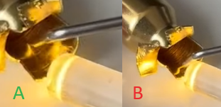

Hi,

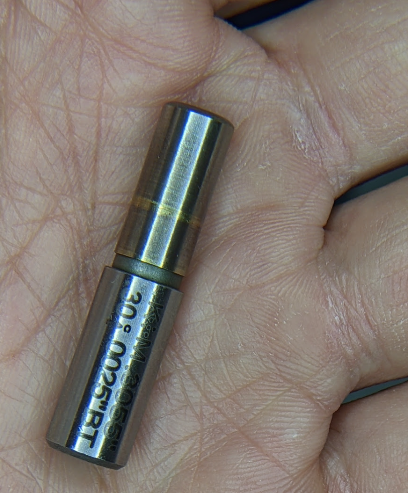

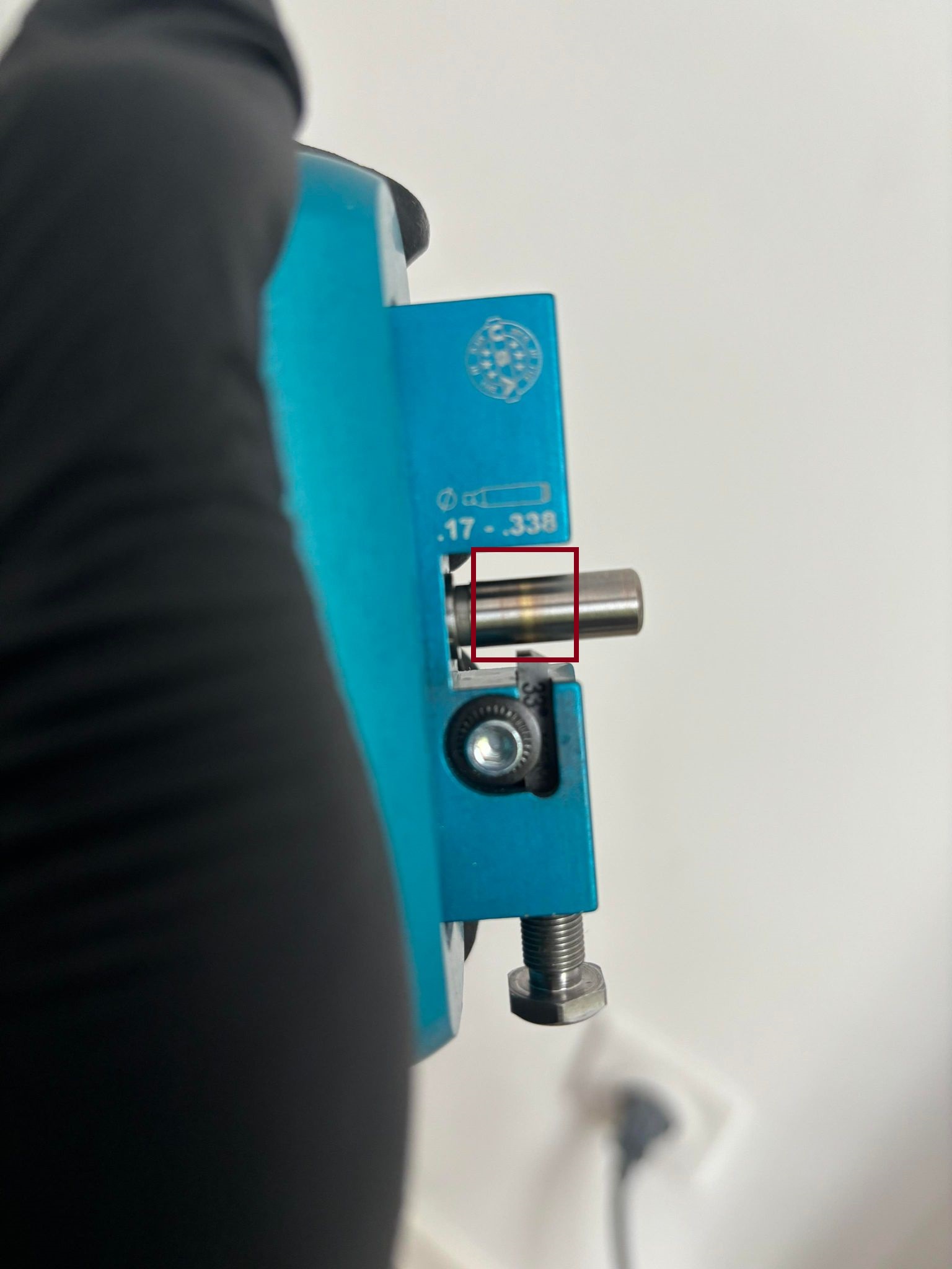

First time neck turner here. I'm using the K&M Neck Turning tool with 6.5 Creedmoor Lapua cases (LR primers).
I started with a big mistake: didn't lube enough and a ring of brass formed on the pilot (see on the picture below):
This caused deep scratches/grooves to form INSIDE the necks of the cases (I did 50 before noticing it...). On the video below you can see and hear the scratches:
I put the pilot in copper remover for a few hours and the golden ring completely disappeared.
I thought I fixed the issue for good, but now, even when using lots of lube (Redding Imperial Sizing Die Wax), there are light scratches (this time not deep, you can't/can barely feel them) but still, there are scratches...
Is this "normal" or should the inside of the neck be 100% free of any scratches? Did you ever experience this issue? What lube do you use to turn necks?

For reference, here's a pic of one of my pilots after neck turning 400 pieces of virgin brass, expanded using a .0025 mandrel + using .0025 pilot.

A few tips -
1. Apply the the sizing wax to both the inside case neck and the neck turn pilot.
2. Keep a little brush with the neck turn kit and brush the turner pilot and cutter every so often (it depends on how much you turn and how much brass particles there are) brush the turner clean.
3. if you're using the steel pilot (as opposed to the carbide pilot), don't let the pilot get hot if you're neck turning with the power adapter (especially if you're turning at "high" speed). If the pilot starts to feel warm. Stop, let it cool down. While it's cooling down, brush as much of the brass particles/bits away, wipe the pilot with a clean paper towel. Reapply a thin layer of the Redding Imperial sizing wax onto the pilot.
4. Keep the neck ID and turning pilot as close in diameter as possible. Example, You wouldn't want the turning pilot to be 0.001" larger in diameter than what you expanded the neck to. It would add extra friction.
Get a better lube. Sizing die wax is made for... sizing dies, not dealing with high speed rotary friction. Yes, it can work... until it doesn't. Sinclair / Brownell's used to sell a cutting oil that worked well, but was messy as hell and a right PITA to clean off. PMA and 21st Century both sell lubes specifically for neck turning. Of the two, I'm currently using the Delta Carbon No-Oil from 21st Century.
As mentioned... lube the insides of the case necks initially, then apply lube to the turning mandrel in between every case or two. Too much is better than not enough, in this case. Keep a chip/acid brush handy to clear away debris. Assuming you are using a variable speed drill, do not use it on the 'high speed' setting. If you're turning a larger batch, put some ice in a ziploc baggie, and set it in a bowl. When you set the turner down to change cases, set it on top of the baggie of ice. That's all it really takes to keep it cool, IME.
Whatever you're doing, you're burning off whatever lube you managed to get inside the necks / on the mandrel, which is causing it to heat up and gall. More lube, less speed.
And polished to 500 grit? You probably just ruined both. Order new.

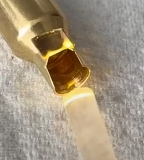

Update!
I received the new K&M steel pilot today. I hand-turned (didn't use the drill this time) very slowly, barely pushing the handle, tried with cutting oil (inside and outside), then with Redding Imperial Bio-Green case lube (inside and outside)... same as before. There are light scratches. At the case mouth I can't feel them, but close to the shoulder I can feel them.
At this point I'm not sure if it's expected or if it's wrong then what's wrong...
Do you guys have this kind of scratches inside your cases necks? I did a new video below.
EDIT: I tried to "turn" the necks without touching the cutter (stopping before touching the cutter). I put the case onto the lubricated pilot, turn it (by hand) a few turns and then check. Well... scratches are already there. And it's a brand new pilot. No signs of any scratches after the mandrel expander step, they appear after turning onto the pilot. So are K&M pilot just bad or is this expected?

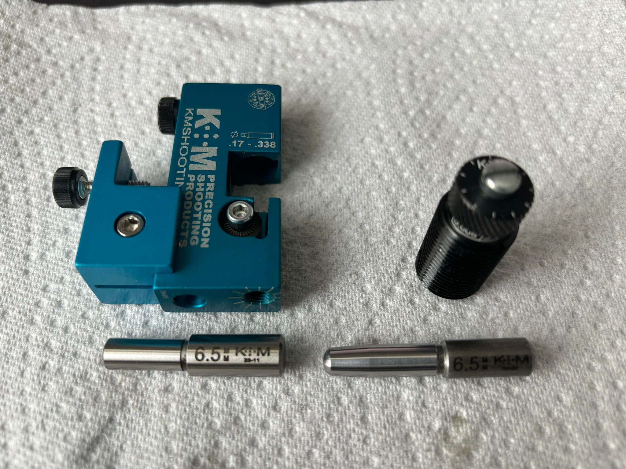

Take and a pic of both the expander mandrel and pilot (remove them from the turner and die body), would like to see the laser marking.
If you have a micrometer, measure the diameter of the pilot and the mandrel, within 0.0001"
Edit - excluding the section closest to the case mouth, the rest looks like what I normally see. Which is like the one random scratch ring in the middle of the neck.
The small numbers on the pilot are "23-11" and "23-04" on the expander mandrel if that matters.
I only have a caliper with a resolution of 0.0005" but I got 0.2630" for the pilot and 0.2640" for the expander mandrel. This makes me wonder: the Sinclair neck turning tool pilot is 0.262" and the expander mandrel 0.263" (so 0.001" smaller). Is one of them theoretically better?

I bought a micrometer and measured both:
- Mandrel: 0.2642in
- Pilot: 0.2629in
So I guess it's all good...
