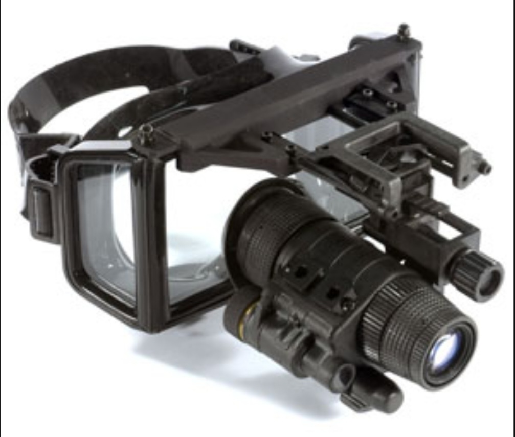

Looking at the specs on the Act in Black DTNVS, it says waterproof to 20 meters (65’) for two hours, I have dived 30-40 feet where visibility is nearly possible and not from the waters being murky,
any one here take a short dive with their night vision ?
The idea has been discussed before, and theoretically it’s possible (special dive masks have even been made for the purpose).
Realistically though, you’d have to be a VERY accomplished diver to manage buoyancy, navigation, gauge checks, etc. with such a narrow field of view and shallow depth of focus.
I’m a rescue diver and do vehicle recovery and construction work in zero visibility conditions and swift water. At my level of experience I wouldn’t be interested in trying it. Task loading is one of the leading contributors to death for experienced divers, and I wouldn’t want the extra task of managing night vision equipment.
Not poopooing the idea, I just don’t imagine the juice will be worth the squeeze.
Probably been tried at high levels but found to not work very well..... if there is no light due to the water or night conditions, there is no light to amplify hence the NV would not work without IR which would probably reflect back and render the NV useless.
