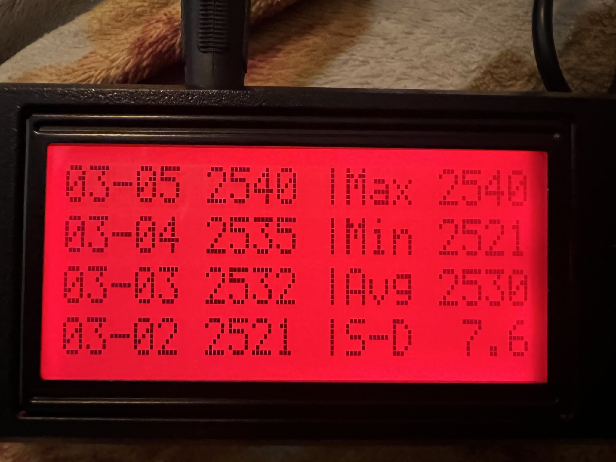

    I dont recall ever having much difficulty getting a single digit SD load. I've been running gas guns in PRS since 2014. Only sporadically lately, but since no one even picked up the Gas Gun trophy at the NW Regional Finale last year, I've cracked out my 6.5 Creed to make sure that doesn't happen again in 2022. Just having fun at the Regional level this year. Seems like a nice gasser is the perfect way to do that..
    My current load with 140gr Matchburners and 41.8grs H4350 is a 6 to 7 SD spread out over about 22 to 25 rounds if I recall.
    It's certainly doable.
    Reactions: RegionRat
    @Jefe's Dope
    Yes, that FGMM M2 is magic in some guns.
    What chamber/bbl are you running?
    With that bullet at 2530, the rig should do well for at least 800 yards and sometimes more. What kind of elevation waterline does your rig hold?

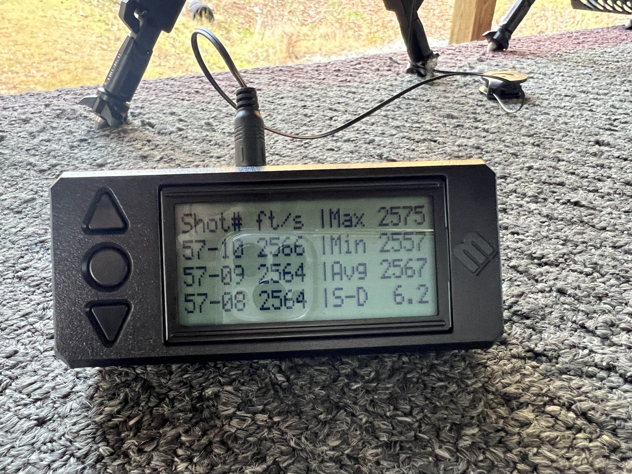

    Interesting ... well ... I get consistent single-digit SD's with my variety of bolt guns in 6.5-CM, 300-WM, 300-PRC, and 338-LM ... so I know I'm capable of quality load development in bolt action rifles. It's this 6.5-CM AR-10 that's kicking my ass ... the closest I can get is 15-ish. I'm not giving up (yet) ... just trying to decide if sub-MOA groups and clean hits at 1,200 yards with 15-ish SD's is a place I should stop and declare victory. Still pondering that one. I did find it interesting that with all other things being equal, the SD's were consistently lower with the gas shut off.
    Not all bullet and powder combinations produce the same results in all rifles. Let me know if there is another combination you want to try that you don't have. I probably have every common powder on the market in my cabinet and I'd be happy to give you whatever you want to try.

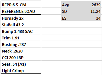

    UPDATE ... I tried a few of the suggestions here. Tweaking a few things has gotten me to an Average of 2639, and a SD of 11.2 ... and nice tight groups. For my AR-10 in 6.5 Creedmoor, I feel like that's "good enough" considering my SD's started in the 20's. I'm declaring victory. Thanks Guys. For anyone that cares ... my "Reference Load" record is below:
    It's a combination of case, bullet, powder, and measurements ... that is my "personal best" that I'll use for competition. If I want to load my very best, I go to my "Reference Load" (which I track on a spreadsheet), and build cartridges to that specification.
    What barrel? How did you arrive at the the 43.2gr mark?
    22" Proof Research carbon fiber barrel on my LWRCI REPR MKII Elite. Arrived at the 43.2gr through starting low, testing up until pressure signs (mostly cratered primers), backing down, and then ladder testing to find a velocity node. 43.2gr gave me the most consistent velocity with speeds above 2600, no pressure signs, and acceptable groups.
