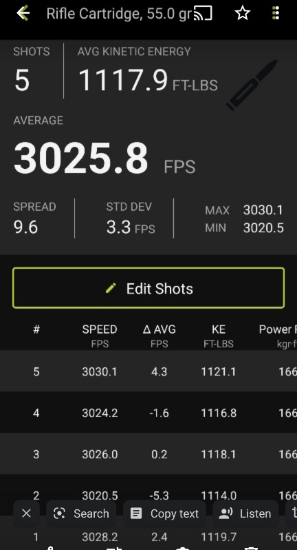

The 223 is a pain in the ass for what it is = frustrating to get low single digit sd's.
Lapua brass, annealed, debur flash hole, trim, wilson collet sizer, sinclair neck mandrel, sw precision trickled with beam scale to the kernel, shot hornady 75 eldm, 80 eldm, and 88 eldm.
I geat stellar accuracy at 100. Good days 1/4" to 1/2". Bad days 1/2" to 3/4" - all for 5 shots. SD's? currently 12 over a 10 shot string.
I like the accuracy, but the sd's suck compared to the effort induced for loading. To achieve both I believe I would have to change to a br based cartridge. Side note - I do get both out of my 6.5 grendel loaded with 123 eldm out of my howa mini. So, I am somewhat competent.
I have read and been told directly case prep is critical for the 223. I just listened to one of Hornady's podcast on load development and in that podcast they state hyper case prep similar to what I listed above produces no noticeable results compared to grab and go. :unsure:

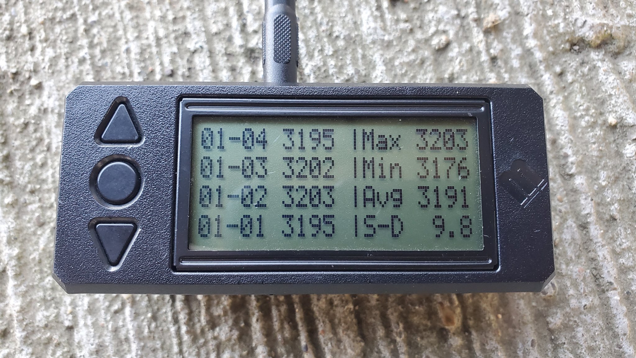

Speaking on the Ackley side, I typically see between 8-11 SDs. Using 90s and N140 has been a solid combo out of my 26" bolt gun. My last load I chronoed:
AB 5.56 brass
Annealed and trimmed
25gr N140
90gr SMK
AVG: 2784
SD: 9
ES: 24
