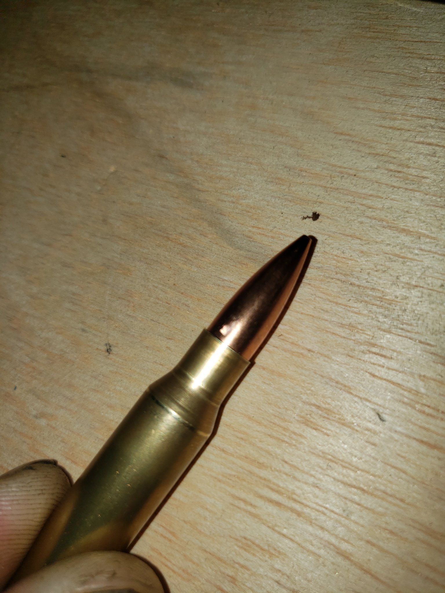

This is what it looks like when seated at 2.800 base to tip of bullet which I believe is what fgmm 175 is. I can see where the rifling is contacting the bullet.
OAL is 2.800
Ok its definitely not right then, you would think off the shelf ammo should be able to shoot out of it with no issues. I'm still waiting on them to get back with me.

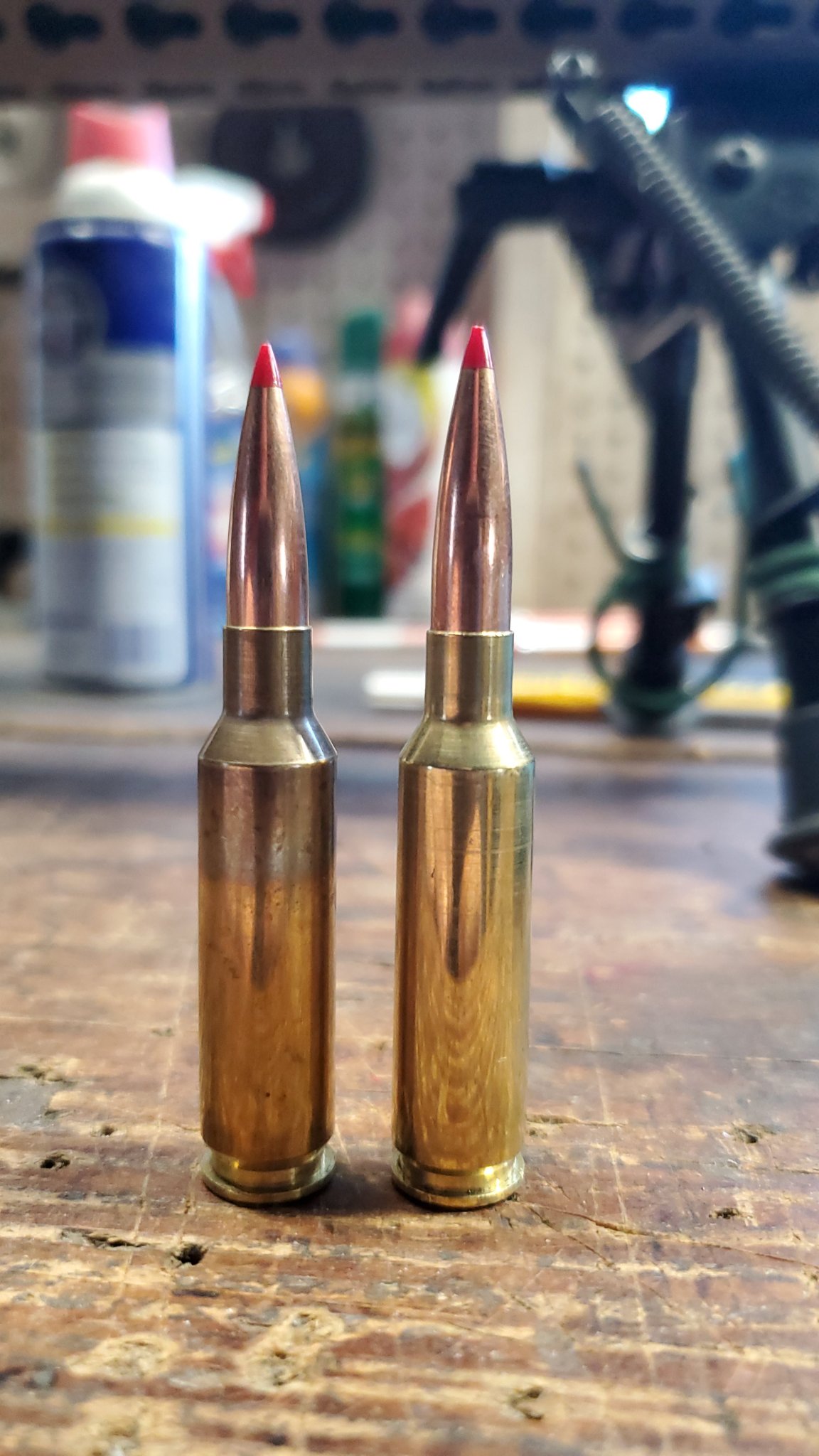

I'm kinda dealing with same thing, after I gave my advice here. I bought a really nice rifle here, built by a reputable smith. 2 6.5creed barrels and both have .100 shorter freebore than the other 7 or 8 creedmoors I've had. Talked to smith and he said they were reamed with a shorter freebore for 140vld or hybrids, not the saami freebore. My loaded 140eldm rds look like a 22-250 varmint load. He offered to throat freebore to what I wanted, for 75.00 a barrel. My local smith can throat them longer for same price. I'm gonna drop them off with him and save shipping.
140 eldm in this short chamber on left, 147 eldm for my at on right. 2.110 from ogive is for short chamber, 2.225 is what they are in my saami 6.5creed chambers.
So it won’t chamber at all with 175SMK at 2.800” ??? Or do you get that one single mark on the bullet? One mark is not indicative of hard contact. Multiple rifling marks are. One could be just a burr in the freebore that will smooth out in a few rounds.

It will but I have to force it. I've looked and couldn't see any burrs. I just tried it again and it looks to have 4 marks on it. I still have alot of 175 smk. I'm not trying to start another flame thread but for what these rifles and barrels cost us I expect them to chamber standard rounds. That's not directed at you just in general how I feel.

So watching the video I can tell you that you don’t have a problem. If the bullet was hitting the lands you would not have been able to bottom out the round with finger pressure. What you do have is a tight freebore. Go shoot.

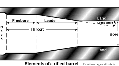

What is freebore? I can definitely feel resistance when trying to chamber a round.it looks like marks left from touching the rifling.
Freebore is the area of the chamber between where the neck ends and the rifling lands begin. Some match chambers have tight freebore diameters, like .0005” over bullet diameter. So even the slightest runout on the bullet will cause scraping and marks.
If you were hitting the lands you would need a hammer to bottom out that round.
The leade is the transition where the rifling lands start to ramp up from nothing to their full profile. The freebore is where all of that has been removed.
Where the bore is free of any rifling.
