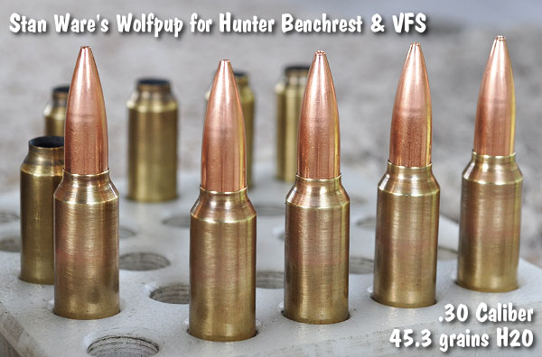

The wolfpup is a methodical benchrest and doesn't have a neck per se to avoid the problems described above. Seat as shallow as you want. Start a thread about about powder down in your chamber and magazine. Crying about nodes and warts. :)
