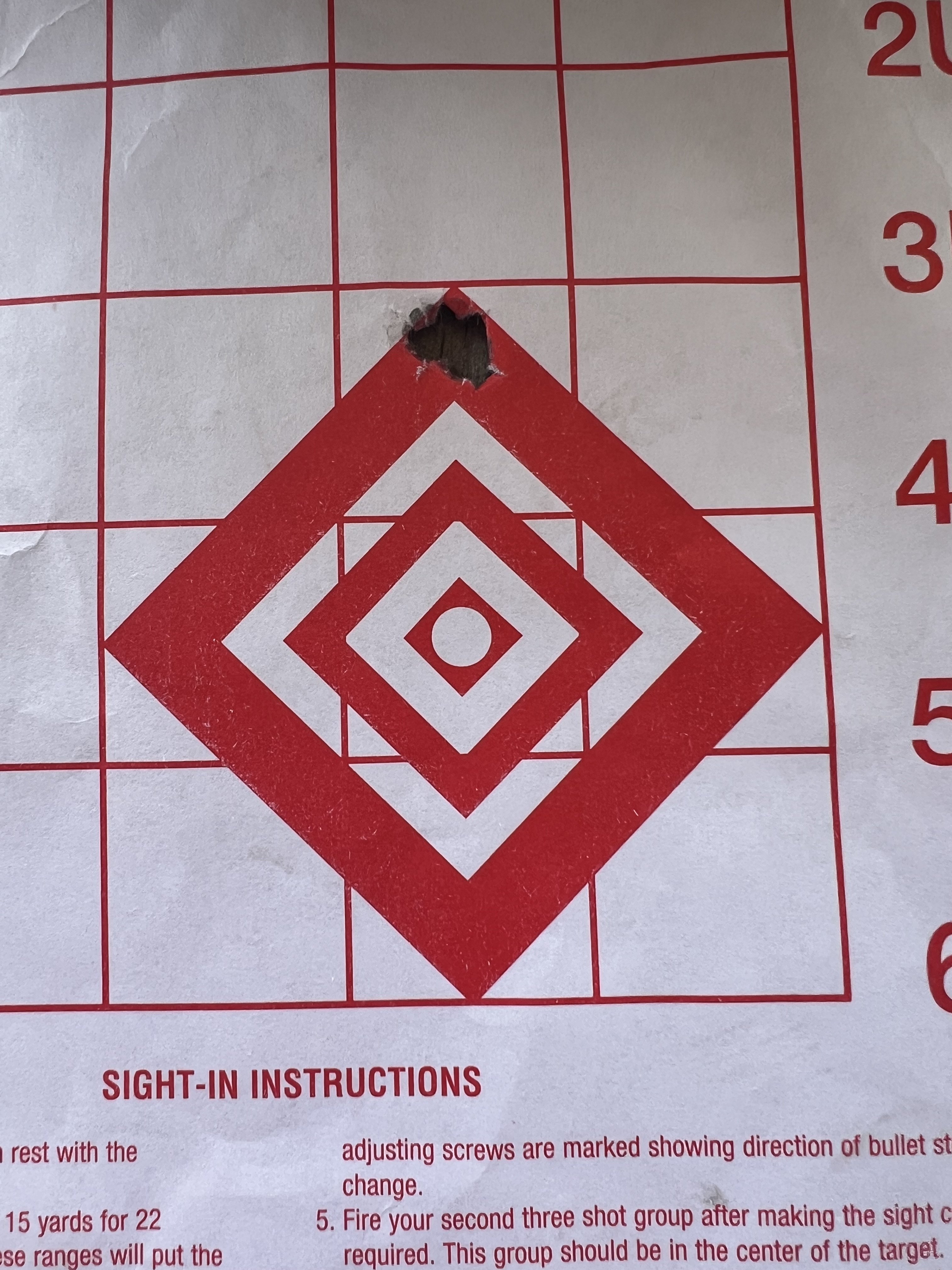

    This is a 3 shot confirmation group around .120 off the lands. COAL at 2.80 to fit binder mags with alpha brass and 140 hybrids out of a proof prefit.. FWIW.

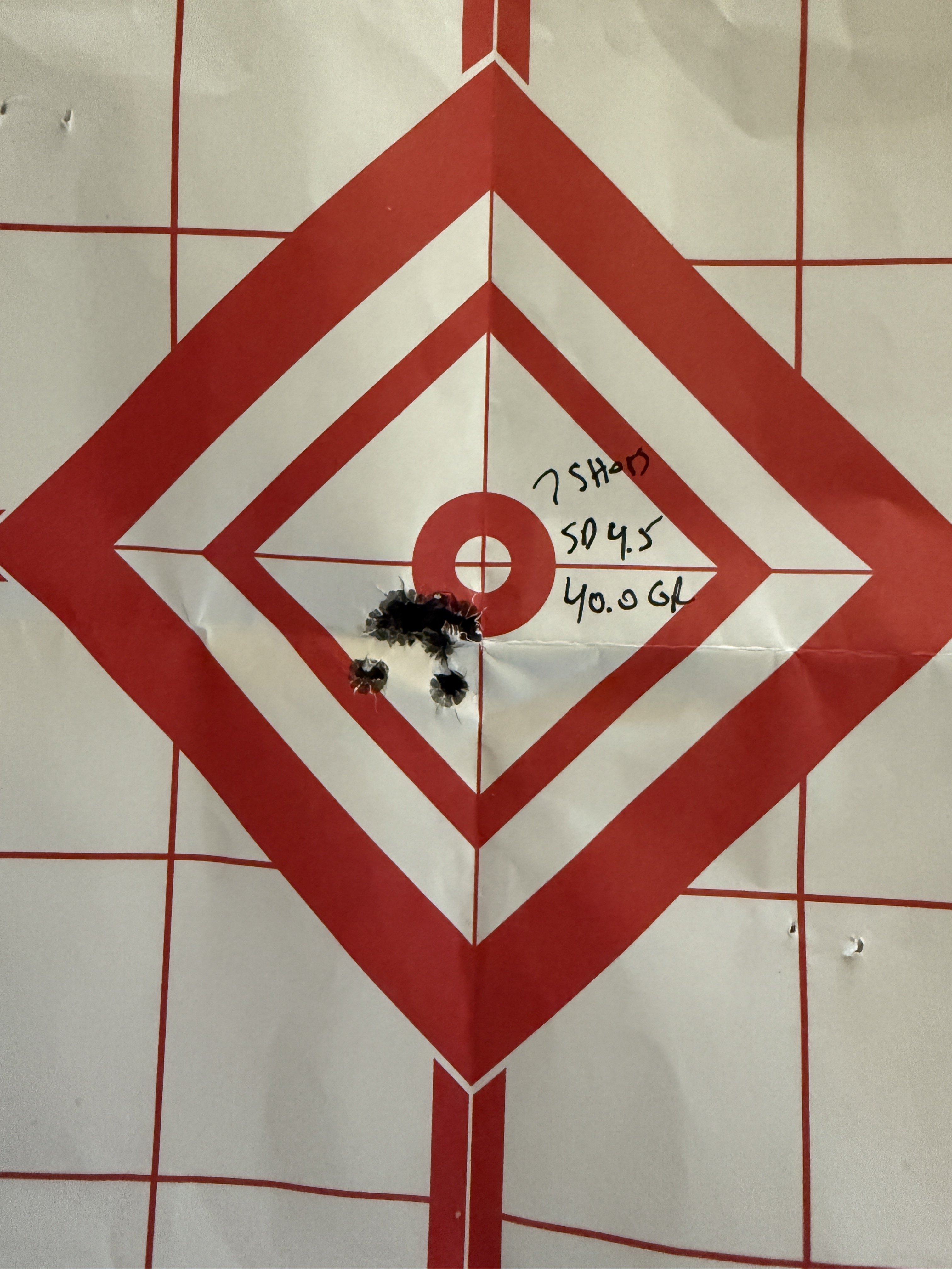

    That’s cuz it be seating depth not jump that matters.
    5 shot group of 40.5gr, H4350, average velocity of 2740, SD of 7.2 and a 7 shot group of 40.0gr using H4350, SD 4.5, average velocity of 2710. I think the bottom two lower shots out of the 7 were due to my shooting. The 40.5gr seems good to me and decent velocity, should I leave it alone at 40.5gr or try a little more? All the shots were using a suppressor, an Abel theorem-S. I have only been shooting with the Abel Theorem but didn't use it today.
    Brass was 1x fired Hornady from ELD Match factory ammo, 140G Berger hybrid target bullets. COAL was 2.894 for the 5 shot at 40.5gr and maybe a couple very slightly shorter with the 7 shot group at 40.0gr

    If you are happy with it, leave it alone and load up a bunch to confirm the load. But you still have room to go on the charge. Better brass can be loaded closer to 43grs and still will shoot. 41.3-42.7 is the sweet spot for the 140gr class of bullets with H4350.
