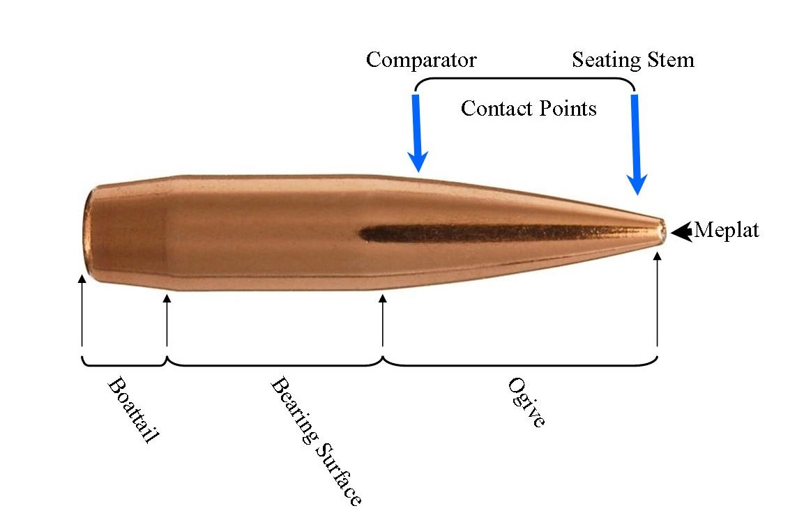

When we talk about "seating depth", we're talking about how for the base of the bullet goes into the case and if you could measure that, it'd be the distance from the base of the case to the base of the bullet. Right?
Therefore, I often found the issue to be the difference between where the comparator measures the BTO (contact point of the comparator) to where the contact point of the seating stem. To get real consistent "seating depths", I sort my bullets based on the measurement from the base of the bullet to the seating stem contact point using a comparator that touches the same contact point as my seating stem. When filling cases to where they're being compressed, getting that bullet base to the same place would be important, IMHO.
For some brands of bullets, there's not much variance between the normal comparator contact point and the seating stem contact point. For others, there can be a significant difference. And in either case, there can be a significant difference between lots.
As far as acceptable variance in seating depth, I don't like to see more than .001". Since it's not unusual to use .003" increments in seating depth as one is tuning a load, I wouldn't want that much variance in my seating depth, though just .003 doesn't necessarily make a significant difference.
Maybe I’m missing something, but how would bullet base to ogive make a difference when measuring the final rounds from give to case base?
Wouldn’t it make more sense if there was a bullet variation from where the seating stem contacts the bullets to the ogive?
That's essentially what is happening. It's faster and easier to use the bullet comparator to measure bullet base to ogive, but if you wanted to see the variation on ogive position relative to your seating stem. Disassemble the seating die, remove stem and use it as a comparator to measure the ogive position.
If you take a look at your bullet comparator insert, you'll probably notice the bore is basically a straight cylinder/concentric circle whereas your seating stem likely has a taper, radius, or angled geometry to better support the bullet during the seating process. This geometry on the seating stem and the profile of the ogive and its relative position is what changes the contact point of your seating stem on the ogive and gives you the variation.
Edit - Use bullet ogive variation as your baseline. Example - If you have 0.003" variation in bullet ogive position, but you have 0.005" variation in CBTO, something in your loading process contributed the extra 0.002".

That's essentially what is happening. It's faster and easier to use the bullet comparator to measure bullet base to ogive, but if you wanted to see the variation on ogive position relative to your seating stem. Disassemble the seating die, remove stem measure the ogive position.
If you take a look at your bullet comparator insert, you'll probably notice the bore is basically a straight cylinder whereas your seating stem likely has a taper, radius, or angled geometry to better support the bullet during the seating process. This geometry on the seating stem and the profile of the ogive is what changes the contact point of your seating stem on the ogive.
So I take it that these seating discrepancies are actually due to bullets that are not completely uniform to each other…. essentially in the region of the ogive to where the seating stem contacts the bullet.
With that said, aside from manually adjusting my micrometer seating die for every single round…. There’s not a whole lot you can do?
Yup. The realities of bullet manufacturing is that there will be variations. Some companies allow for higher variation and others have a narrower tolerance range.
